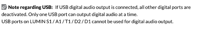

Lumin’s manual states that only one USB audio connection can be used at a time. Is the other USB connected to another DAC?
https://www.luminmusic.com/manual/cabling.html
But apart from this, I have no idea.

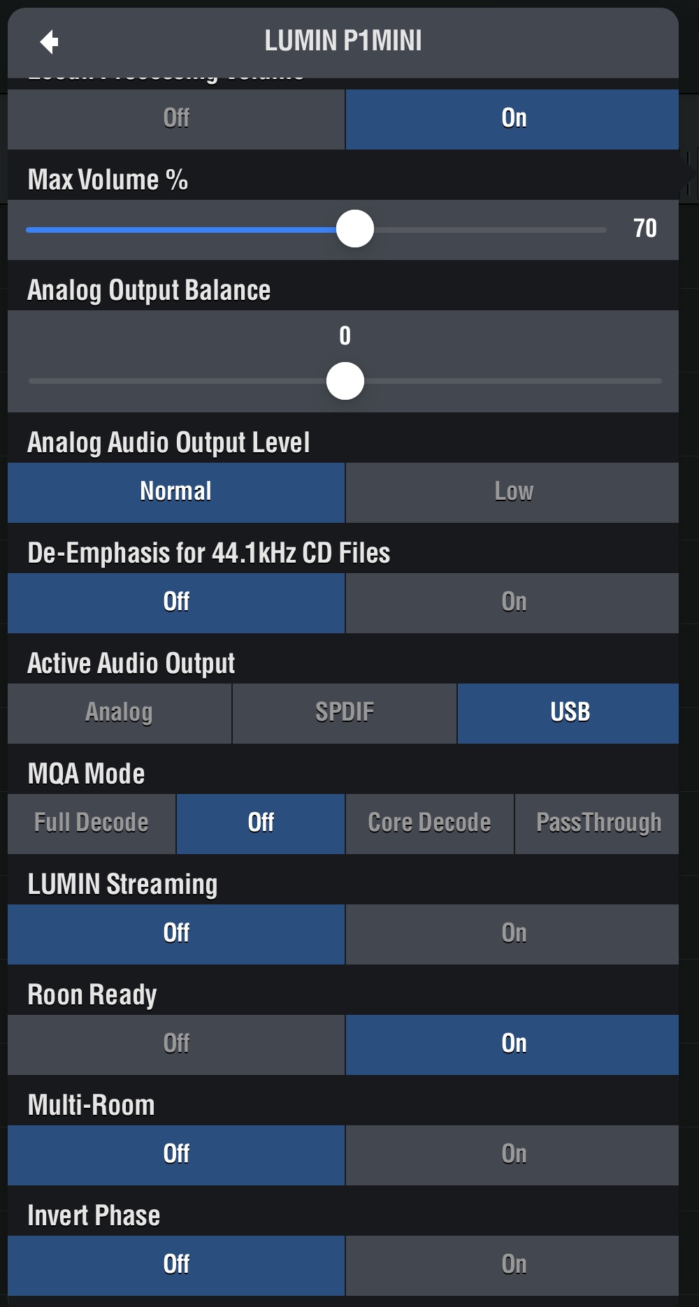

I had it working perfectly fine with my U2 mini so there should not be an issue in normal operation.
The screenshot shows my current settings (P1 Mini - Firmware 18.1). they should be the same for yours but you can check the online manual if you need to check.
Thank you all for the quick replies. I got it working, seems like a complete disconnect from power and reconnect was the trick - not just a power cycle.
