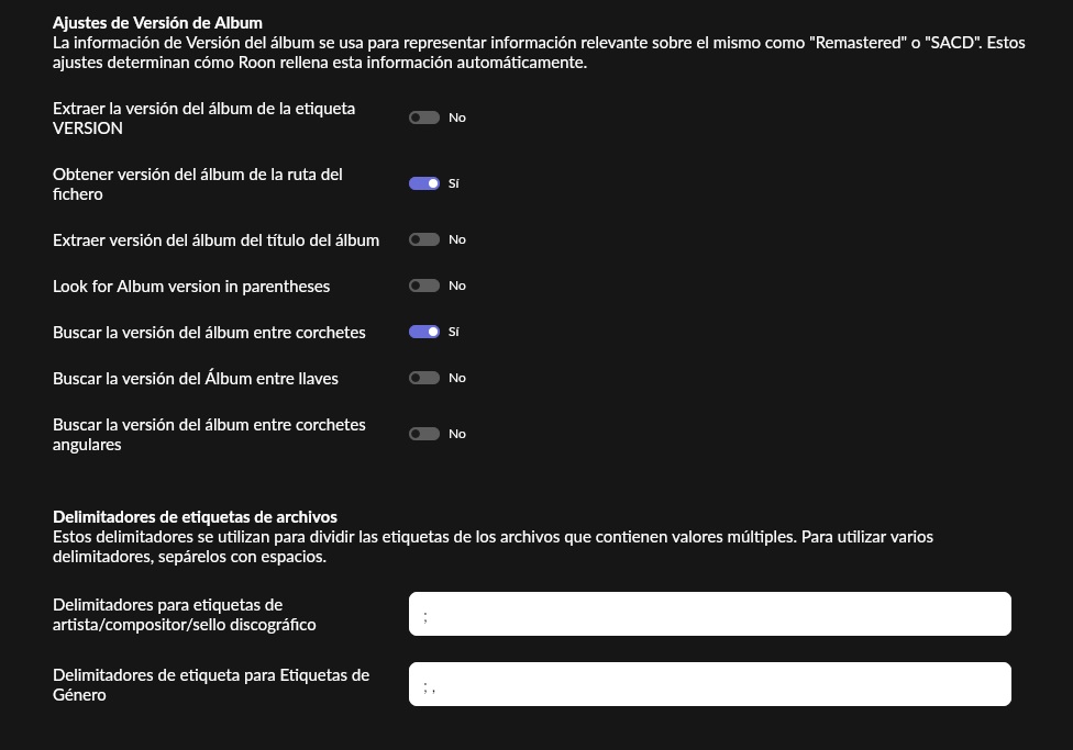

Screenshot of import settings

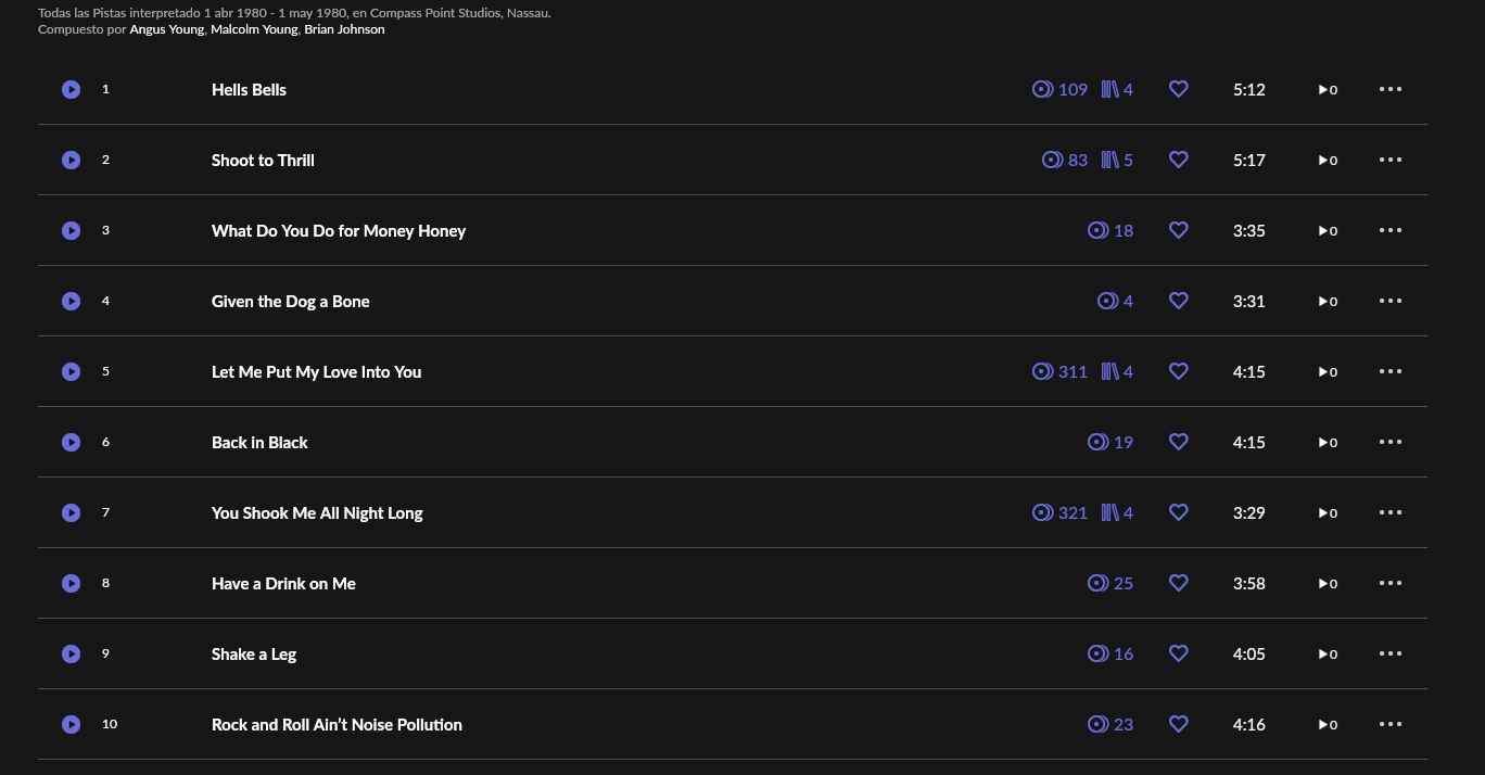

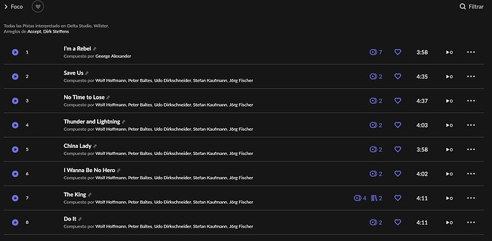

I also have Razors Edge WITH the work tag not showing lyrics or library counts

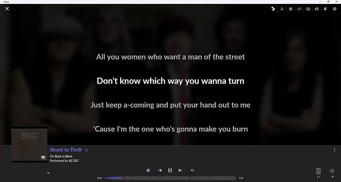

What I still don’t understand is why the lyrics are not showing in Roon on that particular release since on other local version and the Tidal version tI can see the synched lyrics.

I imported the files you shared earlier, and the lyrics loaded without any problems. Did you make any changes after uploading the album to our servers?

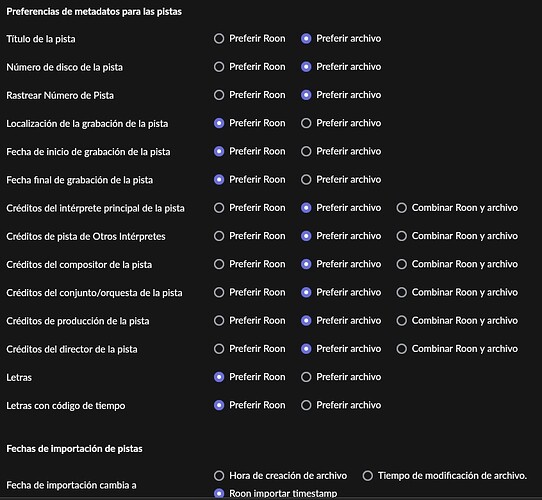

Checking the library import settings the only different things were:
These options are set to “prefer Roon”:
Track’s Recording start date
Track’s recording end date
Track’s production credits
Track’s conductor credits
and
Use REPLAYGAIN_ tag when present is OFF
the rest is the same.

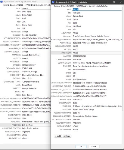

Just to be clear, and because this may be helpful for you, I DON’T have WORK tags on my files.
I did, but the library count was missing and when I deleted it the library count showed up again, so I made a script in Picard to delete any Work related tag.
Nevertheles there were some releases WITH the work tag that showed both lyrics and library count, that’s why I said the problem was inconsistent.

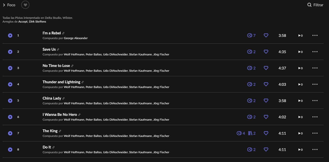

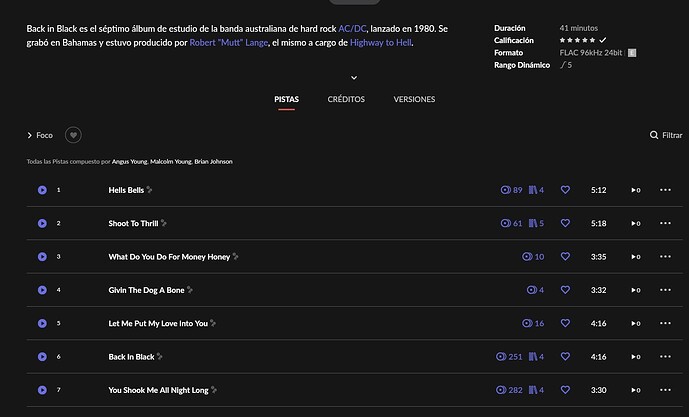

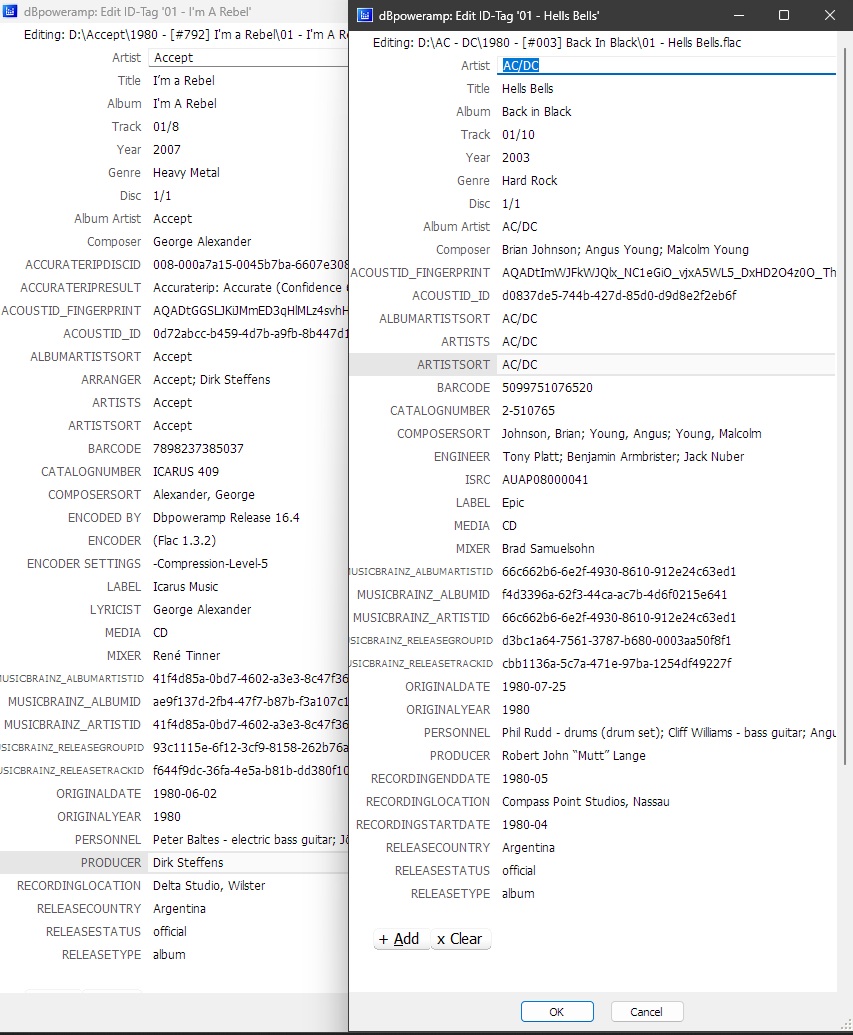

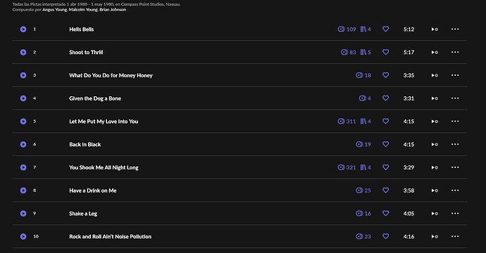

These are two files I updated using Picard and MP3Tag, almost the same fields, (no WORK tags) depending on the available information in Musicbrainz:
Here’s Back In Black:
and here’s I’m a Rebel:
one has lyrics, the other doesn’t
