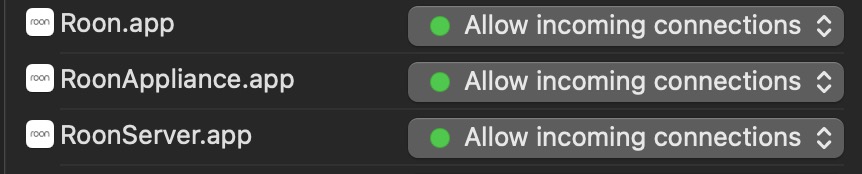

Have you checked the firewall on the Mac?
What would I be looking for?
I keep reiterating that the system worked fine with the previous version of the program.
If you’re running MacOS 13, go to System ‘Settings → Network → Firewall → Options’ and check that Roon (and RoonAppliance if it’s running) are set to “Allow incoming connections”.
You do, but that doesn’t preclude the fact that something else might have changed other than the move from 1.8 to 2.0, e.g. your firewall settings. That said, it might not help at all, but it’s something worth checking.

The firewall is not on.
