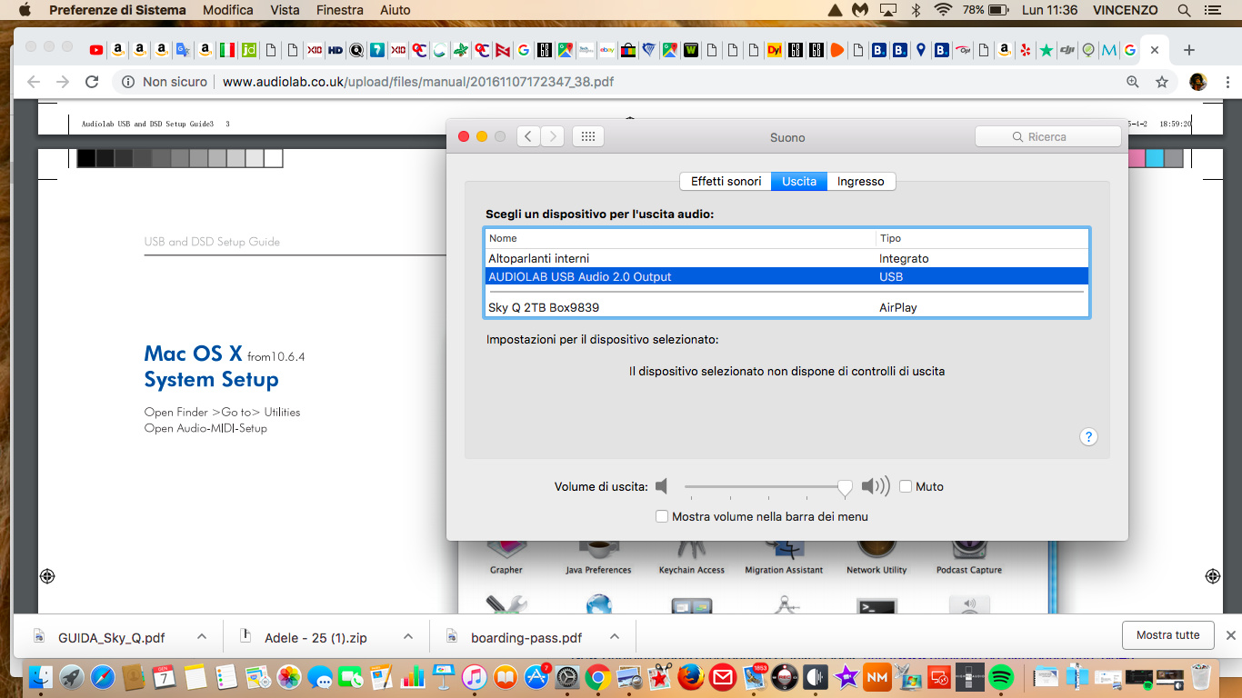

sorry but I did not understand, when I connect USB cable from my Mac to the DAC, from the audio properties I see that audiolab was found,
I contacted audiolab support, they asked me to check the setup out of Ronn (already done) and the properties of the USB port (I checked but I have no possibility of setting)

In Roon go to settings then audio and post an image of that screen.

The image you posted was the device setup not the settings, audio tab, I suspect you are currently using the ‘system output’ not the usb dac connected to your pc.
As has been said you need to go into settings then audio and ensure the Audiolab dac is enabled and then select it as your zone.
I’m sure to use the USB output of the Mac connected to the DAC,
if I disconnect USB cable the display of the DAC shows Unlocked (no sound) and in the window of sound of the Mac you no longer see AUDIOLAB USB audio out
in fact, when I set 384 kHz from the sound card settings, 384 kHz appeared on the DAC display
