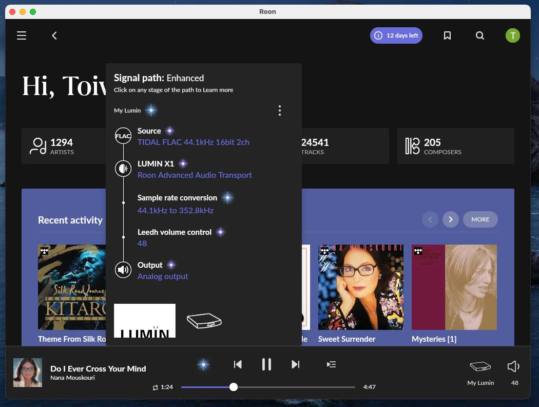

After installing Roon Core the Mac Mini started to crash regularly, 3 – 4 times per day. Before installing Roon I used the Mac Mini to break in my new components and let it run continuously 2 weeks 24/7 without single problem. During two months use before Roon it never crashed. I have the latest Mac Mini M2, two months old. I use it only for Roon core, headless, without keyboard and mouse. All updates are cancelled, sleep function is cancelled. Installed are just Minimserver (that is not running when I use Roon, it is passive), Team Viewer and VNC Viewer to accesses from Windows PC. I have only one zone, Roon end point is Lumin X1. Roon is installed in Applications folder and there is only one Roon app present. Before crashing everything is working in 100%. Music simply stops on half of word, tablet’s app tells: “Uh oh, something’s not right. Make sure your Roon Core is turned on and ……”
