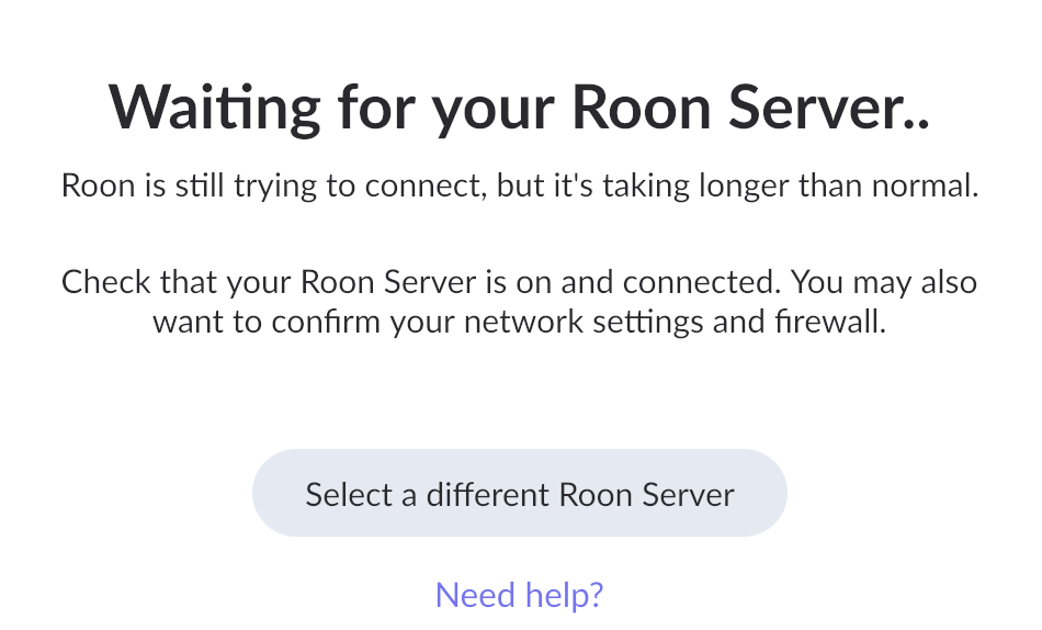

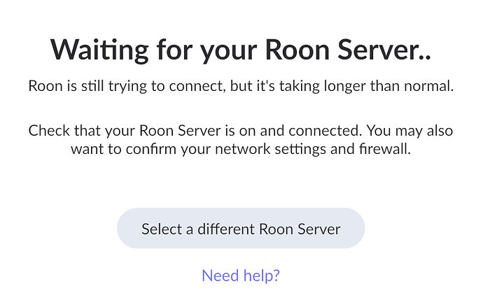

Is Roon Server running?
· "Waiting for your Roon Server"
What happens if you press the "Select a different Roon Server" button?
· I don't see Roon Server.

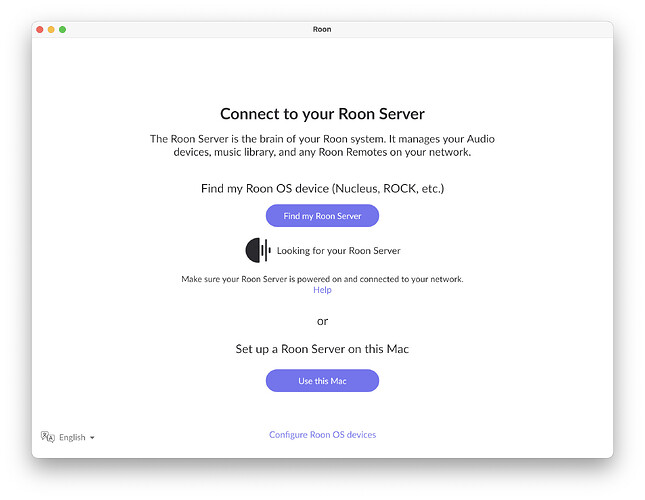

The Roon Remote app on my MacBook Air stopped connecting to Nucleus. The iPhone & iPad on the same WiFi connect and work fine.
I've tried the troubleshooting and reinstalled Roon app on my MacBook Air, but it still cannot "see" the Nucleus (Roon Server).
It has been working fine until I updated MacOS and restarted my laptop 2 days ago.
I have the Cable modem provided by Breezeline (USA), a Google WiFi router and the Nucleus & Synology (where music files are stored) are connected by ethernet to a NetGear switch
I can connect to the Synology from my MacBook Air and browser the music folder. I can see the Nucleus by going to http://nucleus in a browser on the MacBook Air.
Roon is also allowed to “find and communicate with devices on my local network” under the Privacy & Security setting on the MacBook Air.
I do not have the Apple Firewall turned on.
Currently running macOS Sequoia 15.2 (24C101)

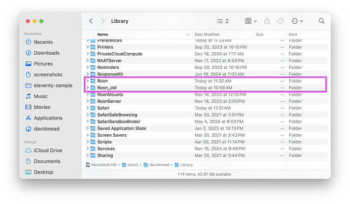

Can you please try to reinstall Roon on your Macbook?
Let’s try a fresh database and see if your issues persist:
  • Exit out of Roon on the Mac
  • Find the folder that says “Roon”
  • Rename “Roon” to “Roon_old”
  • Verify if the issue persists
Here is the process outlined from a macOS machine:
roonoldmac

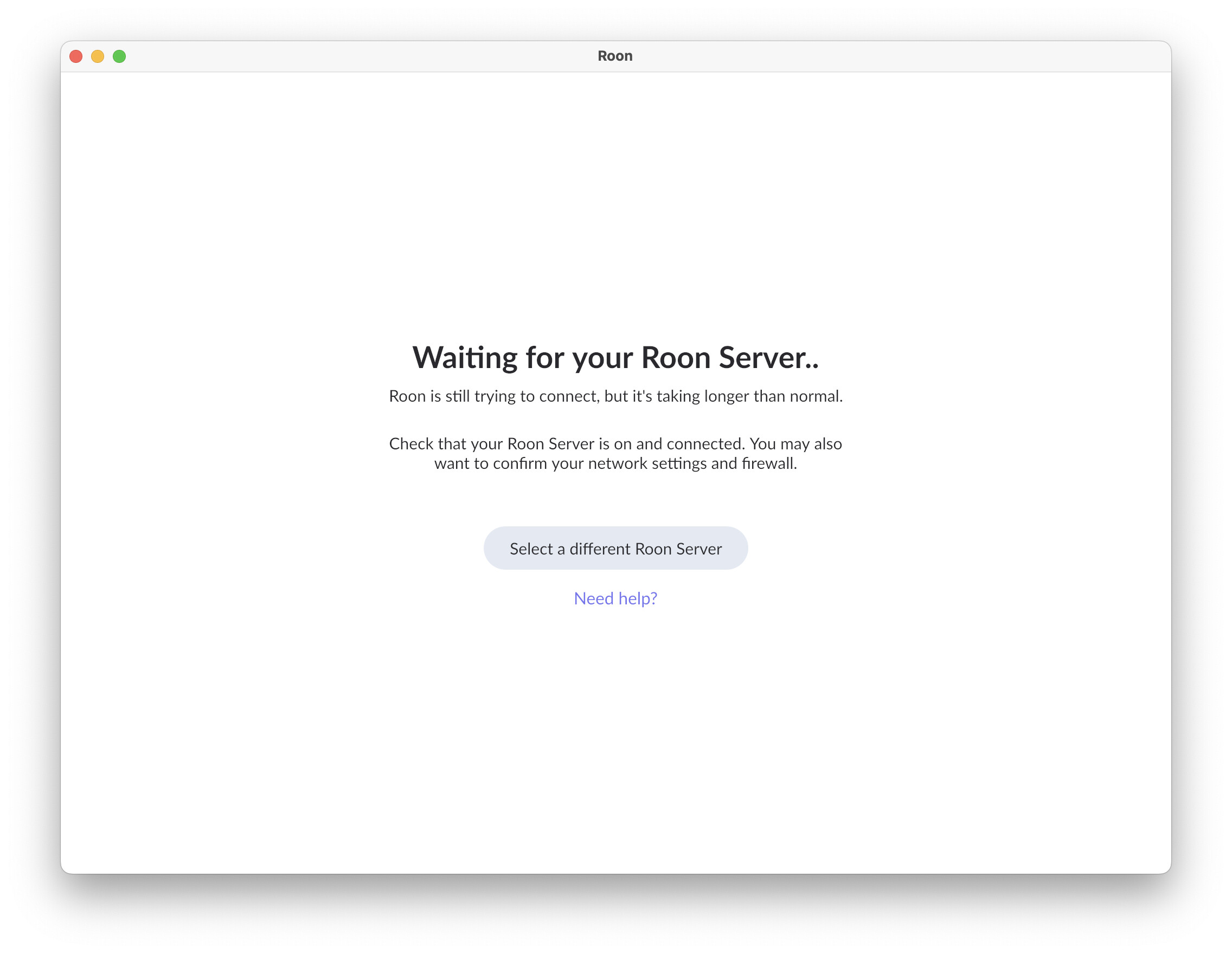

Hi @noris.
As stated in my original ticket I did follow those steps originally, but still ran into the issue.

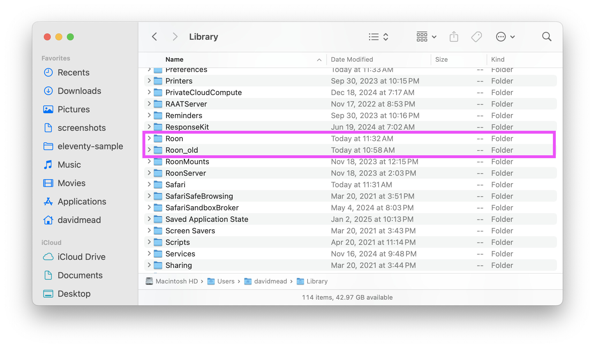

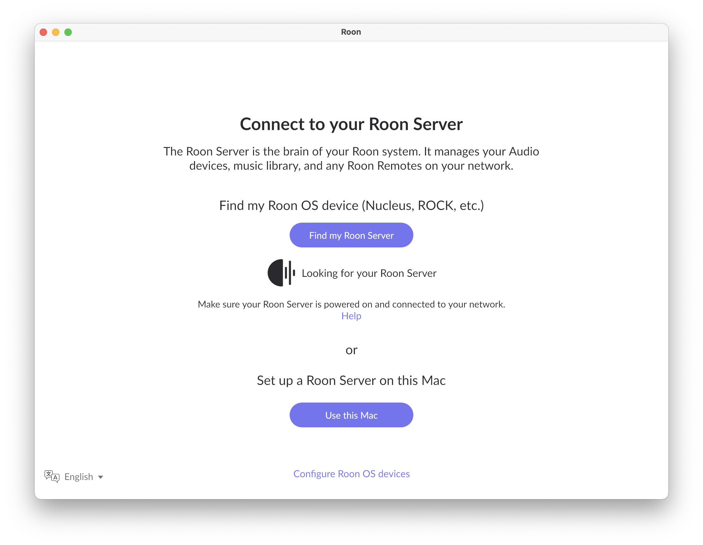

I followed the steps you outlined this morning. Once again the Roon install cannot find the Nucleus.
You can also see I renamed the Roon folder, in Libraries, and the new one is present.
Any help would be appreciated.

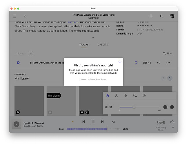

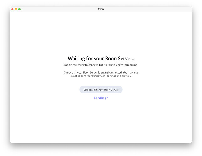

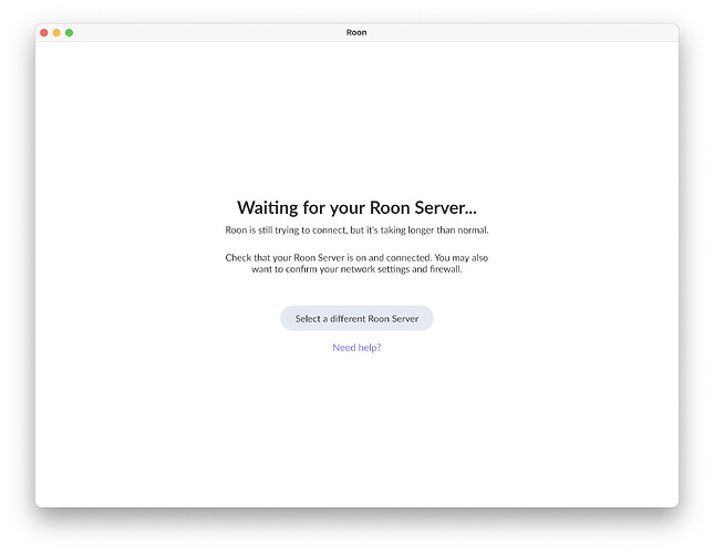

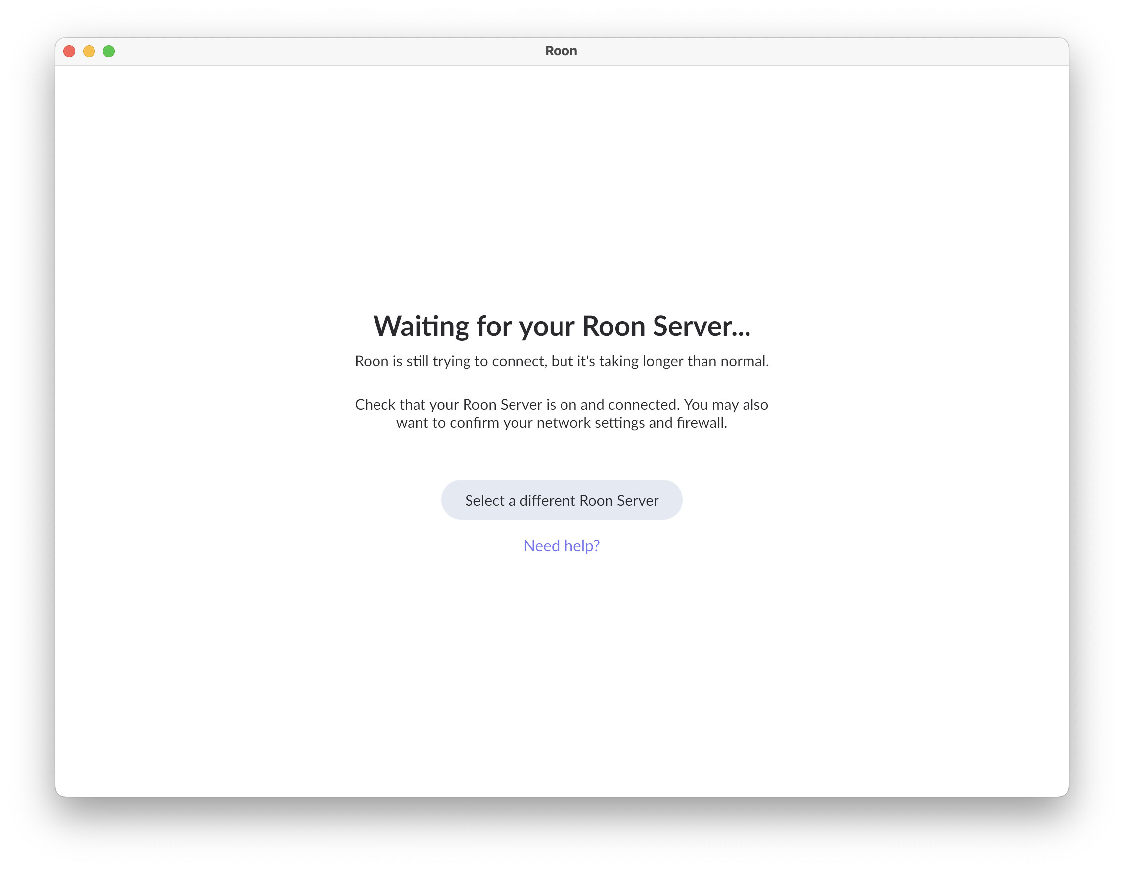

I am now running MacOS 15.3. I did make that change in the settings and while Roon does launch most times I still get the occasional “uh-oh somethings not right” and “waiting for your Roon server”.
Can also confirm “select a different” nothing shows up.
These screenshots were taken on Jan 31st 2025.
