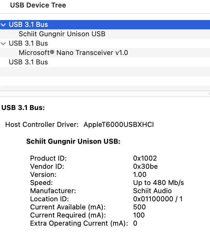

  1. Yes, it does appear.
  2. I am unable to provide a full answer, as Roon doesn’t recognize the USB DAC in either port. The computer, however, does. The proof:
  3. Obviously the USB-C ports are working. However, I can’t play music with Roon thru the DAC. What’s Next?

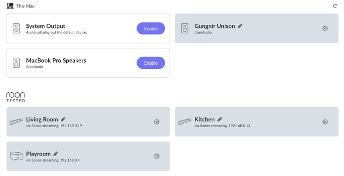

We, powered down and up, and Roon said No Audio Devices, then it let me “enable” the USB Unison Schiit. It is now playing music. Why?
Screen shot of the MIDI -
There is something weird going on with Roon. This shouldn’t be so difficult.
Let me know what other stuff y’all need to fix it.

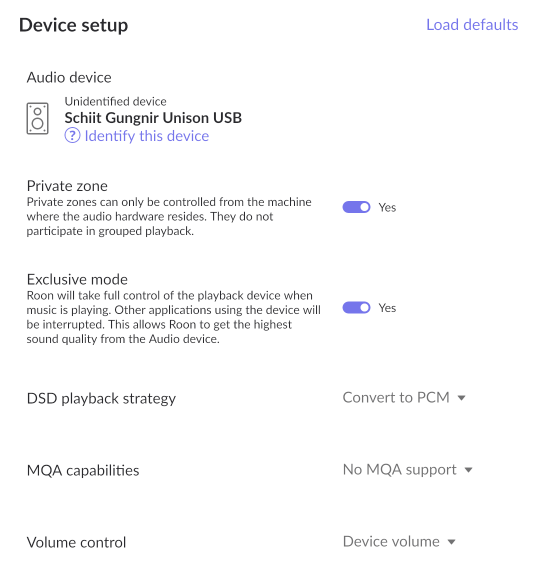

At the final move, Roon had disabled all sound zones including the Mac speakers, core audio, and three Sonos zones. It saw the USB Unison, too, and let me enable it. What’s playing now. Roon, on its own, also re-enabled the Sonos zones. I didn’t do that. Here’s the Sound picture now.

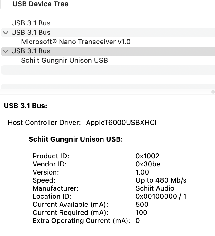

Screen shot of MIDI while playing 16/44.1 music.
Today I was able to play music thru the “affected” USB-C output, by manually enabling the DAC plugged in there. It would not start 16/44.1 music. I had to start with 24/96, then it played and I switched back to 16/44.1. It is working but manually. Does Roon no longer automatically sense connected USB DACs and enable them? That seems to be the case, to me. Two screen shots are attached. I would like some comments from your side now.
