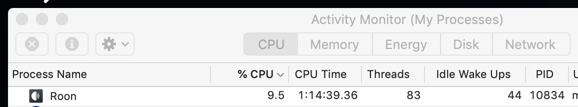

Macbook Pro 13.3 quad core. Since updating MacOs to 10.15.4 on release date 03/24 Roon runs at 350% and turns on all fans etc. This is only a remote, not the Core.
Pretty much means that I cant run Roon on Macbook at this point.
Anyone else seeing this with new MacOS ?

Is there any change in behavior if you try toggling your WiFi adapter on the Macbook off/on (even if you’re using Ethernet for it)?
Noris - Yes, thank you, that worked. So, if I reboot and have never had wifi on (ethernet only), Roon takes up 350%, once wifi has been toggled on off it behaves normally (negligible cycles) Small bug ? but easy fix, Thank You.
Hi @Brett_Hedges1,
Glad to hear that toggling the WiFi resolves this behavior. We have an active investigation as to why this behavior occurs but in the meantime you can use this WiFi toggle procedure to get out of this state.
