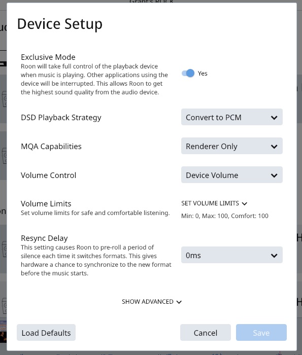

Here are 4 screen grabs:
  1. setup/audio main screen
  2. USB DAC setup 1 of 2
  3. USB DAC setup 2 of 2
  4. Sound control panel
(Oy! Mac grabs in tiff; your site won;t accept tiff, off to the converter i go).
Note that the upsampling is set to max.
On DAC the indicator for sampling rate remains at 44k
USB connection is via core audio with MacOS manipulation in the signal chain.
using the other machine:
  1. USB High res Audio showed up in sound menubar
  2. USB High res audio showed up as a direct option to be enabled
  3. clearly received up sampled data and indicated such
Adding one more nugget. As you see, it allows “device volume”. This is a siumpel R2R DAC and does not HAVE device volume, so as far as Roon appears to know, the “device” is the Mac Core Audio. This is, i think, the fundamental problem.

Hi @Just_Me,
Thanks for the screenshots!
It looks like you have an MBP2009_USB zone in this list, is this not your DAC?
Have you also configured Roon to perform the upsampling in the DSP Engine for you? I see you have it set to 768kHz in the Device Setup, but you might not have DSP turned on:
  1. My DAC is the Denefrips via USB Both are CA.
  2. I have DSP on and active for other DACs. It was active for THIS DAC before the macbook pro swap. I changed nothing. It doesn’t change itself does it? In any event its still upsampling to my other DAC
Not sure if this is everything you need. But before, the Denefrips shows up as “USB High Res Audio”. I was receiving an upsampled stream (varied according to indicator lights), and device volume was grayed out.
Now it only shows up via Core Audio, and there is device volume (which does not exist) so i can only conclude Roon sees the Mac, not the DAC.
