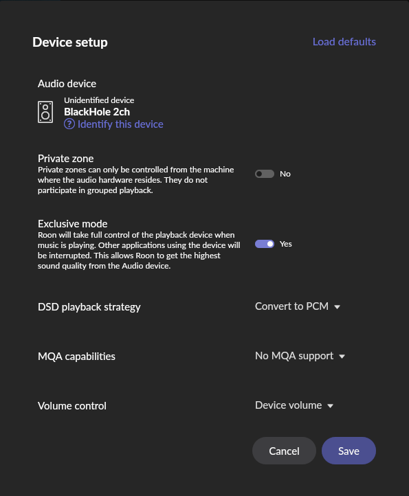

Mac OS has to free the dac for roon, so that is why jumps to the build in output. It does that if in roon setting the dac is used in Exclusive Mode. If that would not happen you would get your e-mail notifications sound over the music playing from roon. 100% I would leave the Dac on exclusive mode.
If the Ayre is in exclusive mode the Mac mini does not touch the stream. But just to be sure provide the signal path

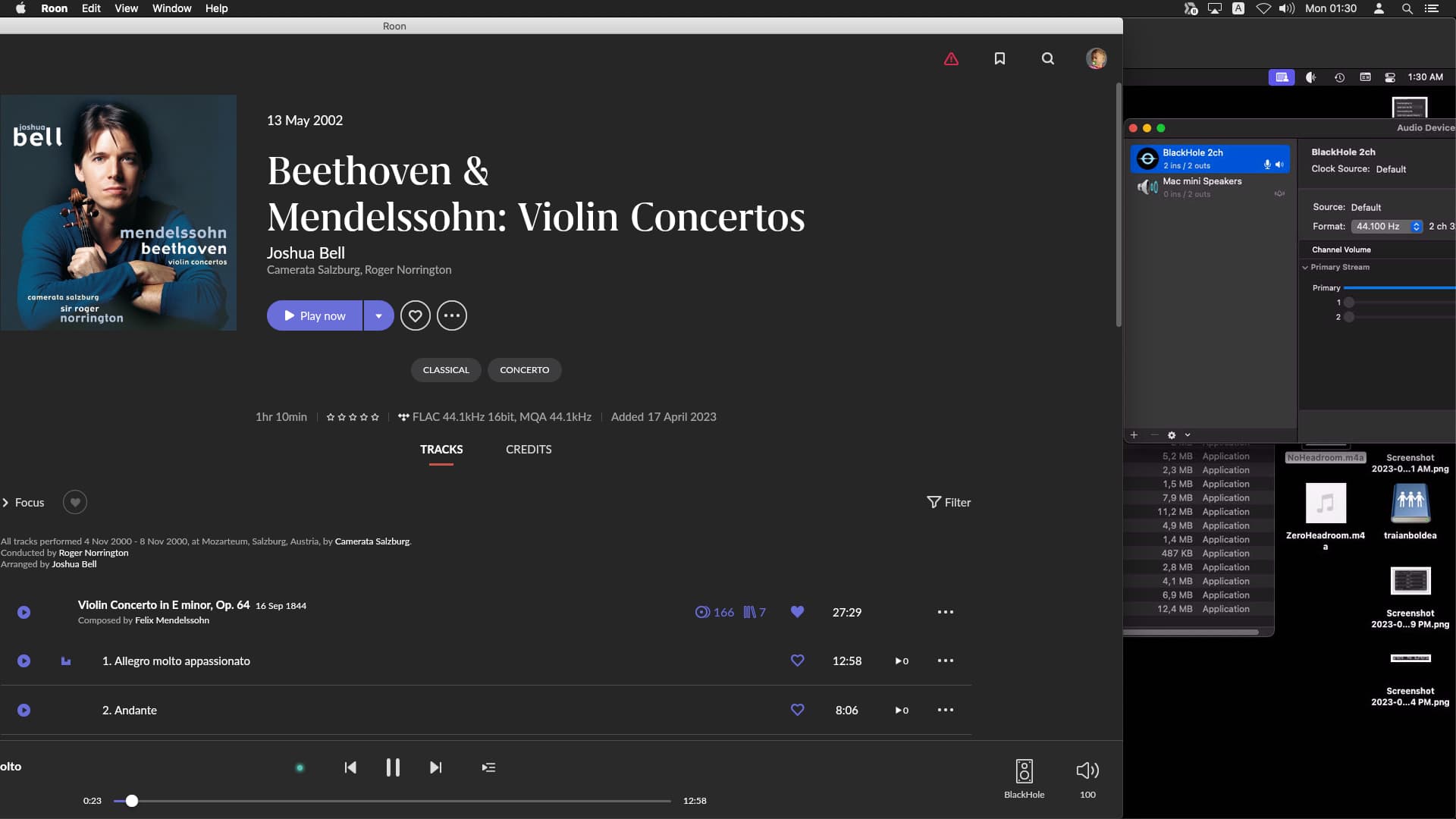

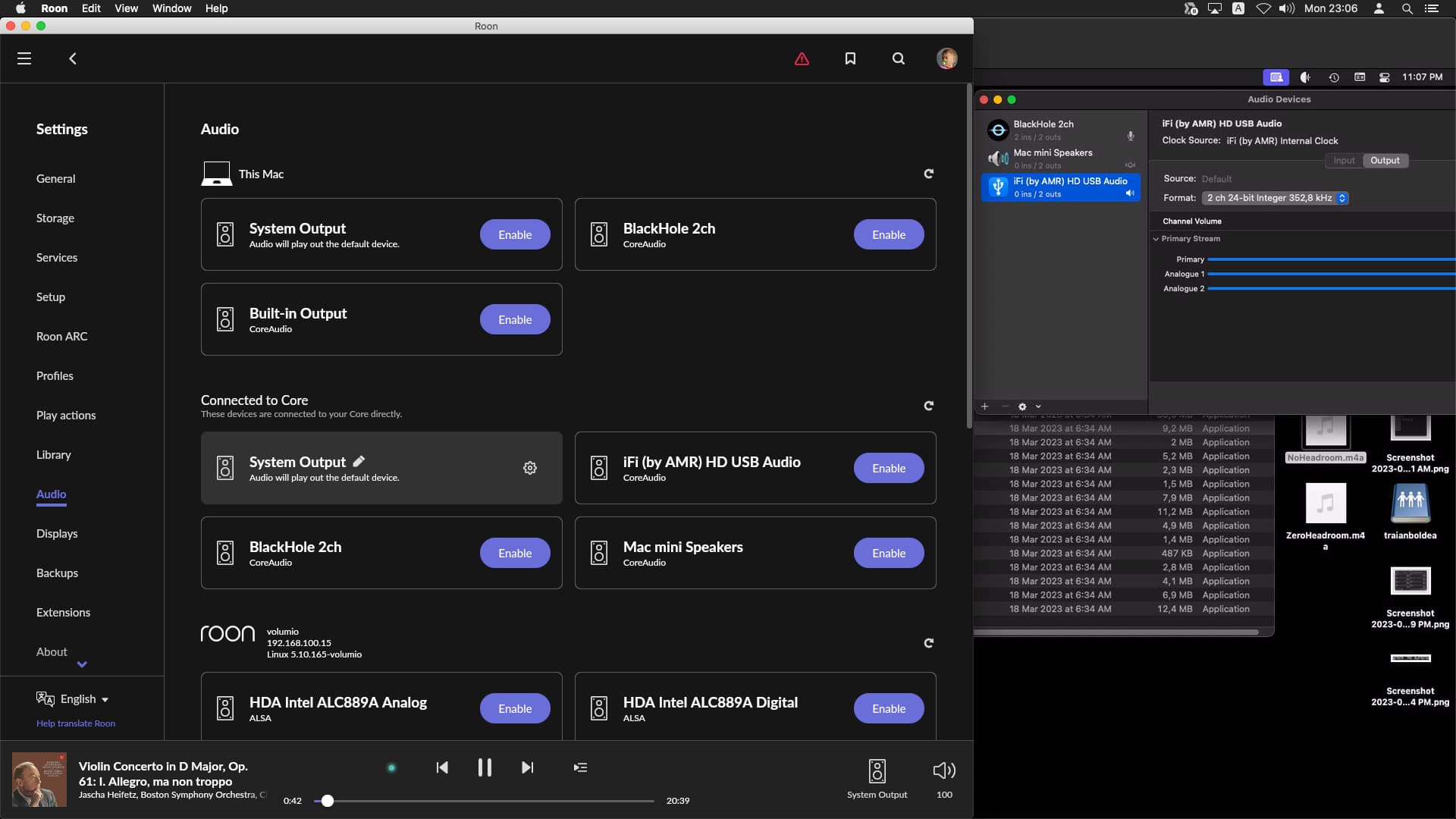

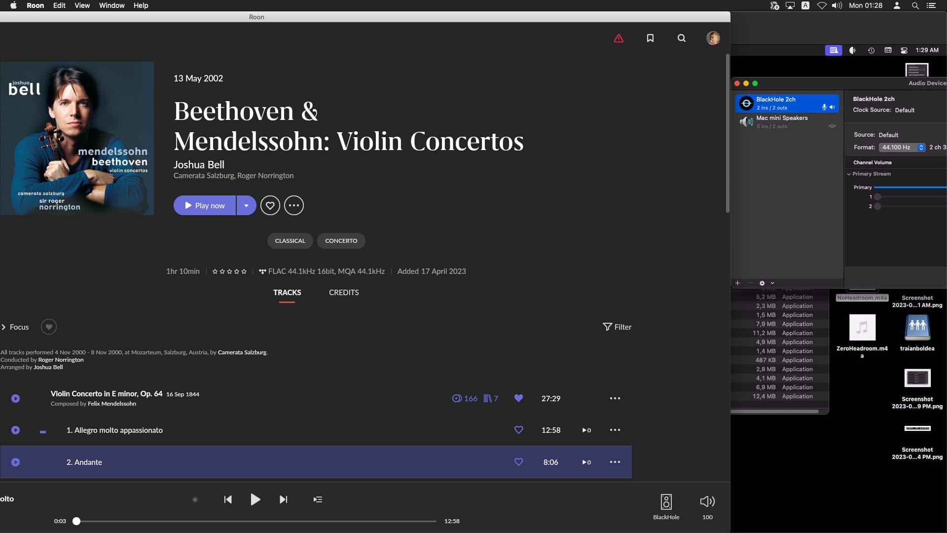

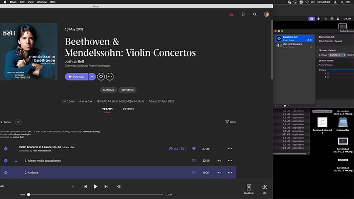

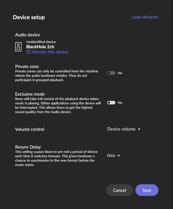

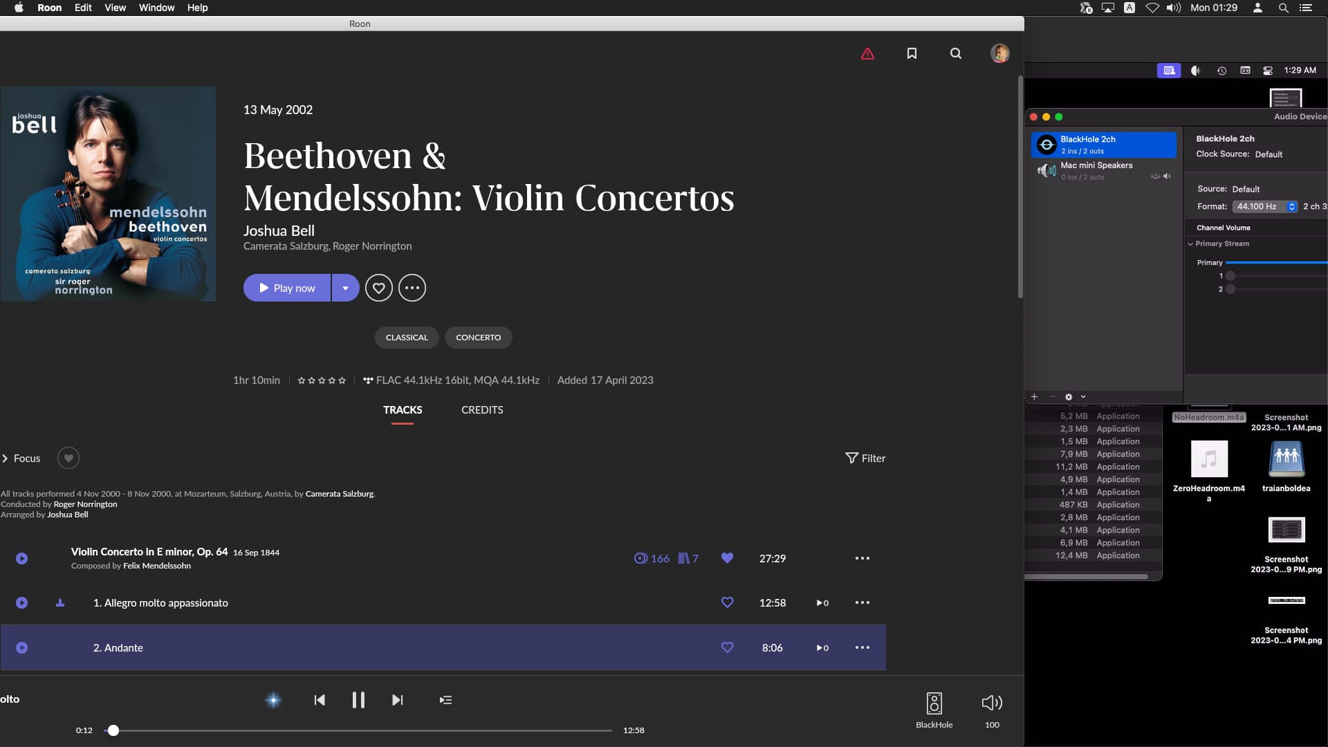

Made some screen shots (kind of messy because of the screen sharing used to access my mini)
exclusive mode selected
Mini audio midi settings without roon playing
Mini audio midi settings with roon playing
exclusive mode not selected
Roon playing and the audio midi settings speaker does not jump
Now I’m noticing for the first time if your dac is not on exclusive mode the signal path dot is green
Thank you all for responding, it has been most helpful. Traian, if I followed your screenshots correctly, the speaker symbol is on the “Mac mini speakers” when Roon is playing in exclusive mode. I too have mine on exclusive mode and the speaker symbol is on the same output as yours. That leads me to believe that I have mine set correctly and should leave it alone. Assuming I interpreted your post correctly, I believe that answers my question. I just thought the speaker symbol would be beside my Ayre dac when using Roon in exclusive mode. Guess I was wrong. Thanks again.
You are welcome. Yes I can see why you were expecting to see the speaker by the Ayre when playing. It is not very intuitive.
Yes you did interpret my post correctly.

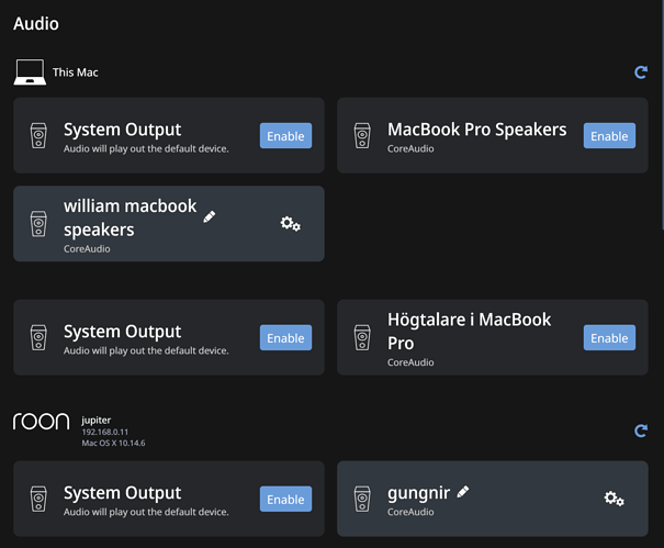

IIRC, it depends on which interface is enabled in Settings > Audio. (I no longer have a Mac, so can’t confirm, but I think there’s System Output and Core Audio.)
Yes, always found that default
I think all of them are CoreAudio, that is the driver name like ALSA. System output can be routed to any audio card (Dac) but when Roon (or another app, Tidal for example) does request the Dac the system should know and free the Dac for the app that is using it. I think in Ventura 13.0 there was a bug where Mac OS would not free the dac for roon and roon on stop would not free the dac for system. You had to reboot the dac every time you wanted to play one way after another.
Unless things have changed in the past few months, macOS has System Output and CoreAudio devices.
If System Audio is enabled, and a DAC is connected, audio will be heard through the DAC, but it isn’t exclusive mode, and the signal path goes through the OS mixer.
Nothing changed, it was my impression that system output just uses the audio card selected on the system settings of the os. So same CoreAudio Driver but just is named System Output
