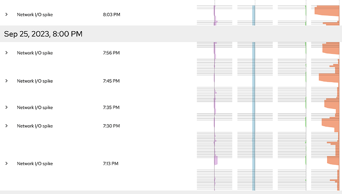

There’s am issue with Qobuz>Roon>endpoints over wireless: Roon downloads the coming track in a burst from Qobuz, saturating wireless and causing packet losses and retransmits on whatever track is playing from Roon to a wireless endpoint. My other systems are all wired, but the one I’m using currently has the Roon server wired to the router, and all endpoint wireless, over AmpliFi mesh. It works well, but I doubt it would given the network spike graph below while playing from Qobuz if the router>Roon server connection were wireless. It’s really worth investigating whether you could connect your M2 directly to the router.

That sounds very much like the problem. The M2 is however wired to the router.
