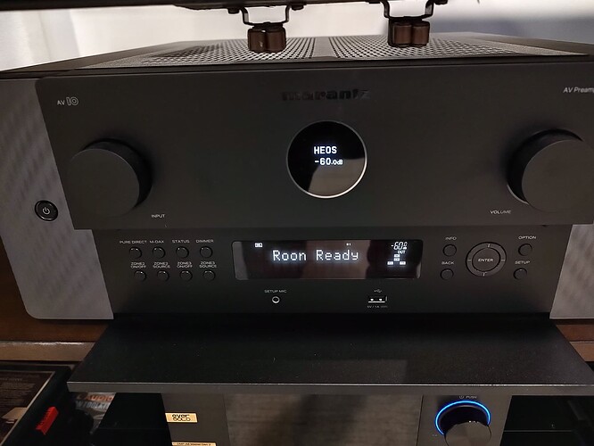

I’d also be interested in what is shown on the two displays when playing from ROON - I’m working on this for RHEOS but there are a lot of different variants to Denon and Marantz displays.

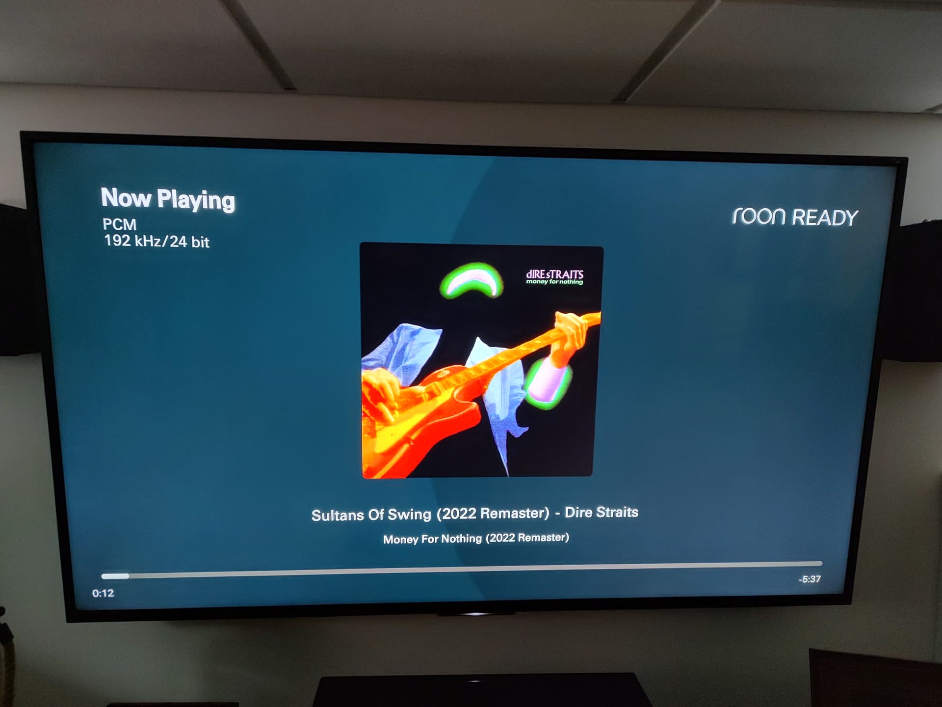

Here’s what it displays.
Is bottom display changes to track title / artist, when status button pressed once and to album title when pressed twice.
Also is there / (forward slash) before artist which trims artist line by one character.
I’ve emailed Denon support some time ago, asking to remove it but they refused to do it so.

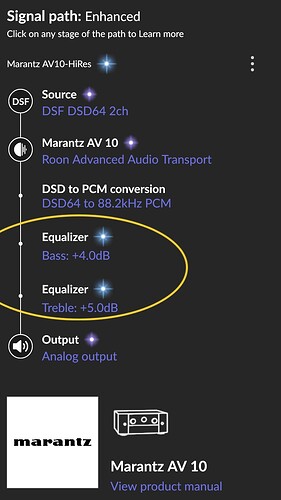

Happy to see this finally. Is this normal for the AV10 to convert DSD to PCM?
Under Device Setup there is no DSD Playback Strategy to select DSD Native?

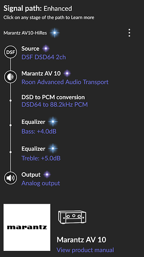

Todd, would you mind playing a DSD64/DSF file and share the signal path?
Thanks

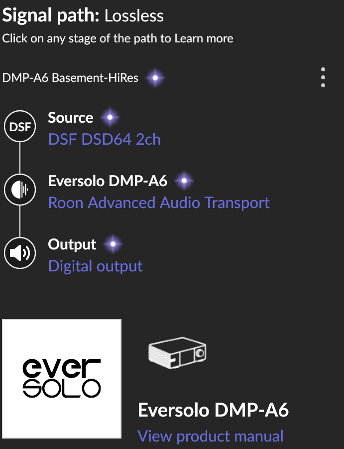

Govnah,

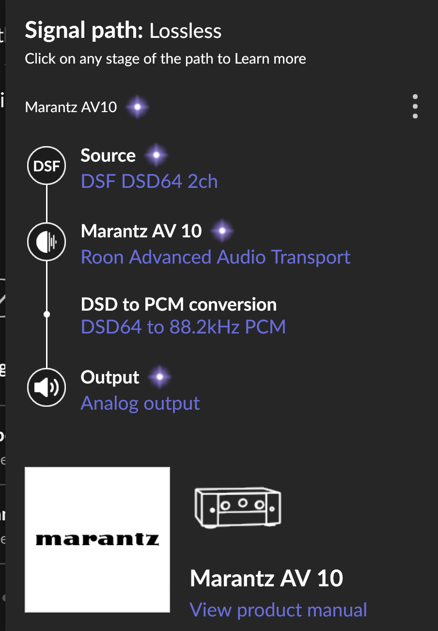

If I stream to the Eversolo and then to the AV10 via HDMI I get this:

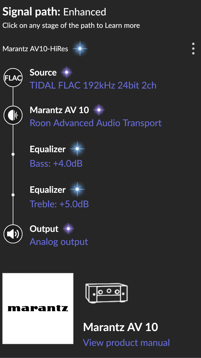

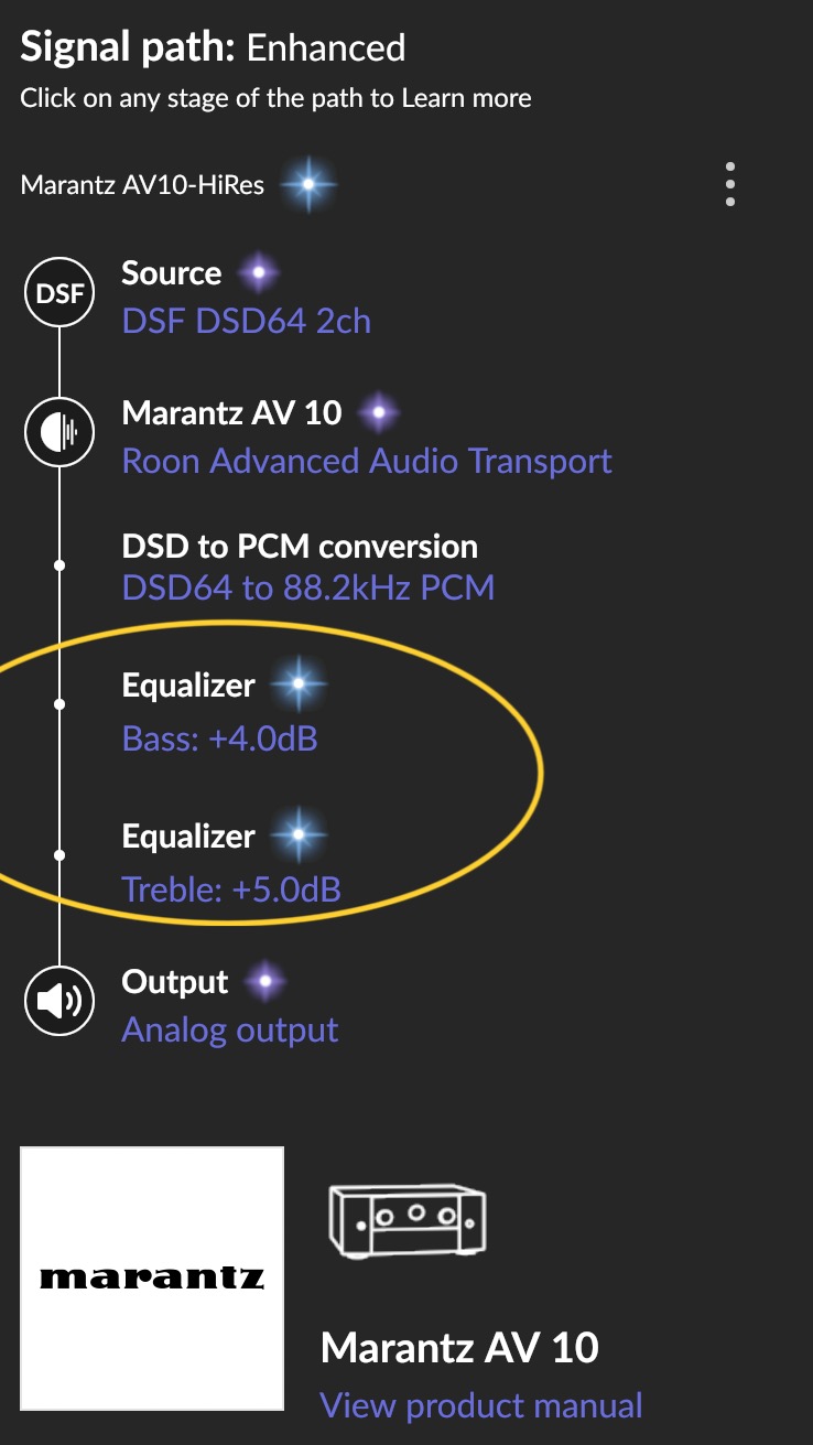

Thanks Todd, I have an Eversolo as well and that is correct. I am curious if you stream from ROON directly to the AV10 what the Signal Path looks like via DSD64/DSf.
Thanks
I posted that path above. It coverts it to pcm. I’m thinking the AV10 through Roon can only do HiRes non DSD and no multi channel
I think what is happening is that the AV10 is doing signal processing of the inbound signal, that shows up to Roon as the bass and midrange boost in your image. DSP can only be done with PCM. DSD doesn’t allow any signal processing, which is why most music is recorded in PCM and then upsampled to DSD after all of the edits have been done in the DAW. The Eversolo is DSD capable, so that’s all Roon can see. It doesn’t know that Eversolo is then passing that signal to the AV10 or what the AV10 is doing with it. Roon only sees the RAAT endpoint. I assume the Eversolo is outputting an analog signal to the AV10, which may then be getting sampled to PCM so it can use the DSP for the same bass and midrange boost.
The use of EQ in the Marantz may be why it’s being converted to PCM.
Yup I see it now, Thanks! I am not applying any DSP and you may be correct…
