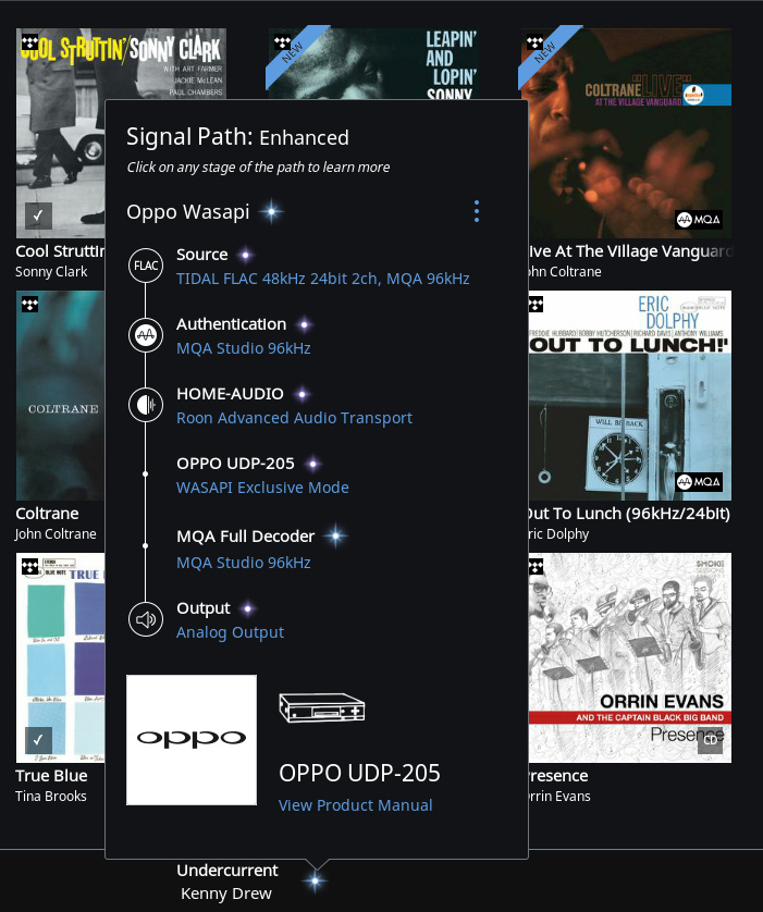

Using ASIO driver
Using WASAPI driver

WASAPI
Yeh that’s WASAPI (which is working fine for you with MQA).
What about the ASIO settings? Are the MQA settings the same?
ASIO
I do notice a slight difference in sound when using ASIO and I think it’s better in ASIO but just a small purple dot and no big bright blue dot…if that means anything

Thanks for posting those. From those screenshots it appears that MQA content is working as expected and reaching the Oppo just fine. The reason why you are not seeing the “MQA Full Decoder” stage when using ASIO is because as previously mentioned, the Oppo UDP-205 does not have HID support on ASIO (as in it can’t report the unfolding in the same way that it reports for WASAPI). Since the decoding & rendering happens internally on the Oppo that path is expected.

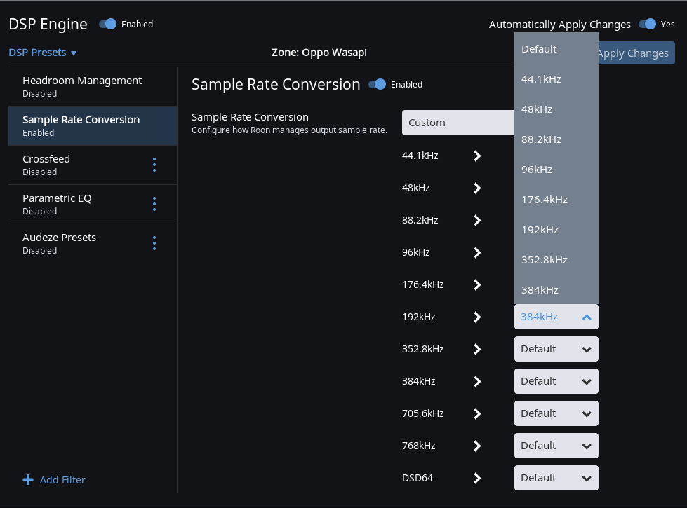

Ok the 768Khz is when using WASAPI as my driver and setting the max PCM to 768Khz in the device setting and then trying to use the Roon DSP and up-sample the max setting 384Khz and not 768Khz. Is this normal?
If you use the ASIO driver does the drop down stop at 384?
No, it will go to 768Khz or DSD512 with ASIO
Hello @Benjamin_Gold,
When we took a look at this device in the lab, the limit for the WASAPI driver was 192kHz so that is likely why you are not seeing that option listed. I would suggest using ASIO drivers for the higher bit-rates.
