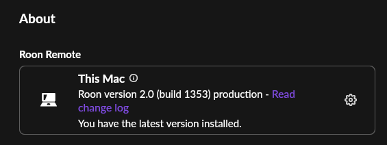

Roon server 2.0 1353

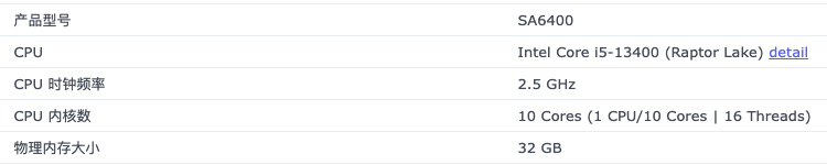

Remote storage device: NAS (Synology: DSM 7.2 64570)

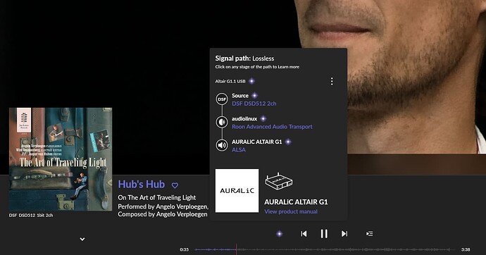

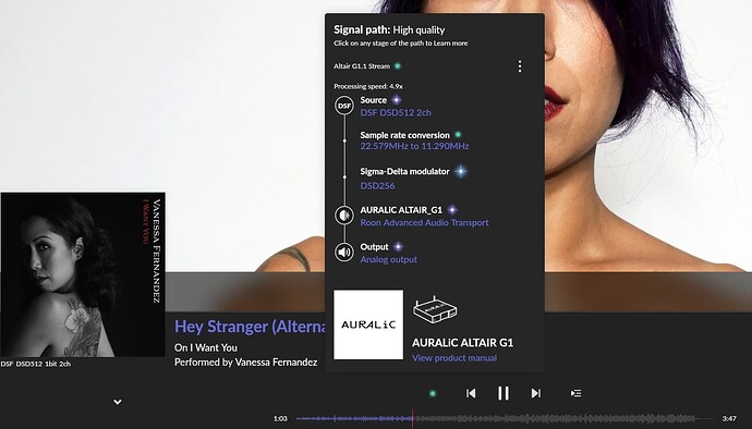

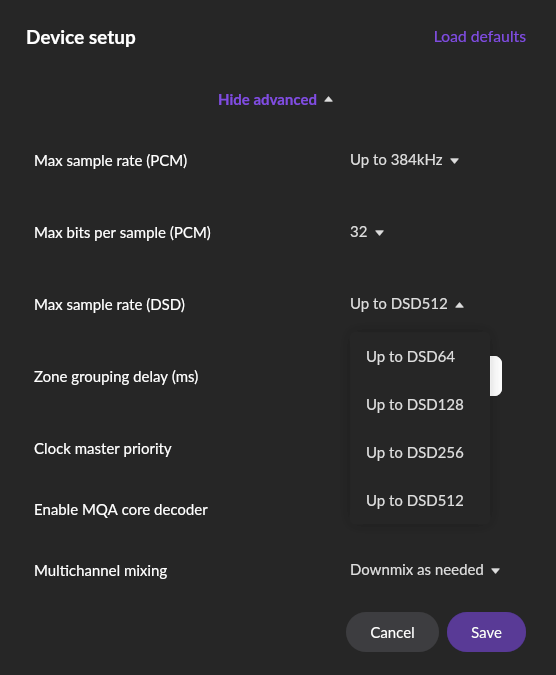

The device supports DSD 512 and also played via stream normally.

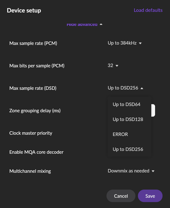

Today I suddenly found the sample rate of “DSD 512” was “ERROR”.
How can I fix this error?

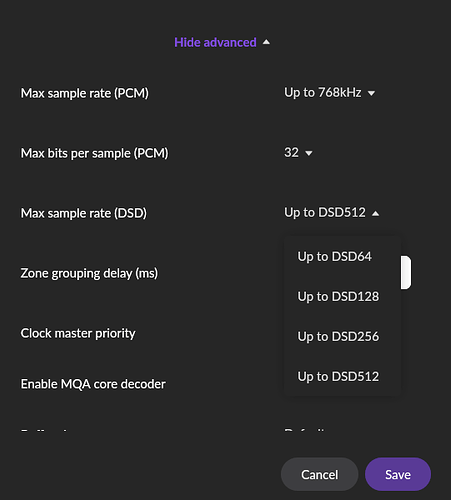

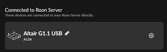

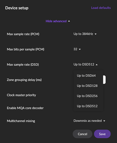

Thanks for your reminder! I think it a basic debug process to do so. Already rebooted the linux and roonservice for many times, and also reinstalled the Roon Server application twice but not solved the issue.
