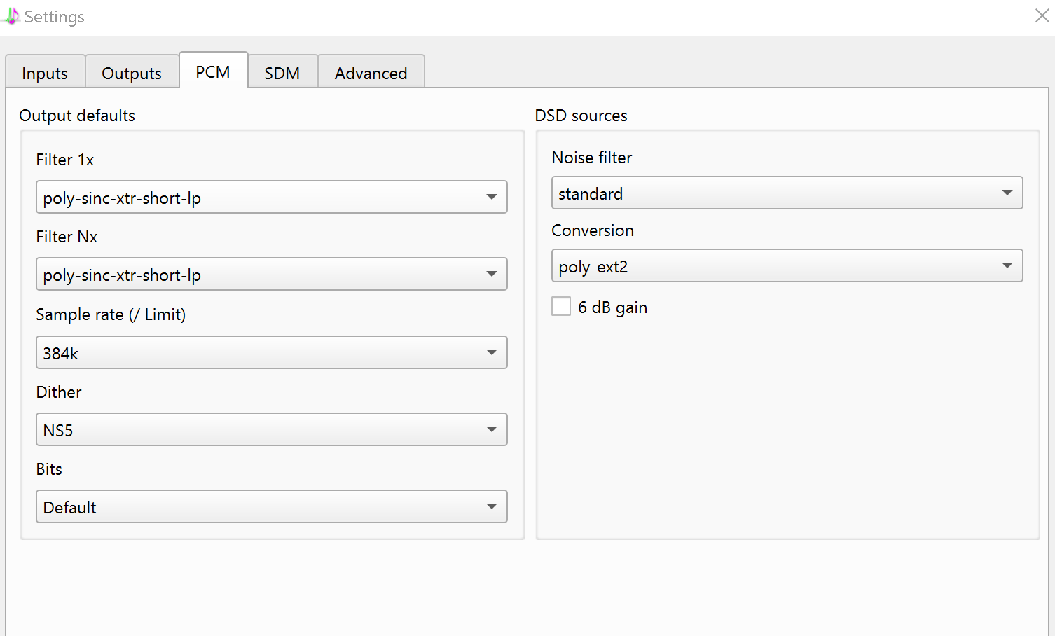

What could cause this limit. The dac is 384. Of cause also the desktop setting is 384.

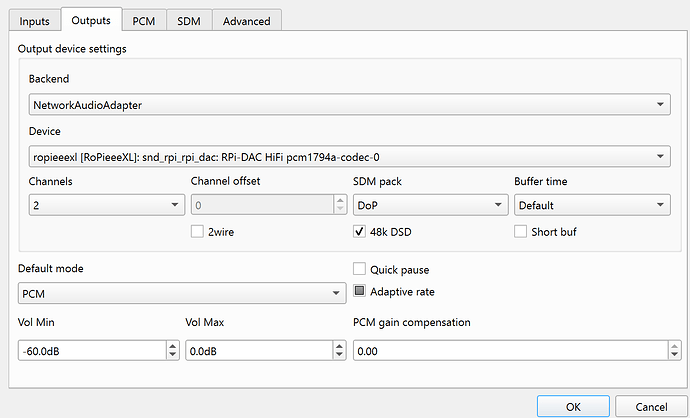

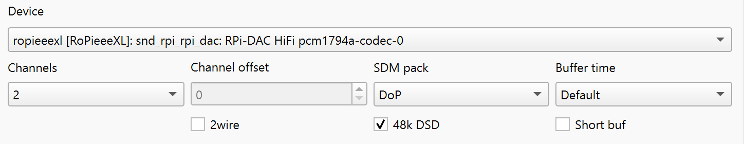

Configuring the HQP desktop the device shown is a:
It looks as if the Raspberri PI propagates a 1794 dac.

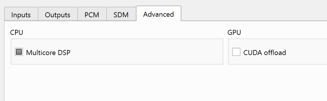

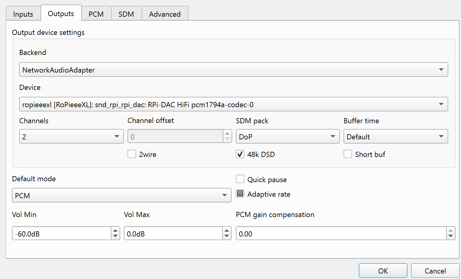

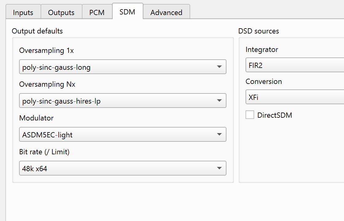

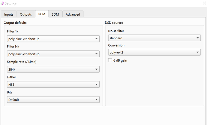

And can you show screenshots of your HQP settings
Settings of HQP server
