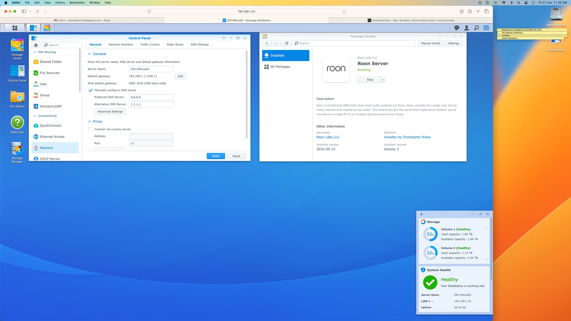

I have done exactly as you suggested. I am attaching the screenshots for you. I still have the same problem.
  1. I have logged out of tidal and qobuz (multiple times) and signed back in. Tidal credentials are perfect.
  2. Changed the DNS settings as instructed and restarted the NAS more than once.
  3. Since I am using Synology DSM6, I have updated the Roon Core as well on the NAS (from your Chris Rieke! section)
No change in results. I still have the same problem from any client (end point) I use. I have several endpoints.

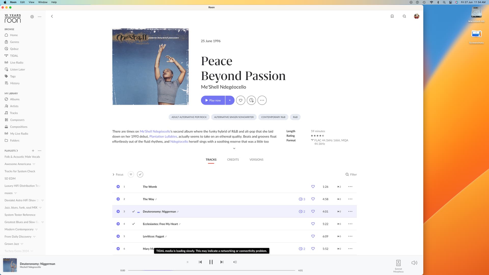

Sorry about the screen shots. Sending them now. The track is seen. This is just one example. Every single album has this issues. That includes my local files. I will ask my internet provider to come over and physically check my entire network to see if there is any physical issue with cables, routers etc. Just trying to rule them out. I will let you know how that goes. Not that I am expecting anything, since everything else is working, but you never know.
Regards,
Subhankar
Hey @sdas,
Thanks for the screenshots and additional info!
We can see the following errors occur, which then lead to playback stopping:
Trace: [Morpheus] [raatclient] GOT [7] {"samples":22050,"status":"Dropout"}
Trace: [Morpheus] [raatclient] GOT [7] {"samples":17640,"status":"Dropout"}
Trace: [Morpheus] [raatclient] GOT [7] {"samples":6201,"status":"Dropout"}
Warn: [Sonnet Morpheus] [zoneplayer/raat] Too many dropouts (>3s dropped out in the last 30s). Killing stream
Trace: [Sonnet Morpheus] [zoneplayer/raat] too many dropouts. stopping stream
However, we see that the track had fully buffered before experiencing the issue:
Trace: [Sonnet Morpheus] [Lossless, 16/44 MQA TIDAL FLAC => 24/44 MQA] [100% buf] [PLAYING @ 0:00] Deuteronomy: [Moderated] - Meshell Ndegeocello
So the playback issue is likely more related to the network connection between your router, server, and endpoints. I’d make sure you are signed out of all other Tidal logins across your various devices.
Does this occur no matter the endpoint you play content from? What if you try playing audio from the system output of your mobile device - does the same failure occur?
See if you can simplify your network connections, and reboot your router (if you haven’t yet :slightly_smiling_face:) and we’ll be on standby for your reply! :folded_hands:
