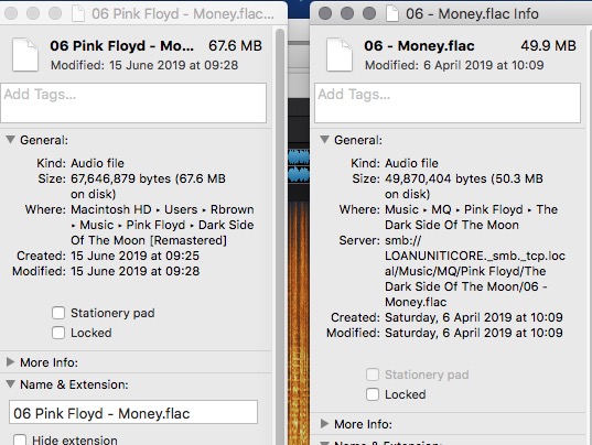

Same CD, different rippers. Do you still want me to email the files to you?
Equipment used - Naim Uniti Core and D100 into a Mac through dBpoweramp.
note, the date appears very unusual, but I assure you the LOANUNITICORE version was ripped moments before the screenshot was taken.

Letâs go through the same steps as before. First, as Rob notes, the files obviously have radically-different sizes:
% ls -l '06 - Money.flac' '06 Pink Floyd - Money.flac'
-rw-r--r-- 1 distler 49870404 Apr 6 2019 '06 - Money.flac'
-rw-r--r-- 1 distler 67646879 Jun 15 2019 '06 Pink Floyd - Money.flac'
