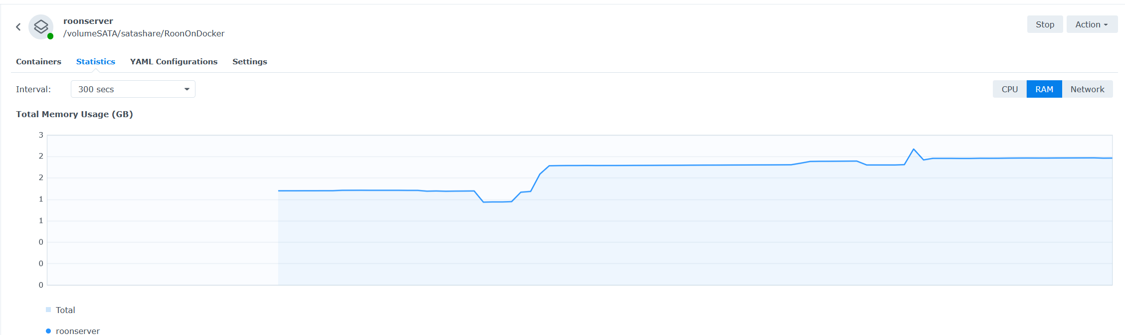

· continous build up of memory usage on the NAS combined with increasing slowlyness of the entire Roon System
Memory usage increases over a few days on a Synology NAS. Library size small with 15.000 tracks, memory usage exceeds 4 GB. My NAS is upgraded to 18 GB RAM.Roon becomes sluggish, music starts after several seconds, search slow. Latest build on NAS container, all remotes up tot date

Thanks for writing in and for sharing your report! We have good news for you surrounding memory related issues, our development team has a handful of memory optimizations that are currently on our Early Access branch of Roon, which will eventually make their way over to the full Production version.
So, the next Roon update prompt you recieve should contain a handful of optimizaitons that should help with the performance issues you face a few days after rebooting Roon Server.
Until then, I’d suggest a daily reboot of Roon Server. Or, if youre intesreting in migrating over to our Early Access version of Roon, I’ll share the KB on this process below:

We recently released a new Roon build with memory improvements. Have you had a chance to try it, and have you seen any improvement on your end? Please let us know when possible, otherwise this thread will close soon and if you need further assistance, you’ll have to submit a reopen request:
I will be able to try it on August 13th and report on the result immediately.
