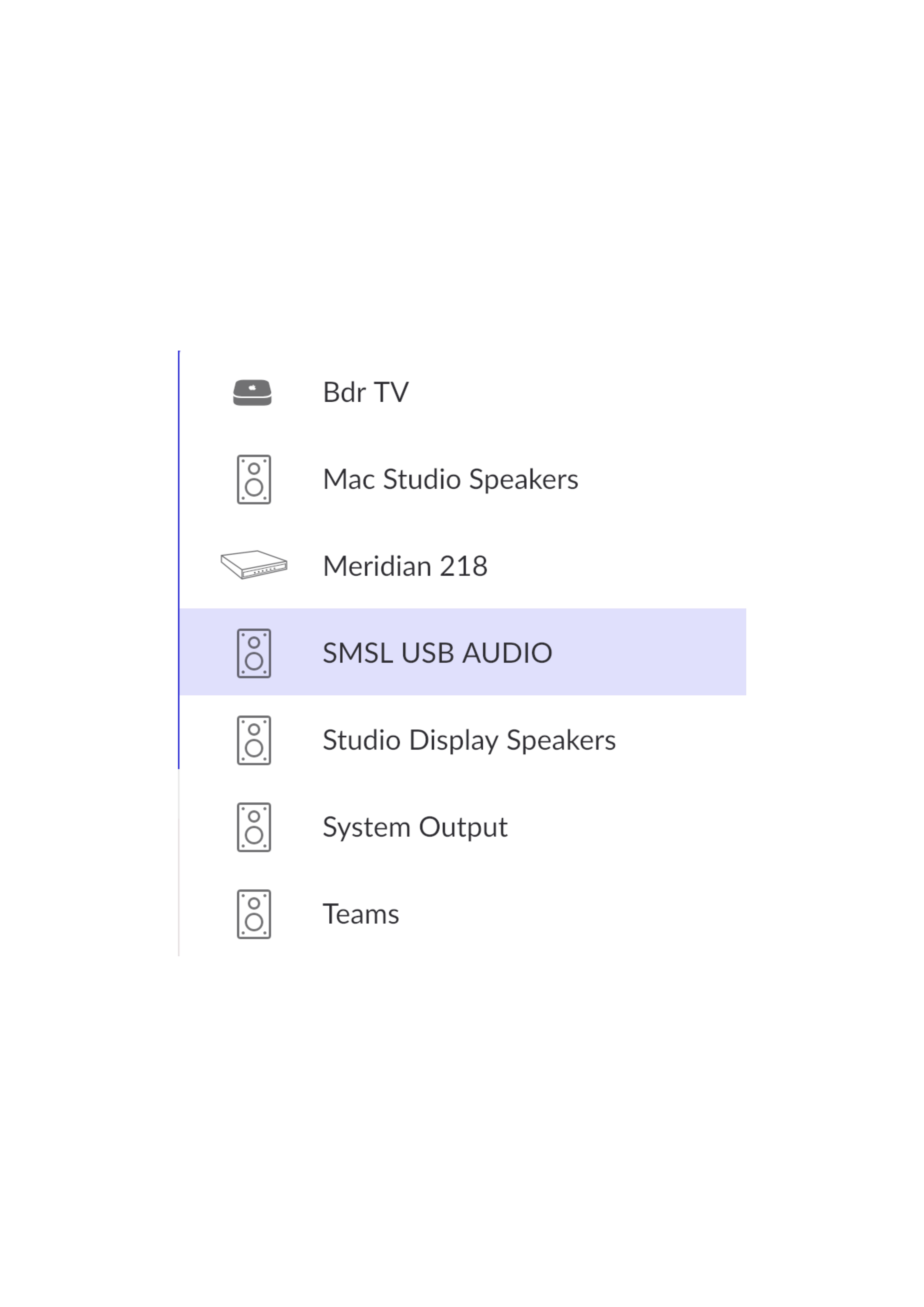

Roon app running on a Mac computer with an Meridian 218 end point connected using wifi. Everything has been fine for years. A few days ago, in the Audio settings, Roon tested devices: the M218 constantly disappears and reappears every 3 seconds—no way to play anything.
Computer and wifi repeater connected to the same network. From the wifi repeater to the M218, an ethernet connection

Thank you for the detailed report — the “appear / disappear every few seconds” behavior is almost always caused by an unstable network hop, especially when a Wi-Fi repeater is part of the chain.
To rule this out, could you please perform this test:
1. Temporarily remove the Wi-Fi repeater from the setup
Please connect your Meridian 218 directly to the main router (Ethernet), bypassing the repeater entirely.
2. Restart both devices
  • Restart your RoonServer (Mac)
  • Restart the Meridian 218
3. Check if the endpoint stays online
If the Meridian appears stable under Settings → Audio, try playing something.
If the issue still occurs
Please provide the exact timestamp (date + time) when the Meridian dropped again, so we can review the logs on our side.
This will help us determine whether the issue is purely network-related.
Thanks — we’ll take it from there once you’ve run the test.

Hi Benjamin, Sorry for the delay on answering.
I resolved the issue. I just unplugged and plugged the wifi repeater and now everything seems to work fine.
Thank you for your help.
Hello @jagoras ,
Thanks for letting us know the issue is resolved by rebooting the repeater. Generally speaking, mesh-style units are more reliable from what we’ve seen, in case you have further issues with the repeater. Happy listening!
