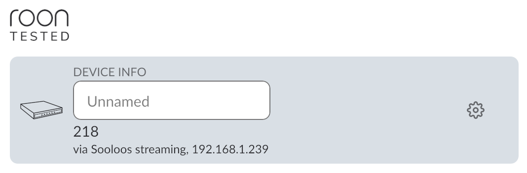

If you can the 218 to the network, you’ll be able to stream to it using Sooloos streaming - you should see it in Roon in the audio settings:
