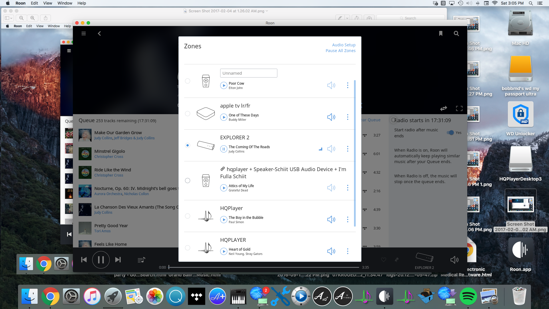

Meridian explorer 2 and ROON
Hello-
Just received my new E2
attached it to my mac mini
it is recognized by TIDAL/Qobuz/A+ and I THINK by ROON
I get no music via the E2 with ROON the sound bar is moving up and down but no sound and no lights on the E2
can someone give me a detailed but simple step by step guide on how to get E2 to interact with ROON
E2 doesn’t work with A+ although it did initially
am currently listening to a playlist of the DEAD’s MQA albums I made on TIDAL but am using my Schiit GUNGNIR DAC using RS-195’s connected to my AVR sound very very good NOT as good as from TIDAL desktop with E2 with MQA blue light on the E2
if i connect the RS-195’s to the Schiit MAGNI headphone amp with the GUNGNIR DAC and using ROON the SQ is very harsh- is this the MAGNI or ROON(and the MAGNI)? in any event the sound of the ROON playlist is much much better connected straight to my AVR headphone jack
the bottom line is why doesn’t ROON play through the E2 what do I have to do?please keep it simple and easy to understand(this can not be be rocket science can it?)
thank you
Can you take a screen shot of your Roon signal path and play screen? I have tried the E2 with two Roon end points and it worked great.
