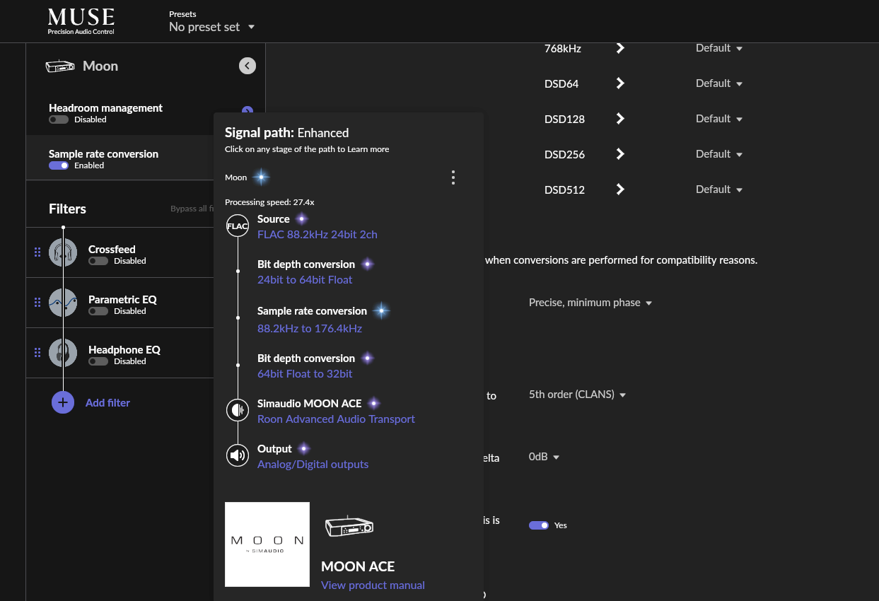

I have a Mind 2 Moon Ace unit but dont have any 176.4 files to try or even any 88.2 to try to upsample to 176.4 and see if same occurs.
For the time being can you set Roon to upsample these 176.4 files so playable through the Mind2?
I did find just one 88.2 album in my collection.
The Moon Ace Mind2 played it just fine native and custom to 176.4 with the display on the Moon showing 176.4 along with Roon signal path.
So maybe something else or it is a problem with native 176.4 files which I don’t have any of.

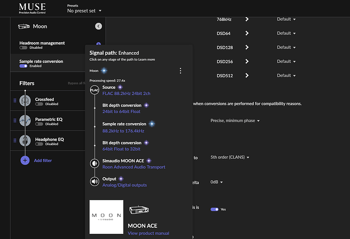

Not at home now so can’t post a screenshot but you go into Muse and set sample rate conversion to enabled.
Then select custom from the drop down menu at right and for 176.4 instead of default select say 192 as a test.
My first shot shows the Muse screen and half of what I am referring to
What is the Muse app? I have the Moon/Mind app and can’t find anything for Muse Moon App? Thank you.
Nevermind Found it in Roon..did the trick, thank you!
