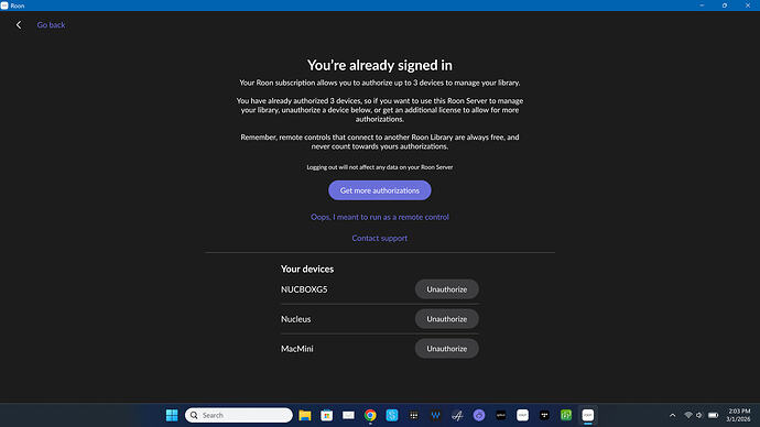

Ok, i’m realizing I don’t need two subscriptions, but do I need to “deauthorize” one BEFORE authorizing the other?
Or is it a situation where you get a message saying “authorizing this core will automatically deauthorize the other core”? (This is more like a garage/workshop than a cabin, and I go back and forth multiple times a week. So I don’t want to have to remember to deauthorize at the location I’m leaving. That would be a non-starter.)

No
Yes. It says „your license is connected to A“, and there is an „Unauthorize“ button which will remove it from A and move the license to B. If you search the forum for „Unauthorize“ you will find a hundred cases with screenshots.
You can do this from either Roon server as the license location is maintained on the Roon Labs servers.
