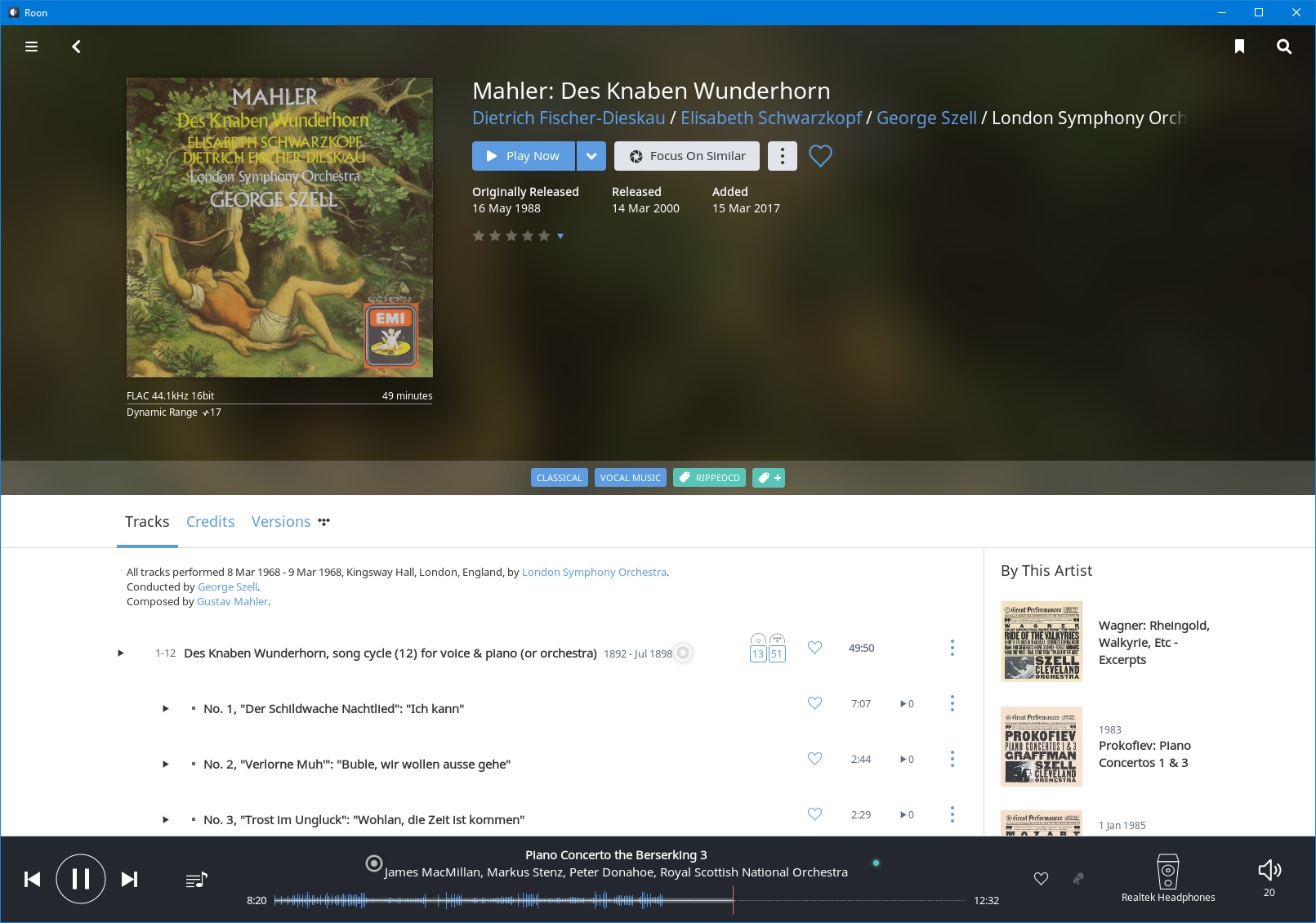

The problem I have is that Roon shows a set of songs entirely different from what is on the CD. I just listened to the first song on the CD, and it begins with “Des Morgens zwischen dre’n und vieren” (I know German well enough to be sure that is what I heard, and that is what is given for “Revelge” in the CD booklet). I then listened to “Der Schildwache Nachtlied” (which Roon claims is the first song on the CD) on a different CD; “Der Schildwache Nachtlied” begins with “Ich kann und mag nicht fröhlich sein,” and the singer (Thomas Hampson) is singing those words. So I am confident I know how “Revelge” begins and how “Der Schildwache Nachtlied” begins. The CD at issue begins with “Revelge.”
So I am certain that my CD is that described by the second link I gave above and thus that Roon is completely wrong about what’s on my CD.
How do I get Roon to find the right information? This is not a picayune mistake.

James, Roon knows about 5 different versions of this album. It looks like you (and I) have version 2. You’ll have to help Roon choose the correct version. I’ll also have to tell Roon to use the cover art from the ripped tracks to get the correct match there as well.
This is an interesting one. You see, on the two releases you link to, (a) the personnel are the same, (b) the track timings are so close that one really can’t be anything other than a re-issue, and (c ) both the Discogs entry and the allmusic (TiVo) entry say that this is the 1968 recording at Kingsway Hall.
So… We have the same set of 12 tracks (give or take re-issue truncation of a second or two). Which metadata are correct? Discogs or allmusic?
The answer is on the back cover of the allmusic album.
TiVo has made a mistake and applied a “standard part list” for Das Knaben Wunderhorn to this release.
To get the best quality metadata, I would submit a correction request to TiVo (via allmusic) here:
All you have to say is that the part listings for the performance do not match up with the track titles on the back of the CD cover. It won’t take that long to get sorted out.
Having said all that, the metadata you’re after is available via Roon. Do a manual identification and select the option “This is the metadata that is currently being used for this album”. Then pick the 2nd release (2 of 5):
I didn’t check track numbers. But I just found that the wrong listing and the correct one have 10 (out of 12) songs in common (but different in order). The wrong listing uniquely has “Es sungen drei Engel” and “Urlicht”; the correct listing, “Revelge” and “Der Tambourg’sell.”
