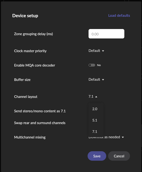

You want the PCM option for HDMI. Also when you go into device setup for the HMDI zone - show advanced - and scroll down to the bottom - you should have an option for channel layout. My Denon AVR-X8500H is setup that way.
Can you take a screen shot of your settings - Audio page and post it here?

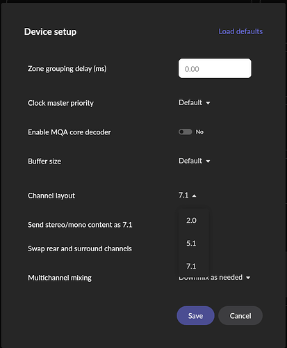

You should be seeing the option to choose multichannel in the Advanced section of Device setup…
You may need to scroll down to reach these settings - and there is no scroll bar shown, so it’s not immediately obvious that the settings are there…
THANK YOU - the update was part of the problem! I do have Multichannel settings on Roon now -

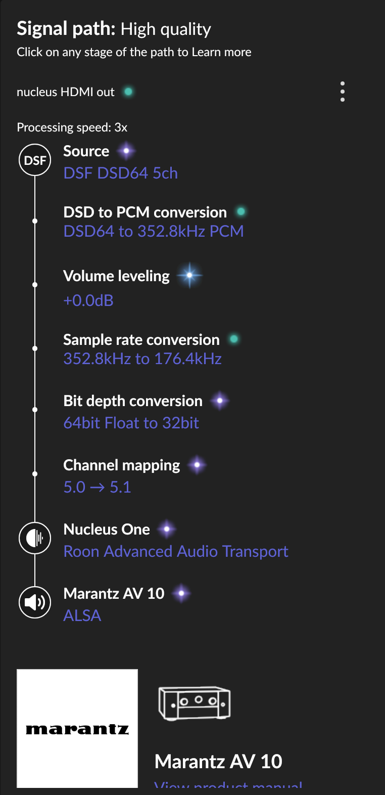

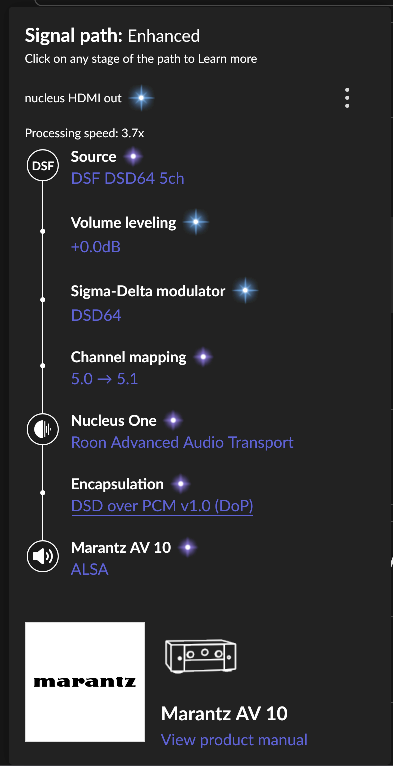

Next - I need to see if the AV10 will let me retain the DSD without PCM conversion. Info on the AV10 shows its seeing a 5.1 signal coming in through HDMI, just the PCM plays, the DoP is quiet noise.

You are getting DoP which is DSD. Native DSD is not a Linux thing and things have to be set on the kernel and device.
So you are good. You might investigate the Dmp a6 if you want “native”.
Btw,If you are using any room correction on the AV then not of this matters since the room correction process will decimate to.pcm prior to running the corrections.

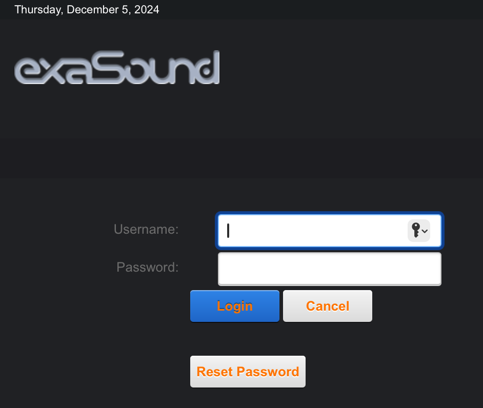

Great to know you’re familiar with the exasound s88. I would also take advantage of the 8 analog outs.
And, sending me the link is super kind - but I think its bringing up an outdated/buried page because of the line “Offer valid until December 03, 2023, while current stock levels last…” When I visit the site and hit any buy button I see this:
And there may not be a component on earth that supports HDMI DoP. It just is not a thing in the AV realm, hence “the DoP is quiet noise” on the Marantz.
Yup. I repeatedly have to post the same every few months as threads like this pop up. AV guys fixated on seeing DSD input to an AVP/AVR fail to acknowledge that any DSD probably gets sample rate converted to 96 kHz at best, but more likely 48 kHz.
And it is not just digital room correction. Add channel level trim, channel distance/time delay, channel remapping, bass management, graphic/parametric EQ, etc. All of these useful and common functions in AV components may or do cause unspoken internal conversion of DSD to PCM.
Like so many others, Keith probably is chasing a DSD ghost here. Not worth the effort.
AJ
DoP is supported over spdif and usb in some cases but will be DoP for two channel as no way you can do multiple streams over DoP. You need 192/24 for just DSD64 with two channels. Marantz don’t support more than 192/24 pcm period. So you’re chasing something not possible here. If you want to maintain DSD via HDMi you need a streamer like the DMP A6 nothing else will do what you want without an external dac like the Exasound.
