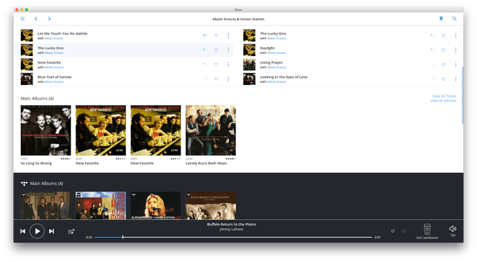

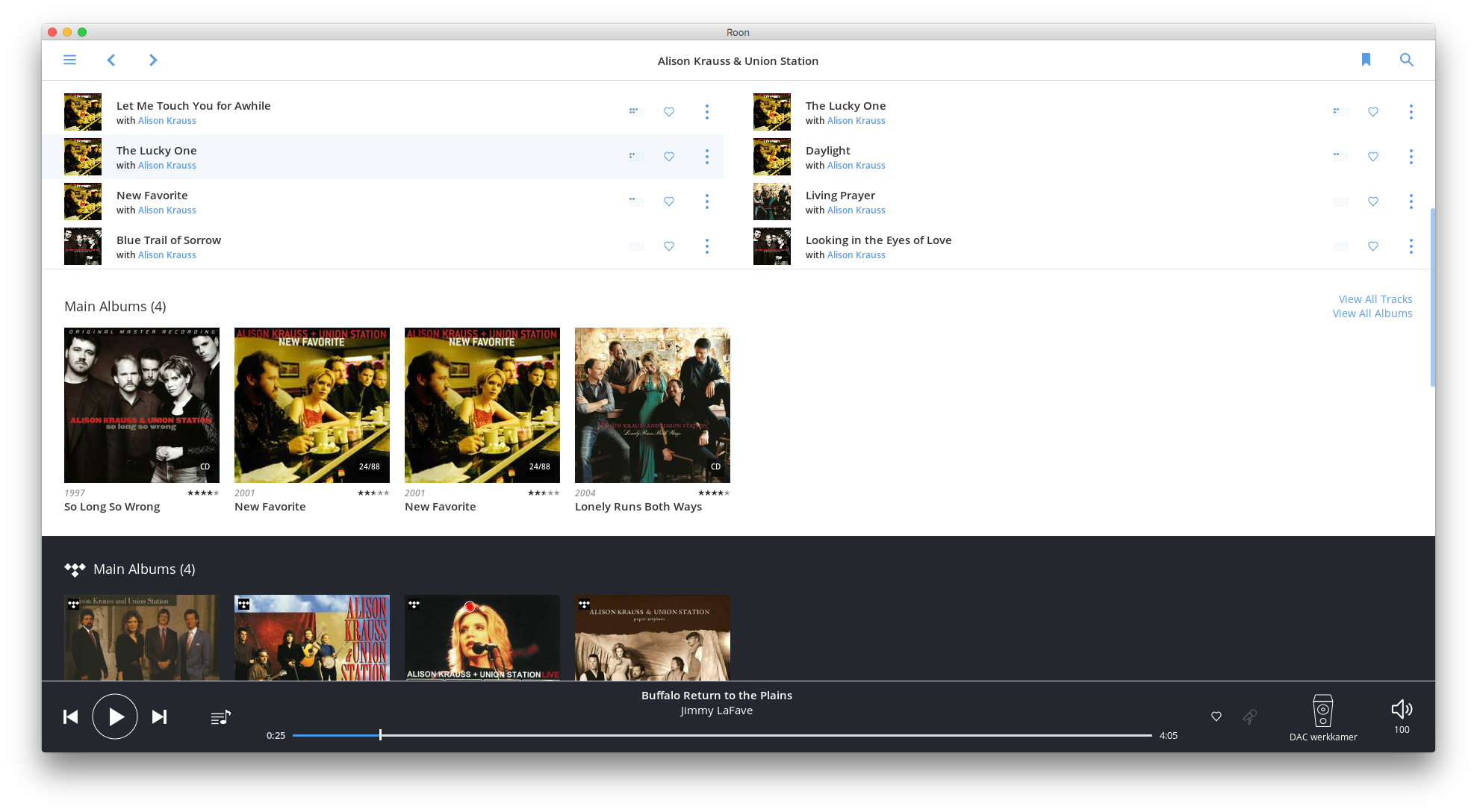

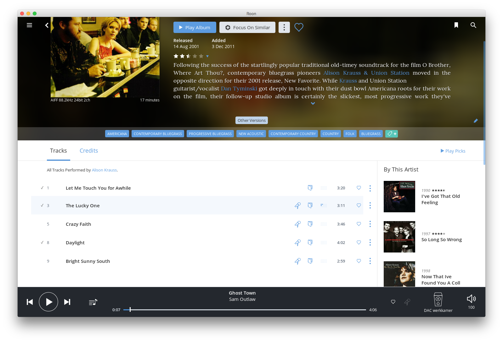

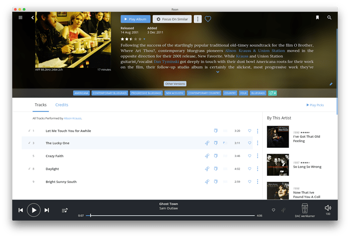

Additional info.
While Roon reported the album had been deleted it still appears to be present.
See screenshot. Now two versions exits and concerns "New favorite"album.

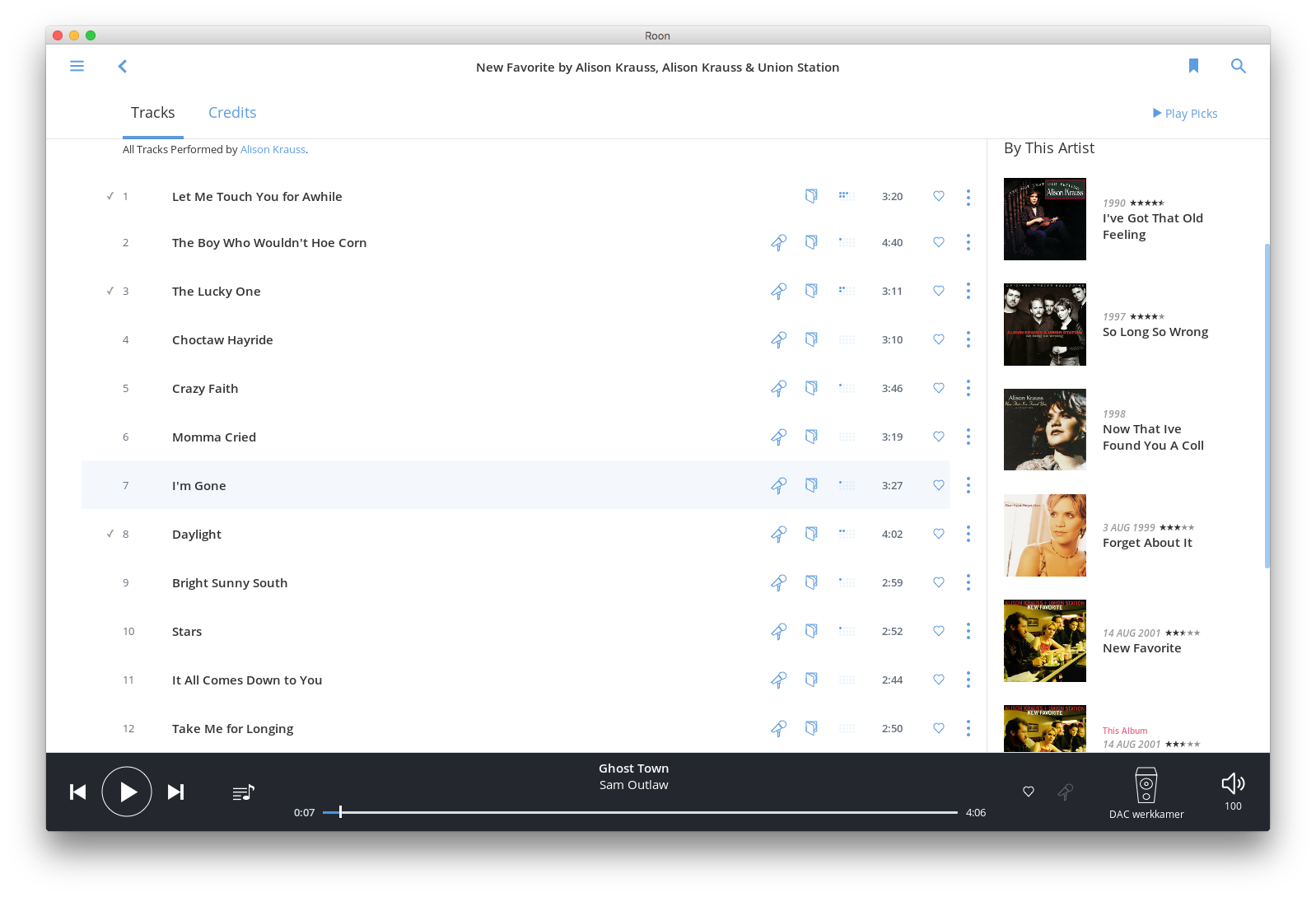

  • can you give me few examples of the missing files: name of the album / name of the missing tracks
  • would you mind to go to details page of each ‘New favorite’ album and check the track list. Is the iTunes album still missing few tracks and an album from the watched folder has full list of tracks?

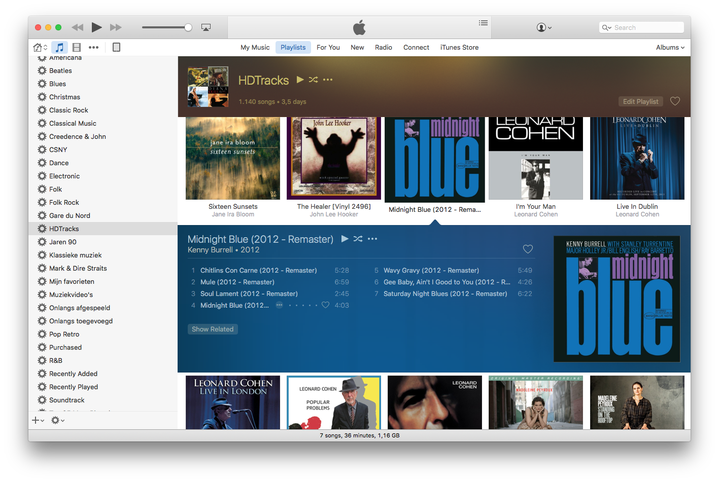

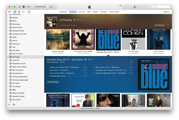

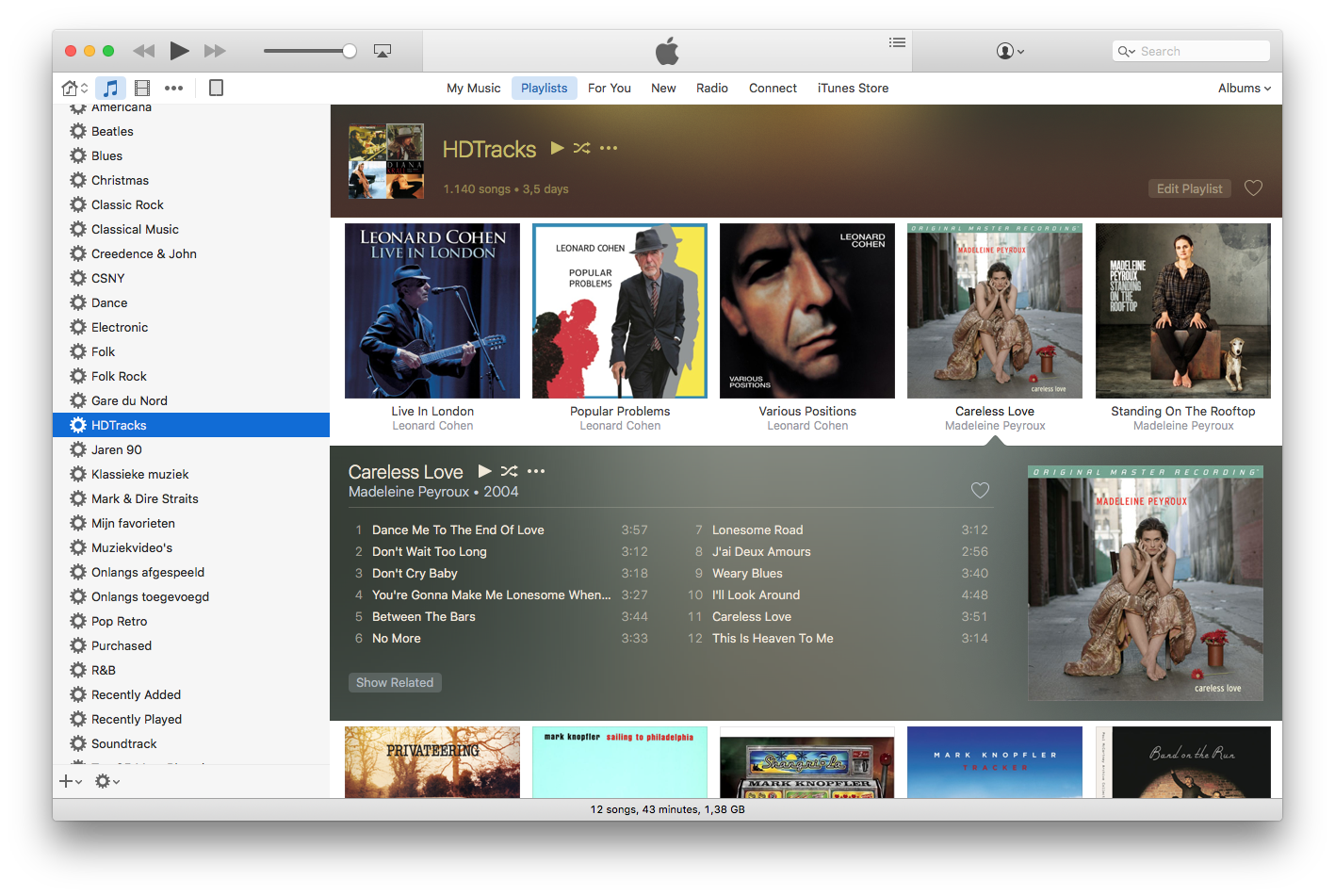

Two more albums with missing file:
Careless Love from Madeleine Peyroux: missing files in Roon are 2,3,4,5,6,7,8,9,10
Midnight Blue from Kenny Burrell: missing files are 4,5,6,7
Two Roon versions of album New Favourite:
