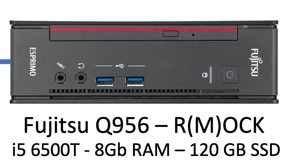

The standard Q956 works like a charme as a MOCK.
