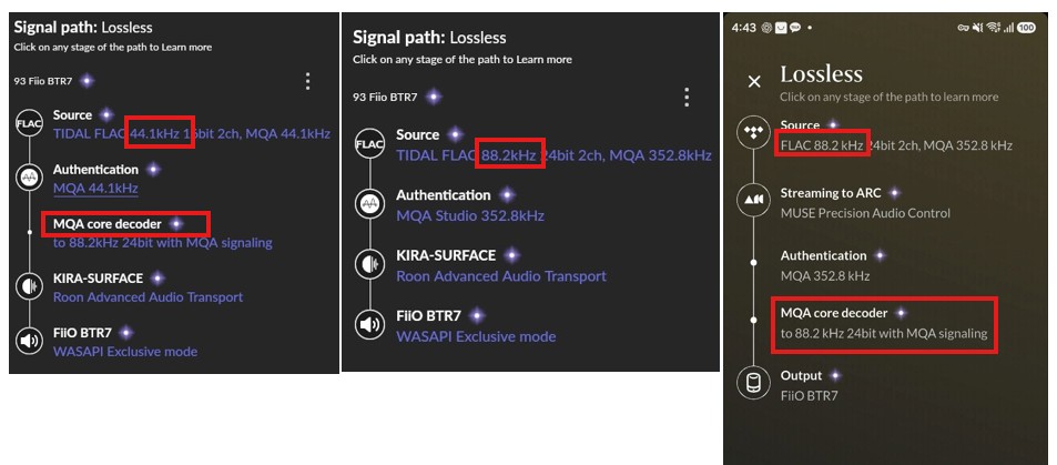

1. 44.1 kHz MQA source
Roon correctly applies the MQA Core Decoder:
Source: FLAC 44.1 kHz / 16-bit, MQA 44.1 kHz
MQA authentication is shown
MQA Core Decoder is shown
Output becomes 88.2 kHz / 24-bit
The BTR7 performs MQA rendering correctly
2. 88.2 kHz MQA source
With the same endpoint, device and settings, Roon does not apply the MQA Core Decoder:
Source: FLAC 88.2 kHz / 24-bit, MQA 352.8 kHz
MQA Studio authentication is shown
The MQA Core Decoder stage is missing
The signal is sent directly to the BTR7
The BTR7 does not enter MQA rendering mode
3. The same 88.2 kHz MQA track in Roon ARC
When I play exactly the same track through Roon ARC:
The MQA Core Decoder stage is shown
The FiiO BTR7, USB connection and MQA renderer are therefore working correctly. The only variable is the playback path: regular Roon/RAAT versus Roon ARC.
It appears that regular Roon playback skips MQA Core processing when the source stream is already 88.2 kHz, while Roon ARC processes the same stream correctly.

Thanks for the explanation.
To clarify, this is not only a difference in Roon’s signal-path display. When I play the 88.2 kHz MQA track through the Windows/RAAT path, the BTR7 itself does not display the MQA indicator.
However, when I play the same track through Roon ARC with the same BTR7, the MQA indicator appears normally.
Therefore, the BTR7 does not appear to be entering MQA render mode through the Windows/RAAT path, while it works correctly through Roon ARC.

Thanks for the suggestion. I tested the BTR7 with MQA Capabilities set to “Decoder and Renderer,” but it does not work.
The BTR7 is an MQA Renderer-only device and cannot perform the first unfold itself. With “Decoder and Renderer” selected, the BTR7 does not recognize MQA at all, even with a 44.1 kHz MQA source.
For comparison, my other full MQA decoder devices, including the FiiO KA17 and Cambridge Audio CXN100, work correctly when configured as “Decoder and Renderer.” This appears consistent with the documented behavior of these settings.
Therefore, “Renderer Only” is the correct setting for the BTR7. Under that setting:
  • 44.1 kHz MQA works correctly because Roon performs the Core Decode first.
  • Native 88.2 kHz MQA does not engage the BTR7’s MQA renderer.
  • The same 88.2 kHz track works correctly through Roon ARC with the same BTR7.
The remaining issue therefore appears to be specific to renderer-only devices such as the BTR7. On the Windows/RAAT path, Roon does not seem to provide a renderer-ready stream for native 88.2 kHz MQA sources, while full-decoder devices work as expected.
Could you please revisit this based on the BTR7 being an MQA Renderer-only device?

Thank you for reviewing this in detail and for raising it with your development team.
Regarding the driver version, I previously used the FiiO USB driver V5.74.3 and experienced the same issue with the BTR7. I later switched to the Microsoft native USB Audio driver through WASAPI, mainly to determine whether the FiiO driver provided any relevant advantage or changed the behavior. It did not appear to make any difference regarding this MQA issue.
Therefore, my most recent tests were performed with the Microsoft native driver, but the same native 88.2 kHz MQA behavior had already occurred with FiiO USB driver V5.74.3 as well.
Regarding the MQA rendering/passthrough option, I was not playing through the TIDAL desktop application, so I believe this may be different from TIDAL’s own “Passthrough MQA” setting. I also do not recall seeing a separate MQA rendering or passthrough switch in the FiiO USB Audio Control Panel while using driver V5.74.3.
Please let me know if you are referring to a specific setting elsewhere, and I will check it.
I also tried to locate a native 96 kHz MQA track in my currently accessible TIDAL catalog through Roon, but I was unable to find one. The available MQA sources I could identify were limited to 44.1 kHz and 88.2 kHz, so I could not perform the requested 96 kHz test.
