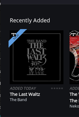

Ok. Thanks for info about the resolution. However, a lot of my new additions in Roon I already have, but they come up in my overview as new. Some additions doesn’t. One album that simply doesn’t get imported at all is The Last Waltz,
Yes. I am seeing the same thing. Sometimes it sorts itself out. I use the Roon/Settings/Services/Tidal/Edit/Sync Library Now command often.
Got no clue re: “The Last Waltz” other than it’s a favorite and I will try to “Favorite” it and see what happens.
Came right in for me. (After Syncing per above.)
