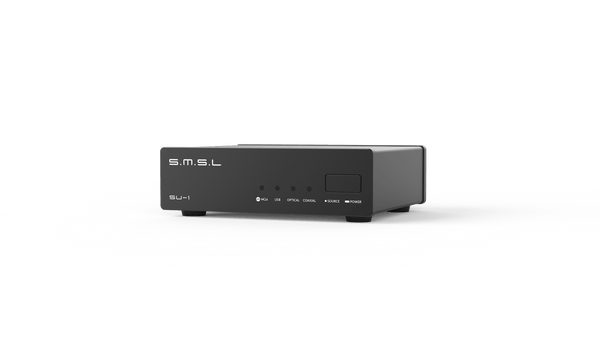

The challenge is that MQA Renderer DACs at below $100 tend to get their power from the USB host. For example, the S.M.S.L. SU-1:
Power draw from the host is up to 5 watts each. If you connected three of these to a NUC, there may not be enough bus power to keep them all running. The Topping E50 solves this problem, but at a much higher price point (also does full MQA decoding on the USB input, not just rendering). Or you could try a bunch of SU-1’s plugged into a powered USB hub. I just worry that you may encounter annoying dropouts if there are bandwidth issues. I’ve had good luck with this powered hub:
