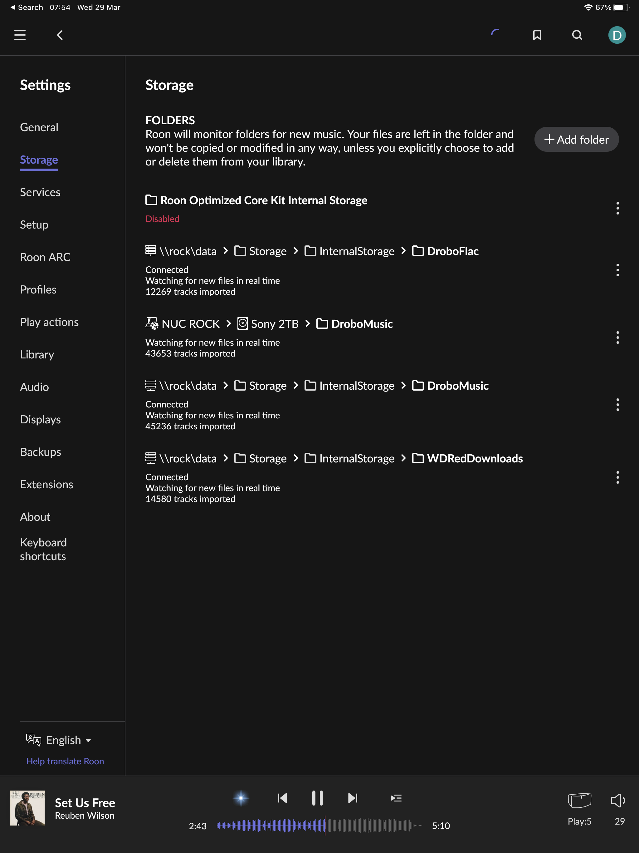

This snippet is particularly illuminating and indicates there’s a potential local storage issue. Logs show a 2TB external drive, as well as a network share location, hosting Watched Folders. We’ll be syncing with development and QA tomorrow - are you able to provide a screenshot of your Roon → Settings → Storage page, and your Watched Folder settings for any storage location hosting content you’ve downloaded to ARC?

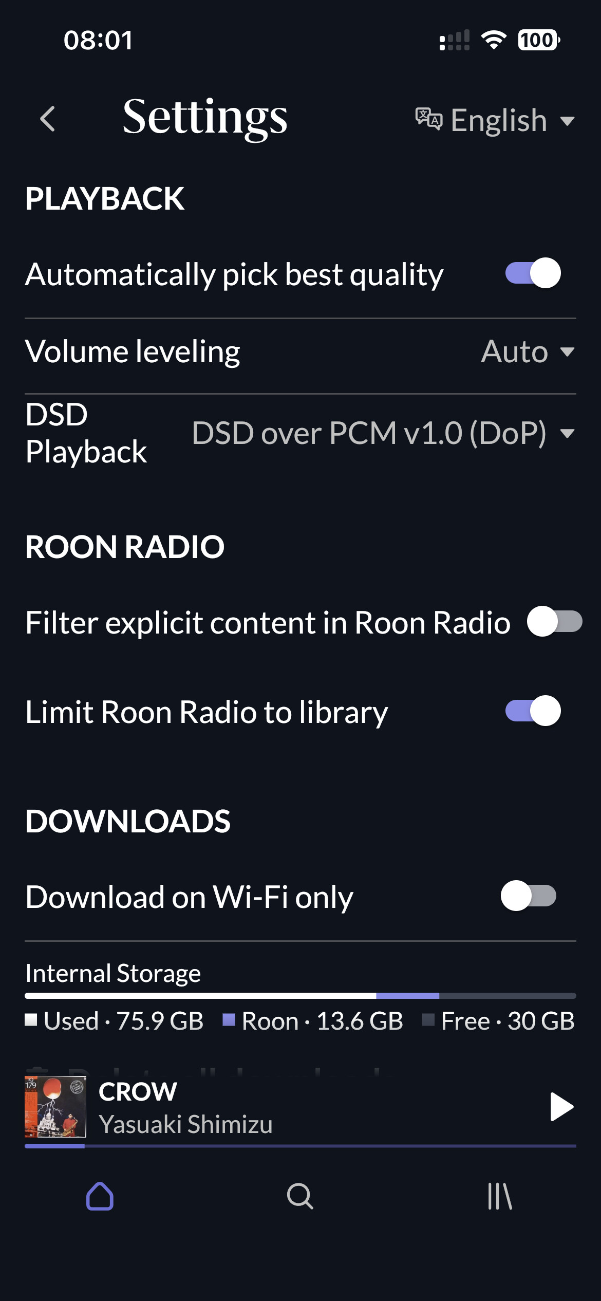

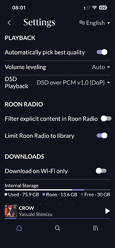

Additionally, if you don’t mind, I have a few questions to clarify conditions within ARC for the team:
  1. Do you have “Download on Wi-Fi Only” toggled on in ARC settings?
  2. Do you have “Automatically Pick Best Quality” toggled on as well?
  3. Are you experiencing any memory or storage pressure on this phone? ARC logs indicate that the phone OS is reporting low RAM nearly constantly when ARC is open. However, this warning may be extraneous and not the root of the performance issues you’re seeing.

@connor thanks for that ~ I hope these screen grabs answer your questions
You might wonder at my internal storage setup - me too! I have a vague recollection Roon wouldn’t find all those folders when I moved from a MOCK build to a NUC and that was the work around to see my whole library

We’ve examined diagnostics further with development and concluded that these tracks are likely still ongoing internally - at least, ARC is under the conclusion that the connection was severed before the download of the audio track and metadata could complete.
This issue might be compounded by what appears to be the intermittent inability to access local files on the part of your Core.
It’s worth verifying your Watched Folders, perhaps moving content to a different directory and rebuilding the path. Additionally, I’d double-check that there aren’t separate VLANs or subnets with the inclusion of the wireless bridge in your setup. I’d restart the router to prompt any firmware downloads, too.
