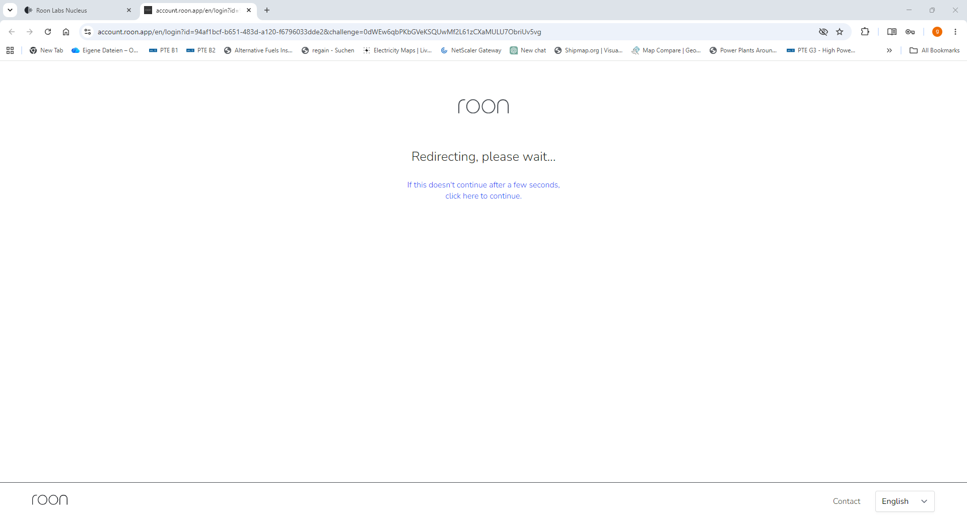

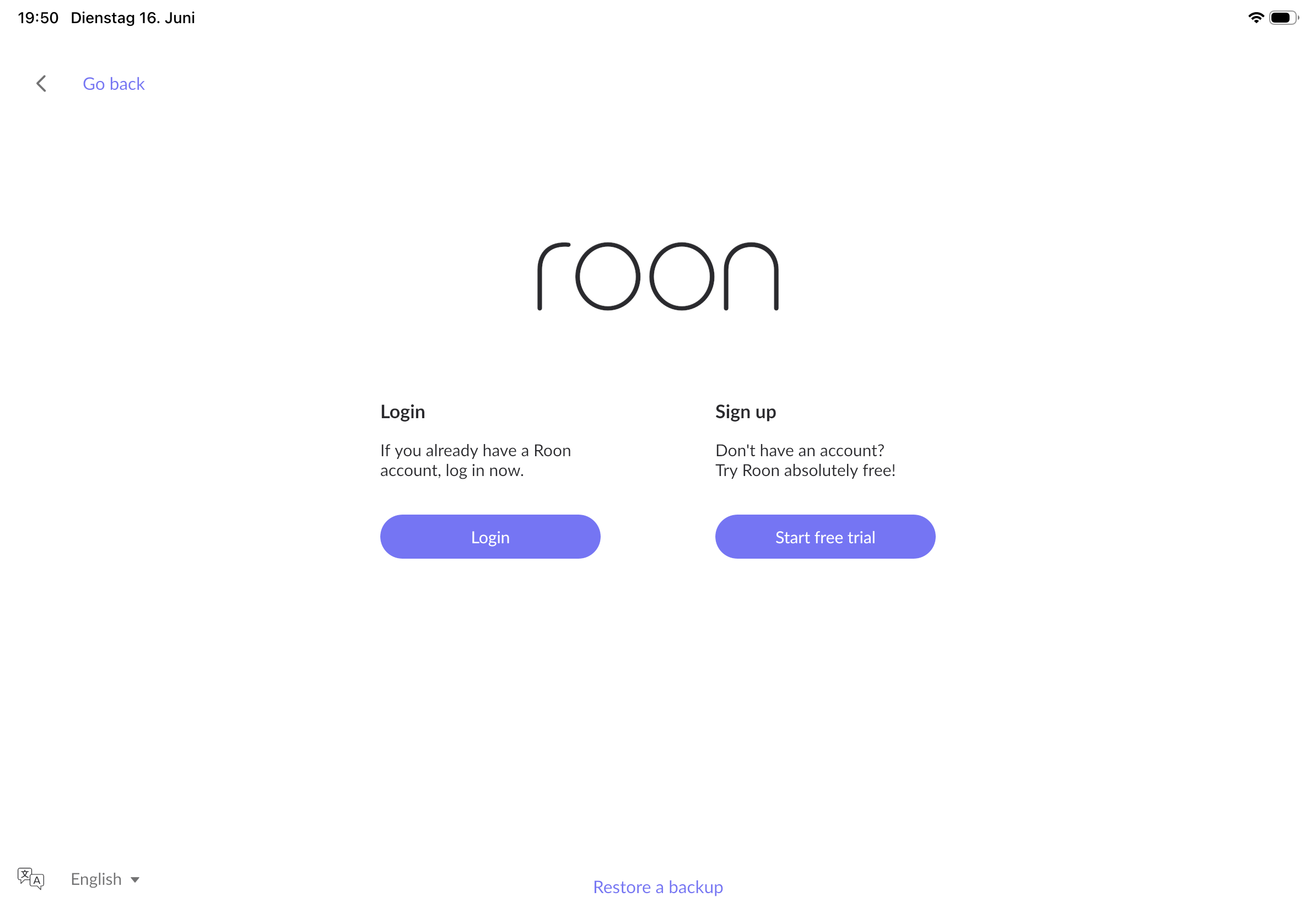

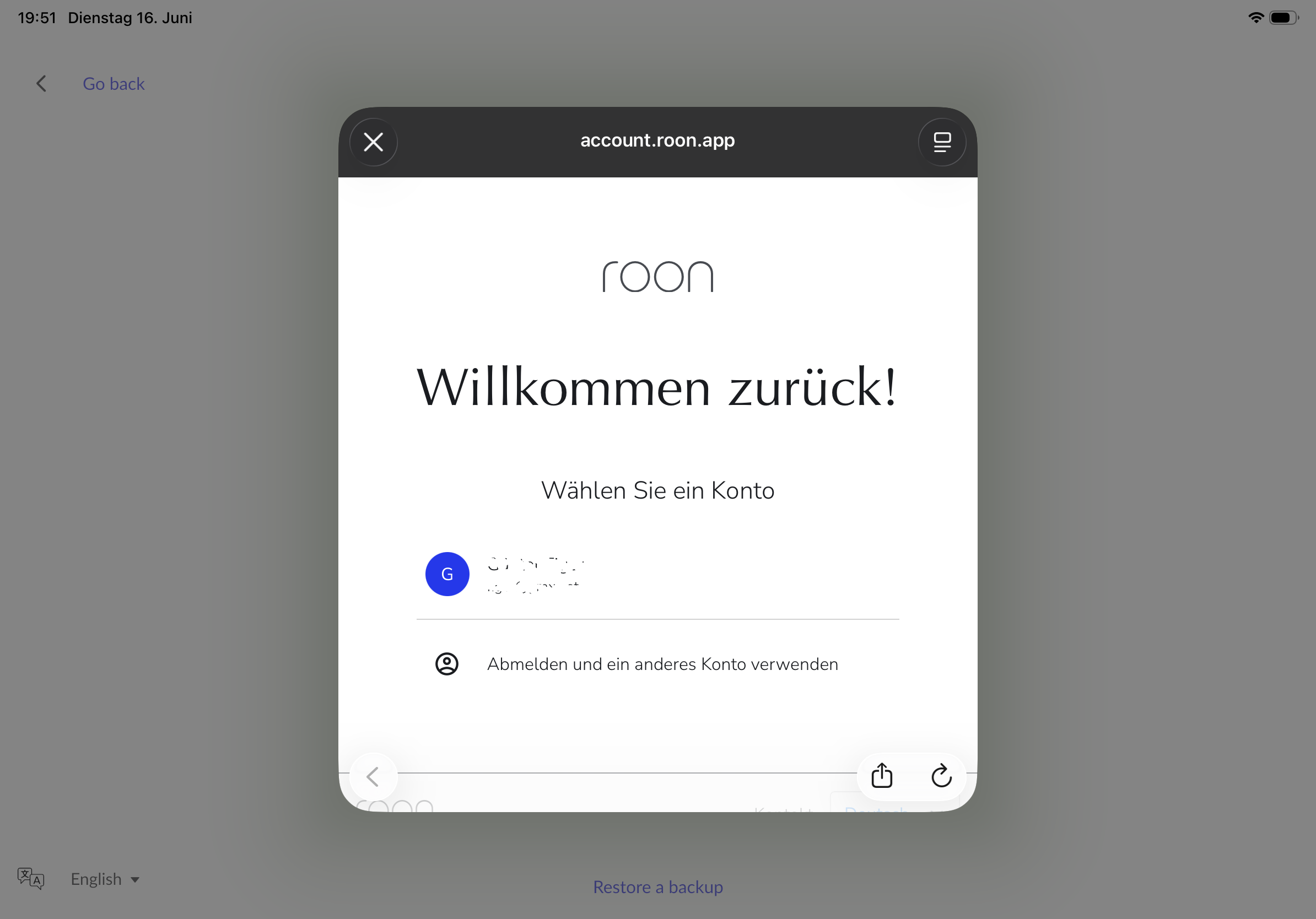

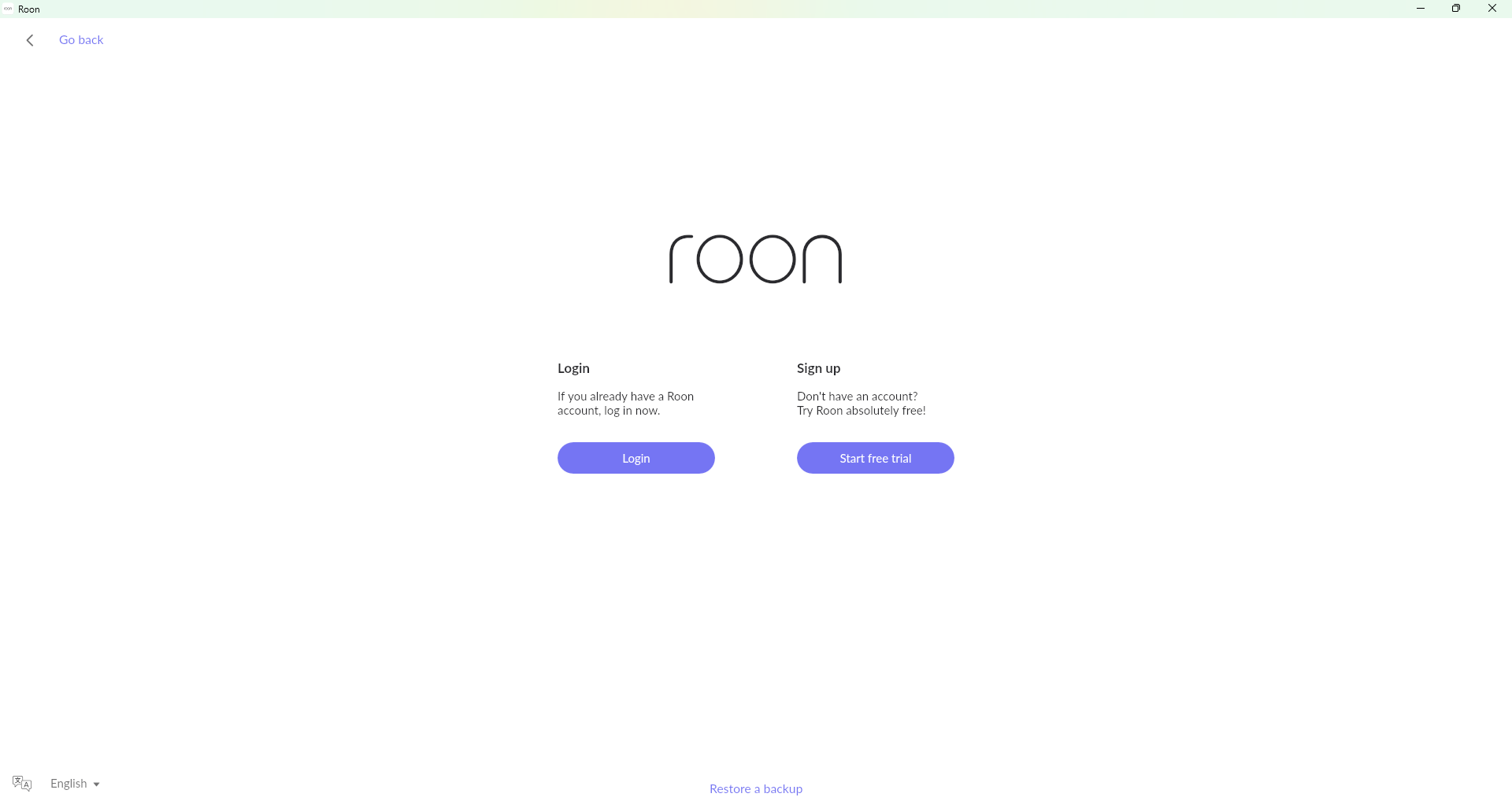

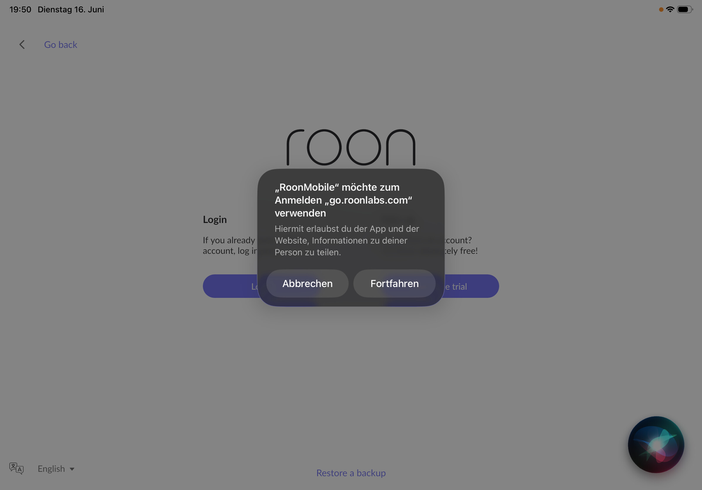

On iOS, when I open up my roon app, I go for my local NUCLEUS (1).
Then it takes me to the login window, which opens up perfectly well (2).
Then I’m routed to go.roonlabs.com (3)
Then I’m prompted to enter my credentials (4)
Then I’m back at square 1 - I can’t escape that loop.
I guess it’s worth mentioning, that my NUCLEUS server worked well in terms of login and running CORE up to that moment when I reinstalled the database and ran my restored backup. (I experienced regular connectivity issues for search, local radio, and Qobuz)
BTW: my temporary local Win11 roon server on my laptop (which is not the way I want to operate) works well in terms of login and roon core. I can’t login from any of my other iOS devices though, which makes it only a work around to play any music at all.
Please advise, how I can - I don’t know - factory reset my NUCLEUS - or even starting a fresh database if this is the only way to proceed. As I said, the same not-running database on my NUCELUS workd perfectly well on my PC.

Hi @Captain_Cunningham,
Thank you for the screenshots - this makes it clear what’s happening. The in-app browser (WebView) used by Roon on iOS is blocking the pop-up redirect that completes the login.
Please try the following:
  1. When you reach the login page, copy the URL from the address bar
  2. Open Safari and paste the URL there
  3. Complete the login in Safari
This bypasses the WebView restrictions and should also avoid any potential issues with reCAPTCHA. Let us know if that gets you through!

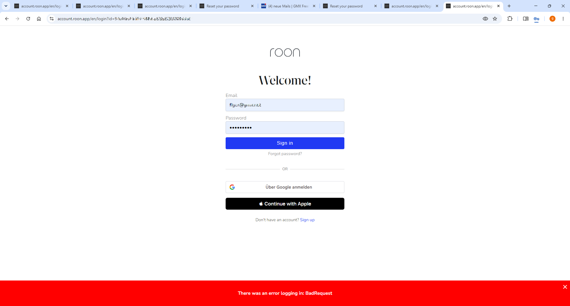

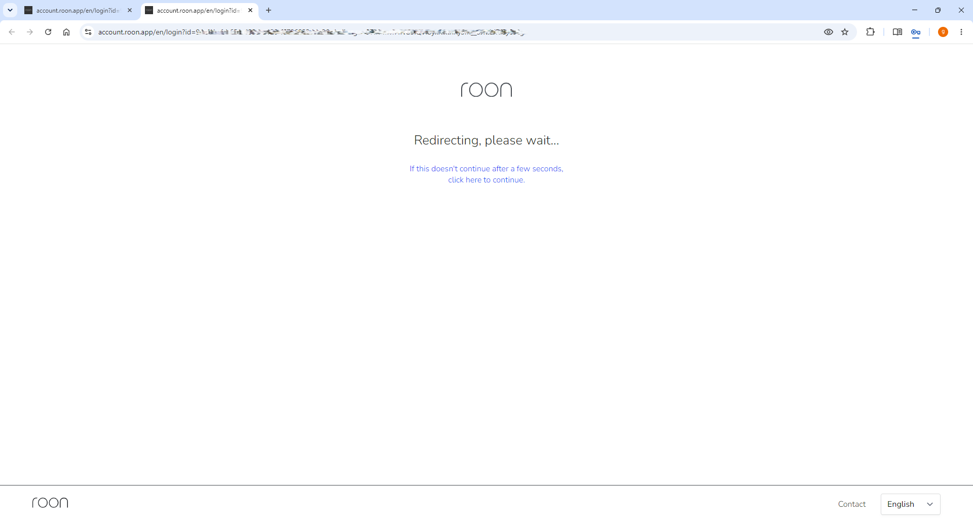

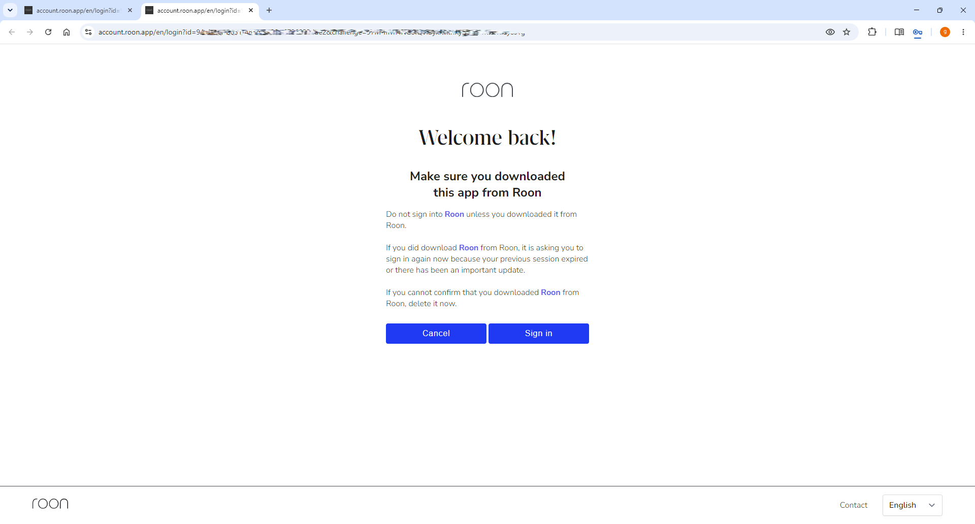

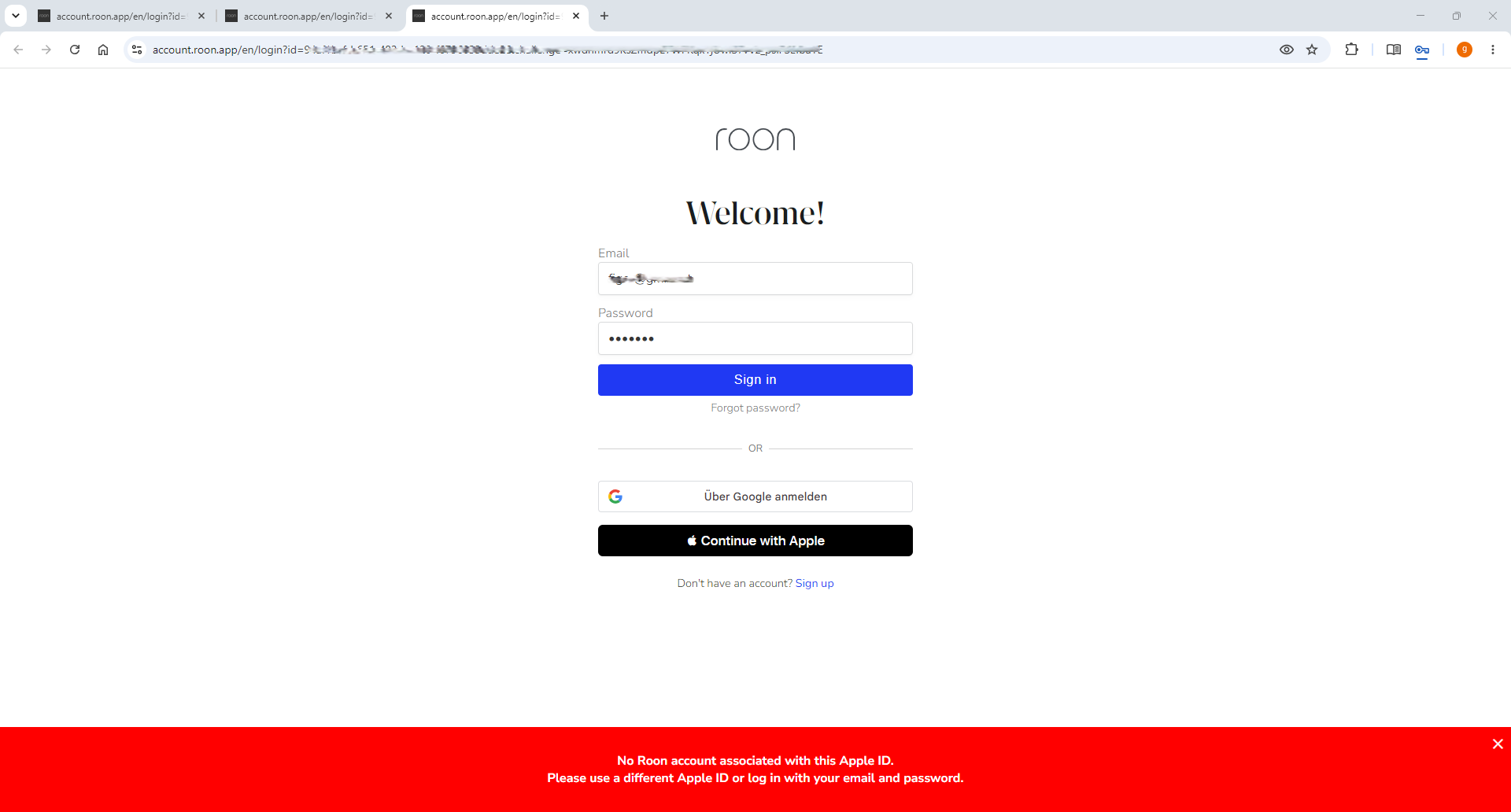

Thank Vadim for your support, but no, this doesn’t work either.

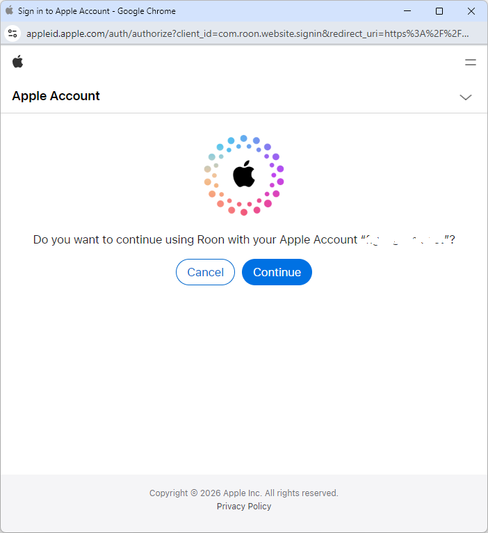

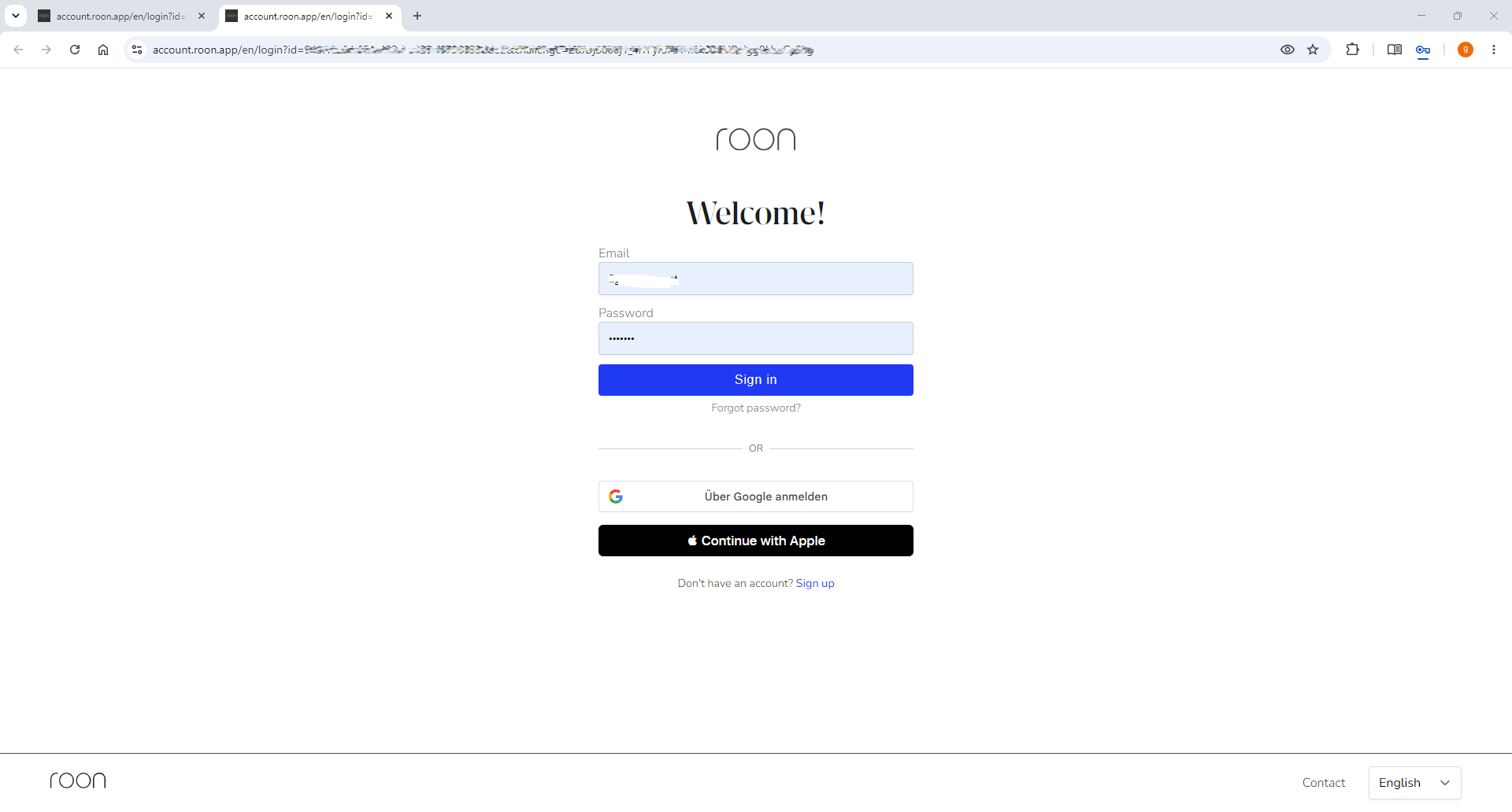

Here is the sequence of the drama unfoldingm when trying to entery my NUCLEUS:
I switched to Chrome browser to avoid any iOS issues - same story
I’ve been sent in cirles again: Changed roon password; used both, PW authentification as well as signing in via my apple account. - same story - no success, no entry to the CORE server.
When doing the same excercise on my local WinServer it works.
So - I assume my Nucleus is misconfigured. (Both CORE installations are based on the same backup though). What could be wrong with the Linux box???
How do I restart and factory reset this box - or what steps would you recommend?
br
Guenter
