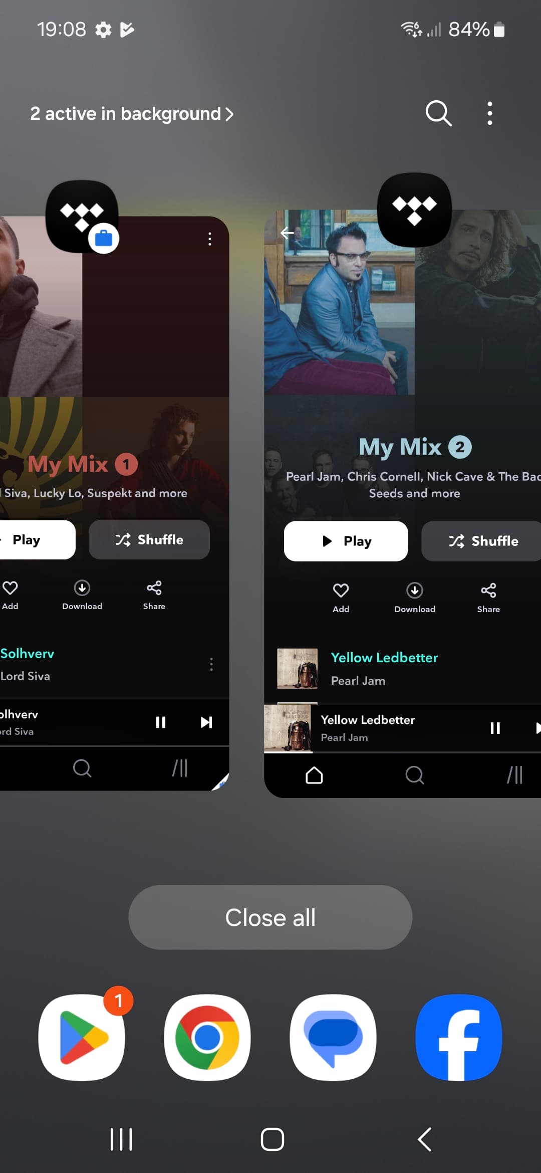

Add ima
ges
On tidal you can log on at the same time, even with the same account on a Android device setup as work profile, where Tidal is installed in the personal and work profile. No problem.
