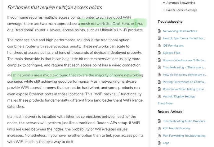

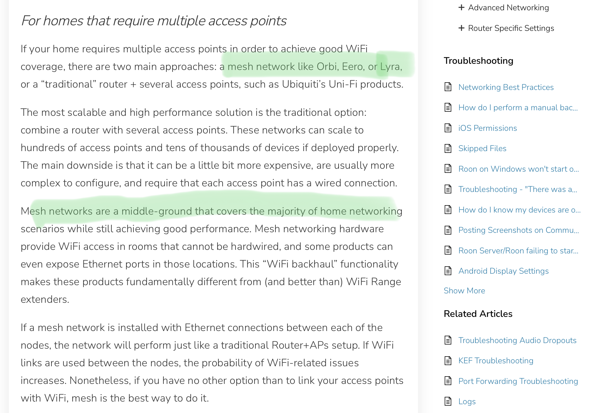

The link I posted explains a bit and names some brands. It’s a distributed Wi-Fi system that typically uses different transmission bands for connection back to the router (the „backhaul“) to distribute load and can cover a larger area.
A web search will find lots of information

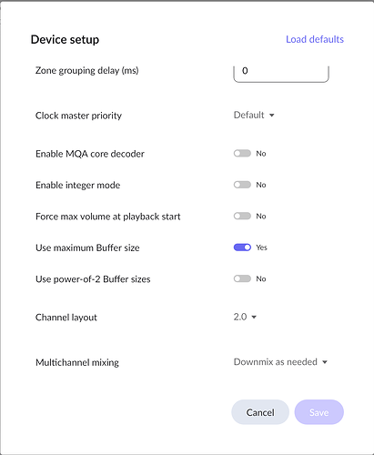

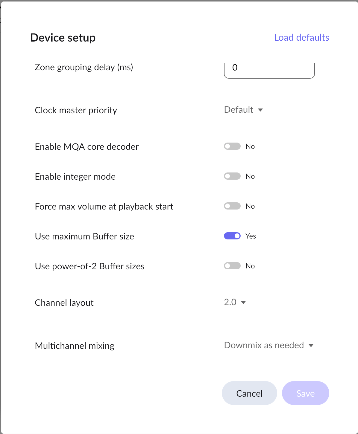

Make sure you have maximum buffer checked for you DAC.

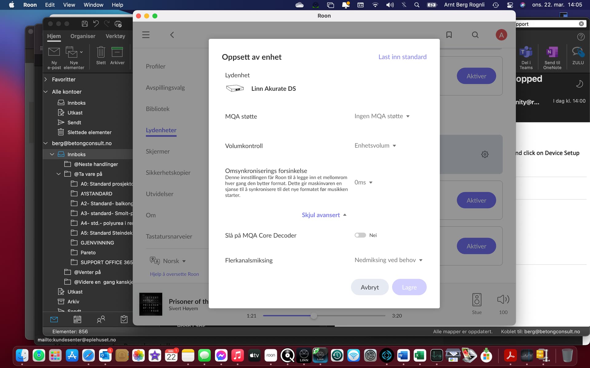

HI. Where can I find this layout??
Go to > Setting then > Audio then Click on Gear icon of your DAC, and click on Device Setup then finally click on Show Advanced.
I have done that, but I only get this image
When you “Show advanced”, the screen should then be a scrollable window - scroll it upwards to reveal more of the advanced settings…
I am sorry but that is impossible on my unit?

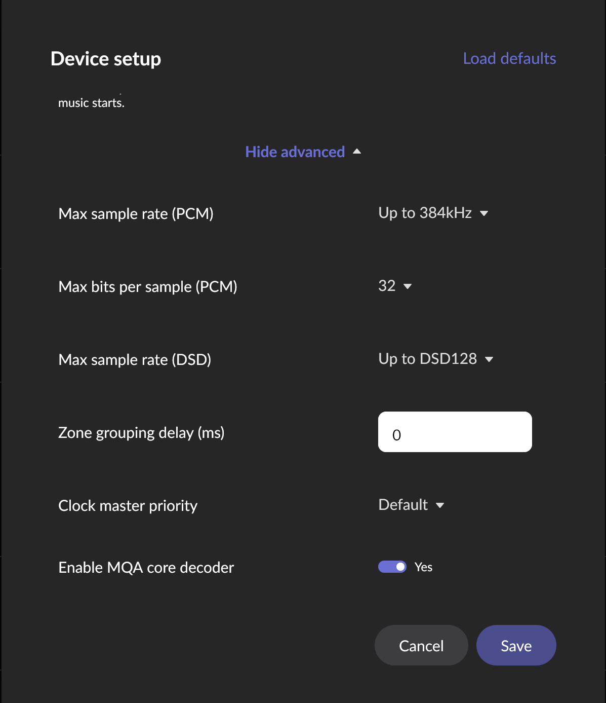

Buffer size and some other settings under the advanced tab seem device dependent.
I have buffer size on one DAC but not another using the same Roon Remote.
But there should be more settings in advanced anyway (unless they are all not there for the Akurate, which seems unlikely) and it should be possible to scroll down.
@Arnt_Berg_Rognli There is never a visible scrollbar in this window but did you try a two-finger scroll on the trackpad for instance?
I have tried several times, but there is no such option for my Linn Akurate.
On my system I sometimes have to click on Show advanced twice before it allows me to scroll down to those options. I think it’s a Roon bug.
