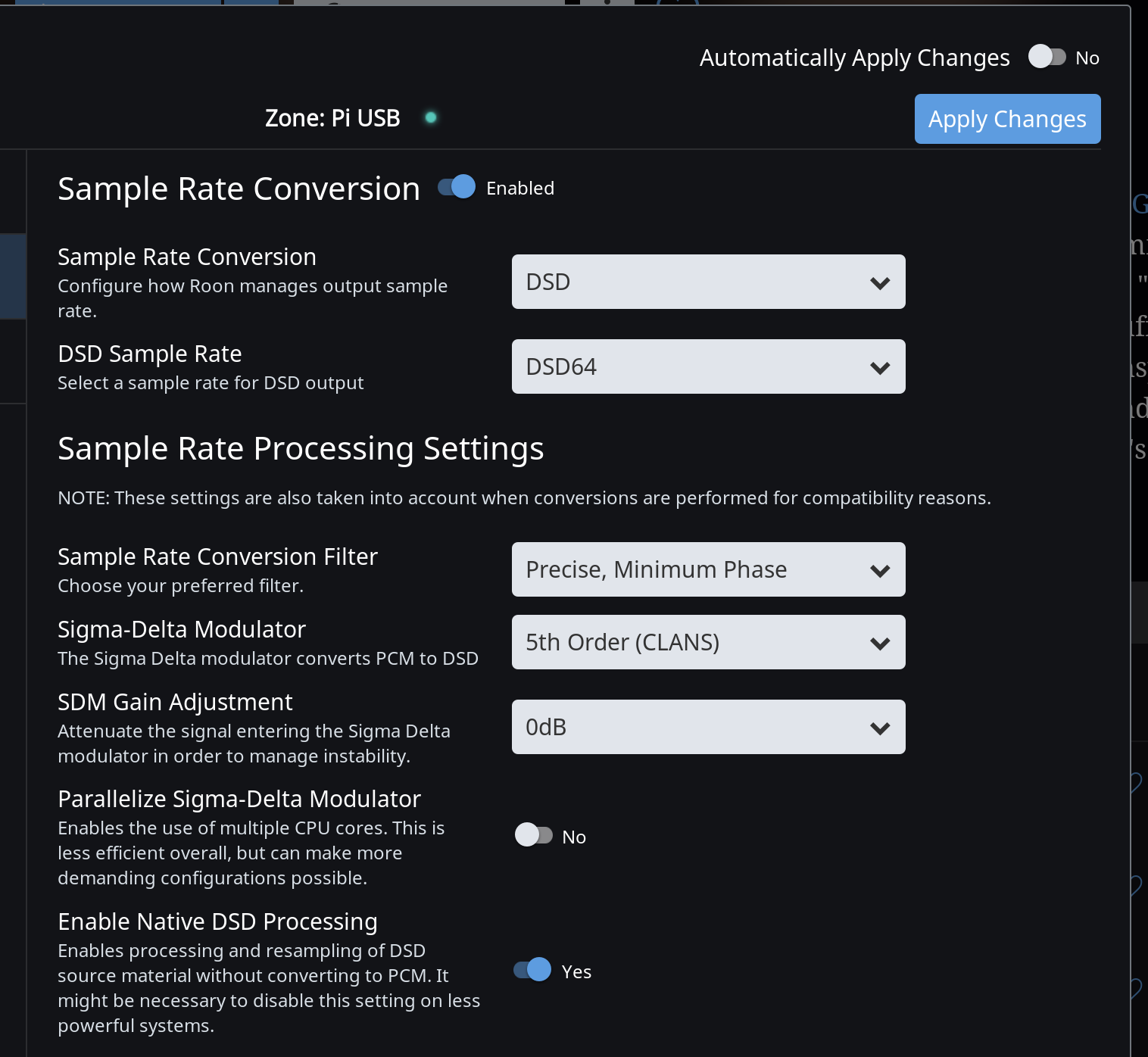

Configuration of device is:

Now finally if I switch on Native DSD Processing,
the audio comes out of the left speaker. The path is now:
