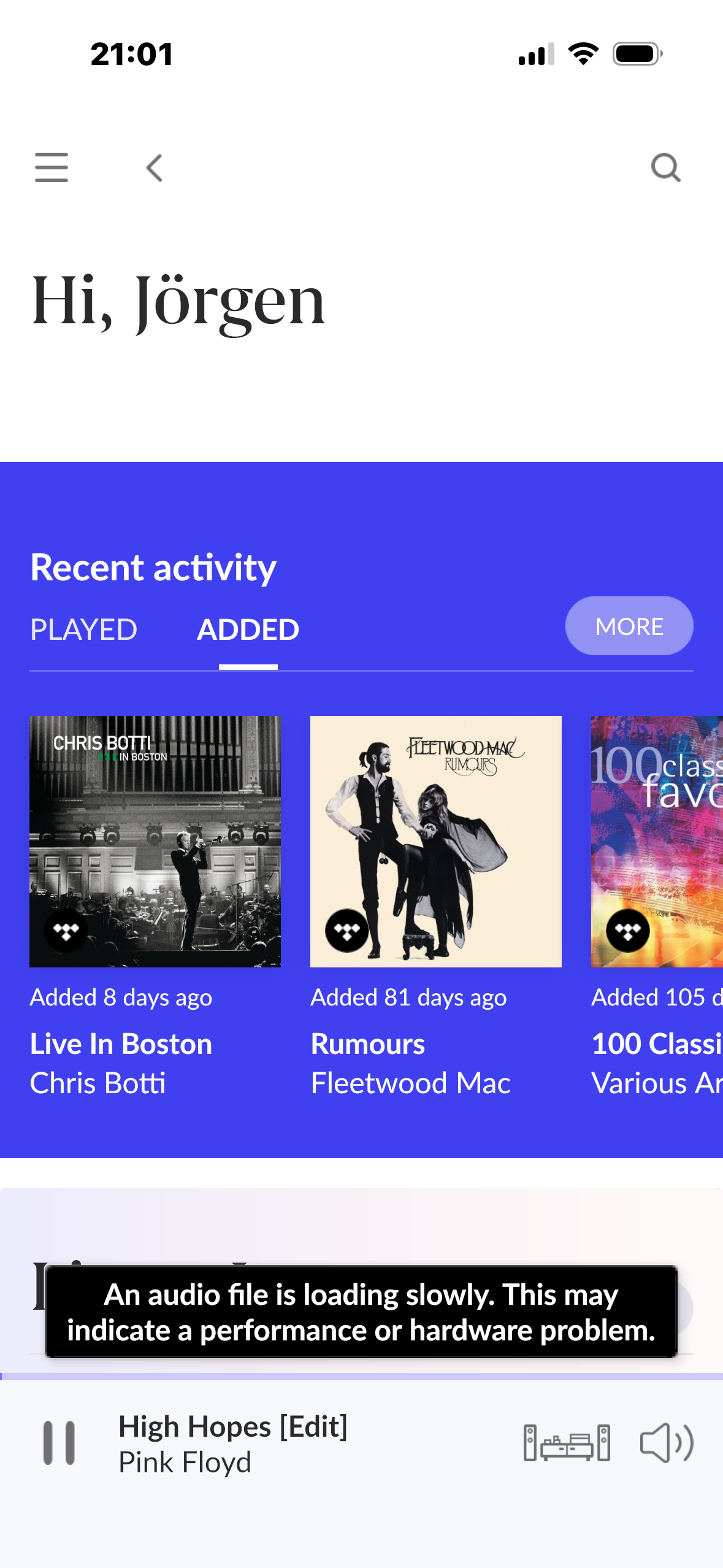

Listening to music is fine as long as i don´t touch roon app after starting music. If I change anything, i.e go to home, search for music, visit my library etc the music stops/lags and comes back after a some time (10-15sek). Some times the music stops and a message appears ”An audio file is loading slowly. This may indicate a performance or hardware problem.” My network is connected to fibre and I have no performance issues with any other streaming services. Speed is typically about 500Mbps and my Nucleus is connected to the router by cable.

I lovered the sample rate to 192kHz and increased the buffersize to 100ms, and that worked fine. But today i was listening and without doing anything on the Roon app (Roon app in background, I was reading the news) the music suddenly stopped (time 19:09) and was loading slow. And at 21:51 I started the Roon app again but it was really slow to start up.(All timestamps UTC +2, CEST)
