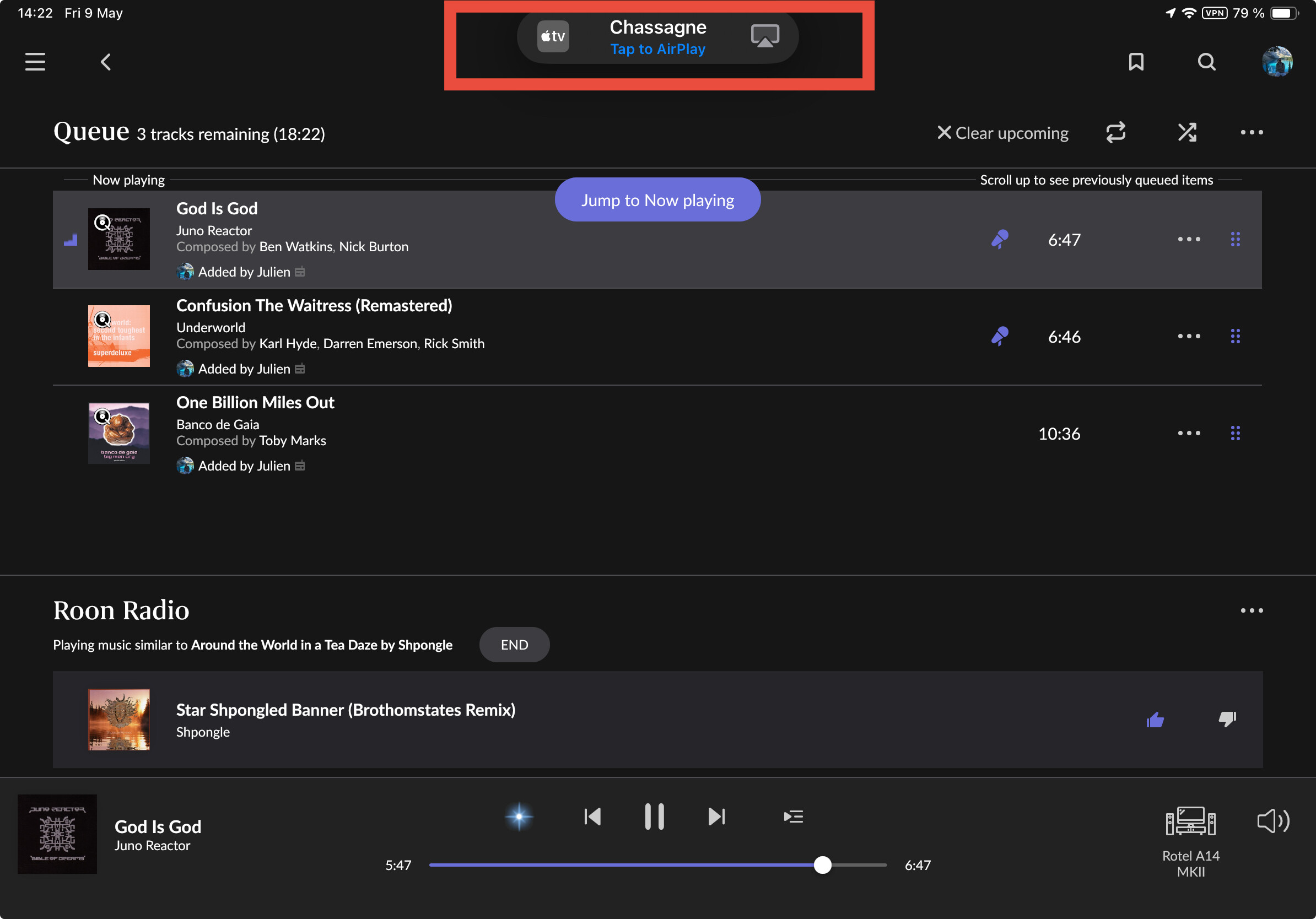

I use an iPad Pro, an Apple TV and a Mac mini. Maci mini has Roon. When I screen mirror from iPad to Apple TV, the music pauses in Roon.
Everytime I go to the Roon app, the pop up appears at the top of the screen:

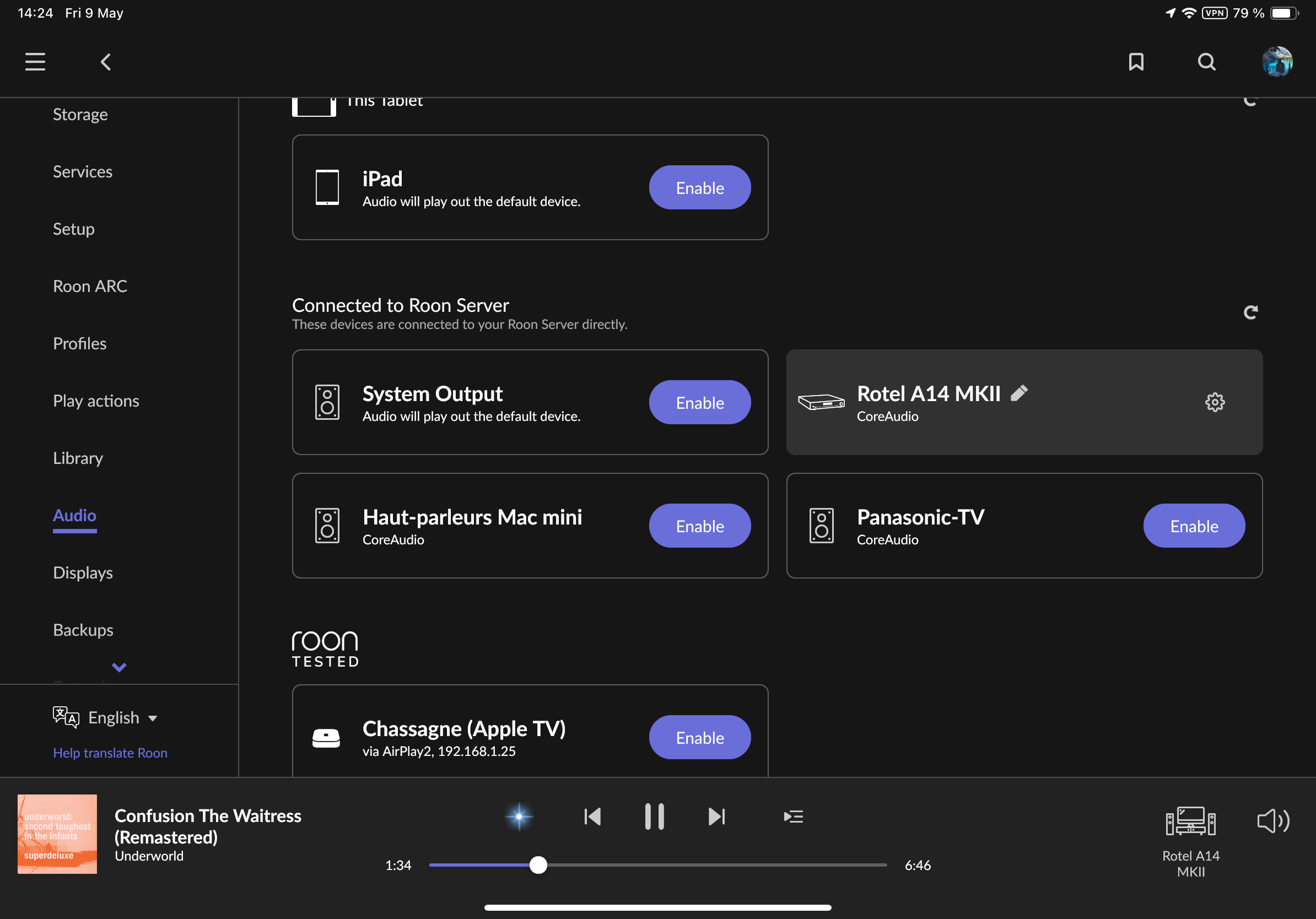

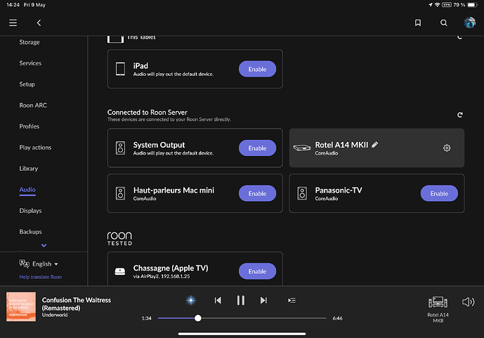

And Apple TV is not enabled:

Thanks for the fresh timestamp! From logs, we can see playback was paused automatically due to a system-level change: a CoreAudio device (your Panasonic TV) was removed and re-added. This triggered a reconfiguration of the Mac’s CoreAudio stack, which caused a temporary disruption to USB audio playback to your Rotel A14 MKII, ultimately leading Roon to suspend the audio stream.
Do you have exclusive mode enabled for the zone when this issue occurs? When you enable Exclusive Mode for an endpoint in Roon (like your Rotel A14 MKII), Roon takes full control of the audio device and bypasses macOS’s system mixer and audio event handling. This isolates the audio stream from most system-level disruptions — like a TV connecting/disconnecting.
