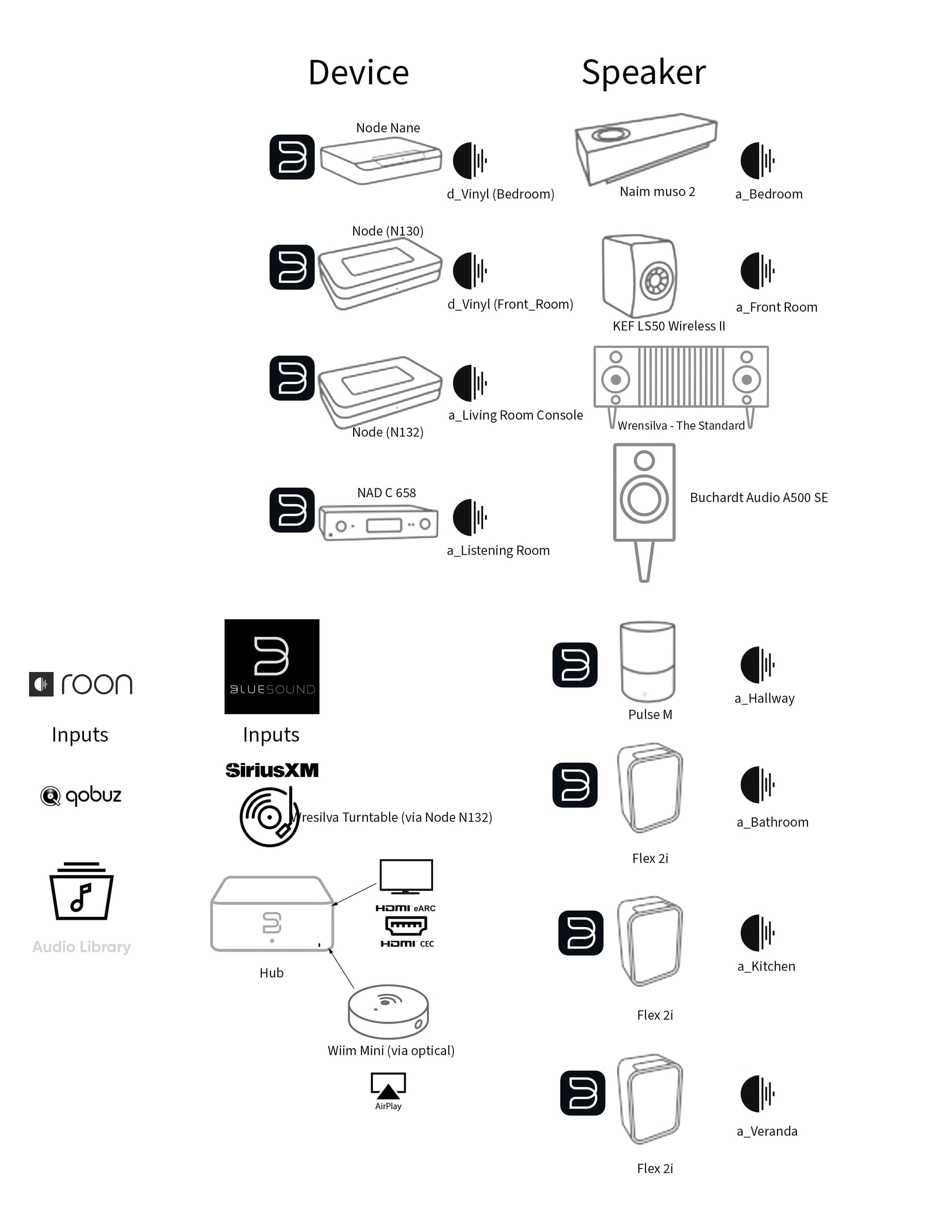

Here’s how I’ve combined Roon, Bluesound, and Home Assistant to cover all my listening needs:
  • Endpoints: Everything is Roon Ready except my Buchardt A500 SE and Wrensilva console, which I’ve made Roon Ready using a NAD C658 and Node N132.
  • Inputs: SiriusXM (via BluOS), Wrensilva turntable (via Node N132), Wiim Mini for stable AirPlay (into the Hub), and TV audio (via HDMI ARC into the Hub).
  • Grouping: For whole-house playback, I stream to the Node N132 in Roon and then group speakers in the Bluesound app—much more stable than grouping inside Roon or AirPlay.
  • Control: All devices are integrated into Home Assistant, with Symfonisk Gen 2 remotes in each room for volume, and a dedicated button on the Wrensilva that instantly groups every Bluesound endpoint.
This way I get the best of Roon (library, metadata, DSP), the best of Bluesound (inputs + grouping), and seamless whole-home control via Home Assistant. The diagram shows how it all fits together.

As far as grouping. The three Flex2i’s are on wi-fi, the rest are etherner. Roon can get kinda wonky when playing to all 8 zones whereas Bluesound is rock solid.
