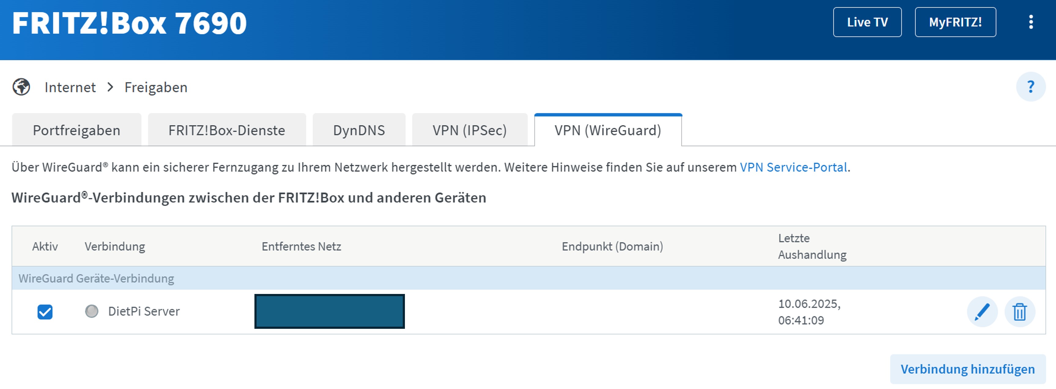

As I am using WireGuard connections between the FRITZ!Box and other devices the setup it quit easy:
Works just fine - never had problems.

Using a Wireguard service on the router is essentially the same as running a Tailscale subnet-router. Wireguard and Tailscale, along with other similar systems, provide the only available solution to providing ARC connectivity to a BIOS Boot RoonOs Roon Server with an internet connection provisioned using CG-NAT.
Although I have no need for it for ARC (I have a perfectly working port forwarding solution), I have used Wireguard on my router to give me secure remote access to my home network. It is both easy and effective.
I have used Wireguard on an ASUS router and, more latterly, an Opnsense router. On Opnsense, I could also have used Tailscale. Both are available. Both solve the issue. I just used Wireguard because I know it works.
The only unfortunate thing about using Wireguard instead of Tailscale is that is is not supported by Roon whereas Tailscale is - at least when installed on the Roon Server machine itself.
