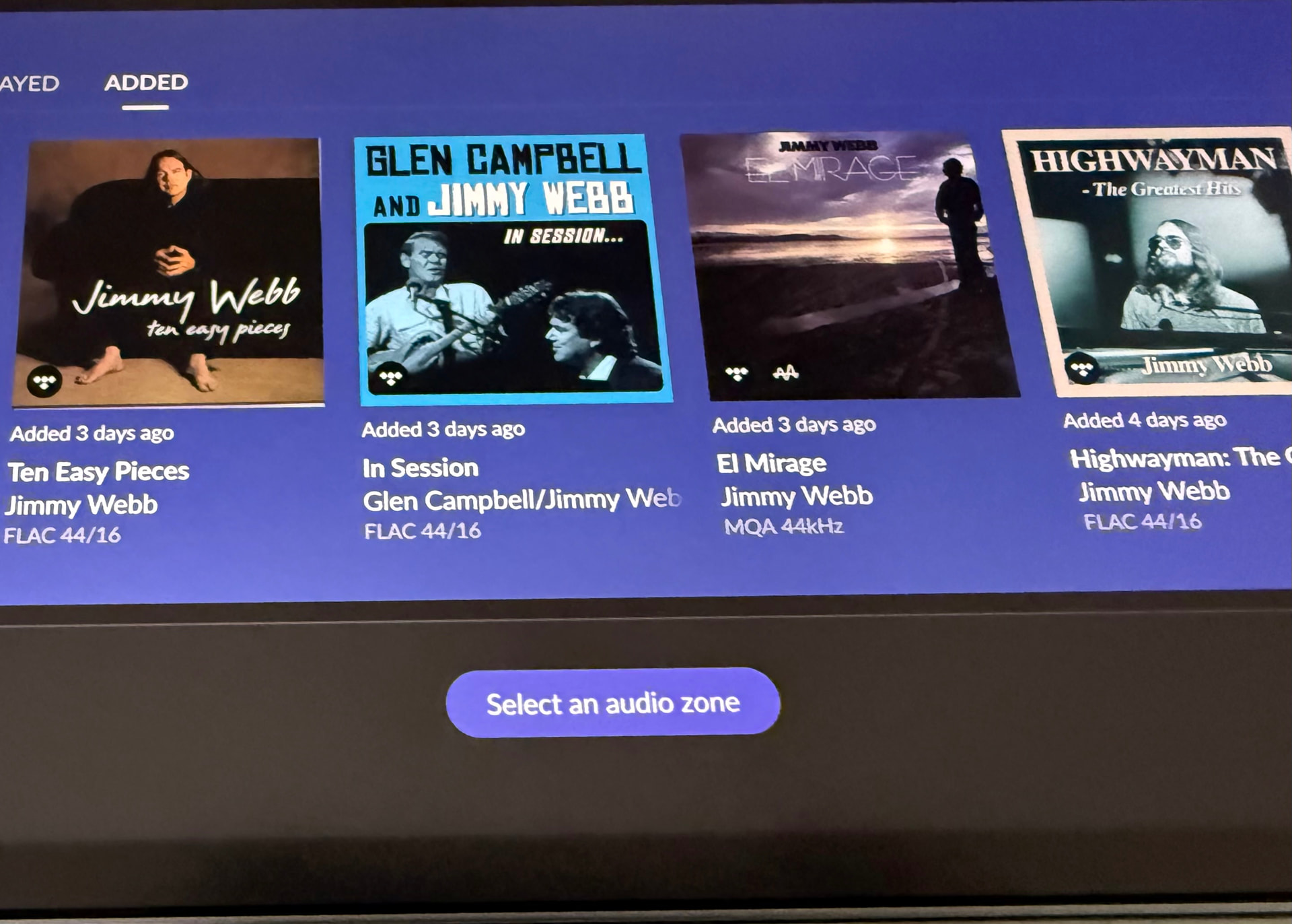

Another issue is I cannot add Tidal albums to the library using the iOS or iPadOS Roon App. It looks like it’s added to the library for at first, but reverts back to unchecked after a while. I have to add the albums using the iOS Tidal App.

Regarding the issue with adding Tidal albums from your iOS device: this is actually a direct symptom of the server struggling with its memory limits. When the Nucleus+ is bogged down or silently freezing in the background, it cannot properly save the “add to library” command to your database or sync it with the Roon cloud, which is why the app eventually reverts the checkmark.

  1. Still cannot add Tidal albums using the Roon App. I tried to add album from New Release For You. It showed the album was added to my Roon library, but disappeared after a few seconds. I had to add the title using the Tidal App.

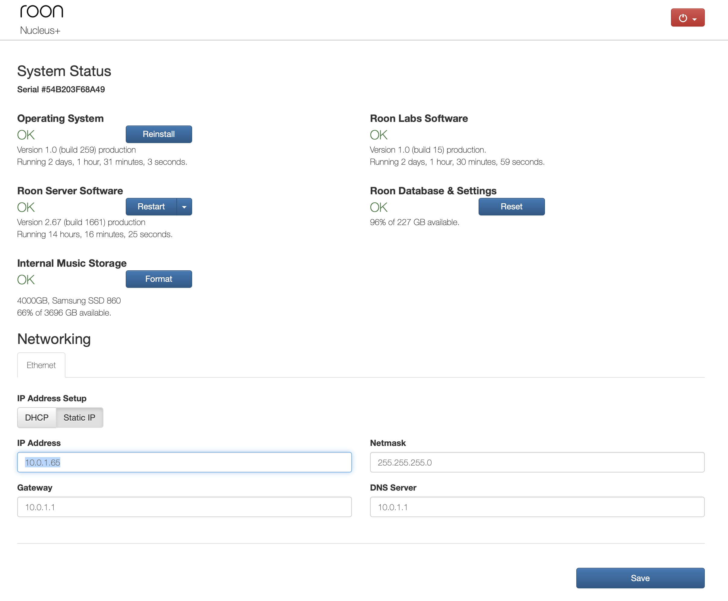

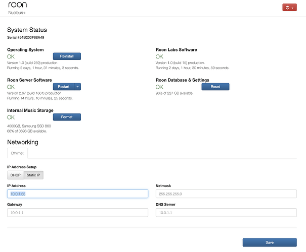

I’d also consider setting a static IP for the Nucleus via the webUI as well, if not already.
Can you confirm the amount of RAM on your Nucleus+?

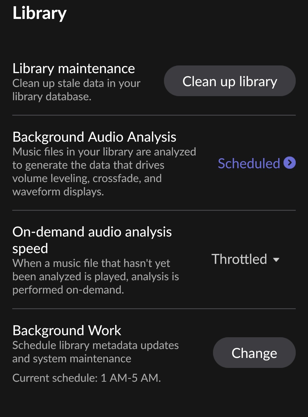

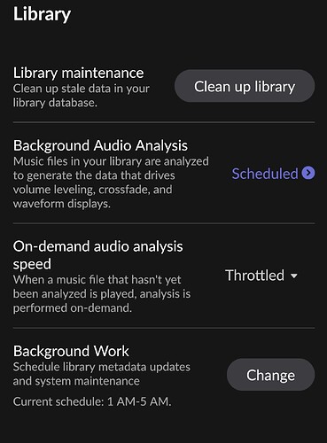

Stop the background metadata churn while you’re actively listening:
  • In Roon Settings → Library, set "Background Audio Analysis" to Off (or Low) while actively using Roon.
  • Perform a hard reboot as mentioned above.

Per your advise I did a full power reboot, set static IP, and set “Background Audio Analysis” to Throttled (looks like the number of Cores option is gone, only Fast, Throttled and Off now). All the background tasks are scheduled when the device is not used.

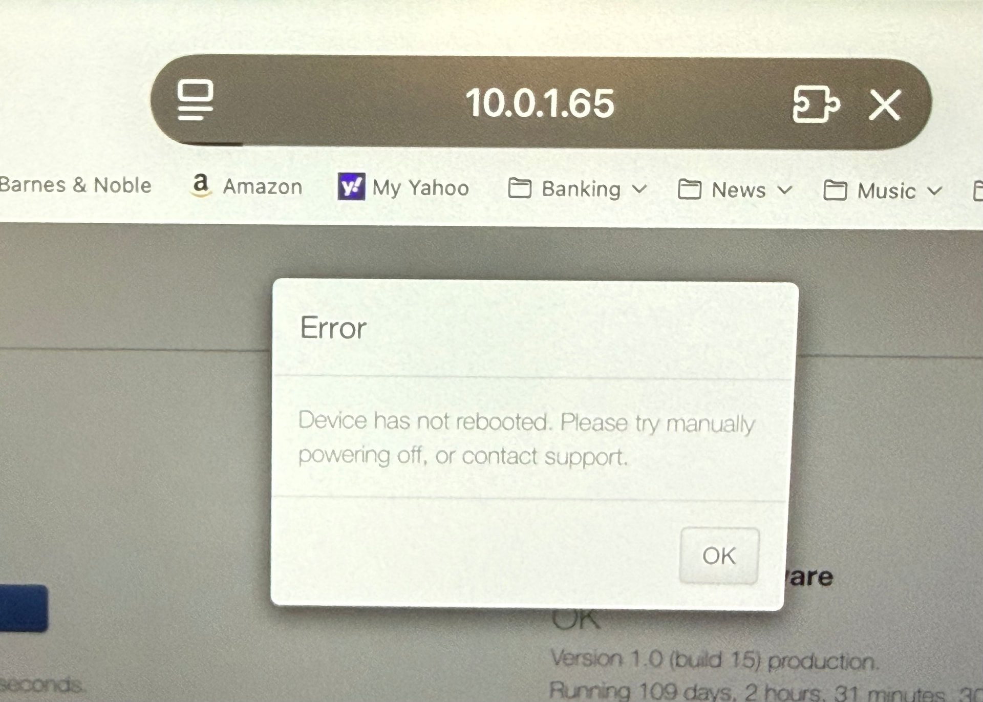

Another issue is full Power Reboot of the Nucleus Plus is always problematic and stressful. This is my 3rd Nucleus Plus board, Roon updates bricked 2 of my Nucleus Plus before. The Nucleus Plus always has problem reconnecting to the network after a power reboot. I got an error rebooting the it using the web interface, had to manually power it off and on. It took me over 30min and multiple power reboots before it’d reconnect to the network.

One other thing to throw into the mix - I notice that you have a static IP address of 10.0.1.65 set on your Nucleus.
This could be in the range of addresses that the DHCP server in your router will allocate to devices in your home network that use the DHCP service.
If so, it’s possible that there might be an address clash - another device gets allocated the same address as you’ve set on the Nucleus.
I’m not saying that this is actually happening in your current setup, just advising you that if you use a static address on the network, make sure that it does not lie within the address range used by the DHCP server - that’s best practice for using static addresses on devices.
The alternative approach would be to use DHCP on your Nucleus and reserve its address in your router so that it is always allocated the same address.

I’ve been using DHCP when the crashes happened. Per @benjamin’s suggestion above I changed to Static IP. It didn’t make a difference, so I doubt that’s the root cause of the problem. I don’t believe there’s a conflict in the IP address, I just made the DHCP address Static.
So what’s the Best Practice for Nucleus+ Roon Core, DHCP or Static IP?
Best Regards,
David
Best practice is to use DHCP reservations rather than static IP addresses set up on devices. See:
