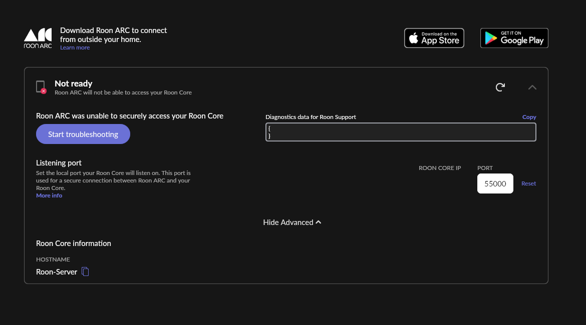

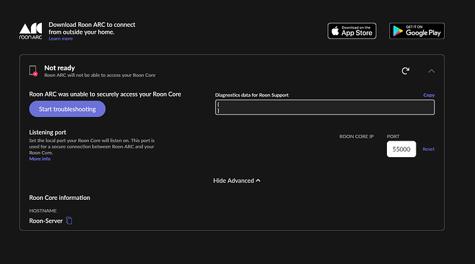

I had Roon ARC working before the crash. Now when I click on settings in Roon and then on arc I get this screen telling me to start trouble shooting. However when I go to my iPhone ARC is working. Do I need to fix this?

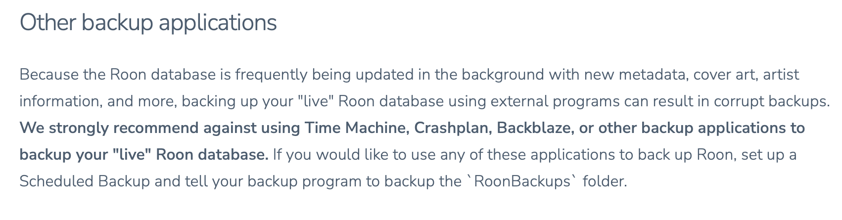

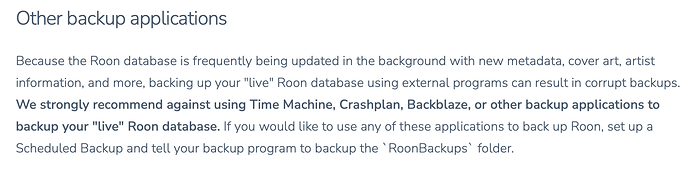

First of all, backing up the Roon database directly with Time Machine is not recommended because it will take backups while Roon updates its database, simply because TM has no idea when this happens. Therefore, it is likely to create inconsistent backup states that Roon may not be able to load.
You should back Roon with its built-in backup tool. Then you can back up this backup with TM. See the instructions here:
I suppose you did not do this? If you didn’t, and all you have is a straight TM backup, then you can only hope and pray that this works. The Roon database of the installed Roon app is here, and this is where you will find the TM backup:
/Users/Your_Mac_Username/Library/Roon

The error on the Roon ARC settings page only pertains to the Core being reachable and ARC working from the cellular network. ARC always works on the home wifi where the Core is.
I would try resetting the ARC app from its settings, or uninstall/reinstall it. Maybe that helps.
The Roon ARC settings page is quite strange because it says it is not working but the diagnostics data box is empty. Normally there should be an error message there if it is not working. The “Roon Core IP” is also empty and it should show the IP address of your Core. Did you try clicking “Reset” on that page?
And when it worked previously, did you have to do any setup work or did it work automatically?
