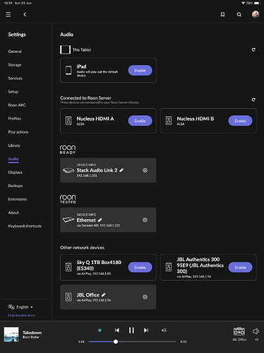

Yes i have followed your instructions , rebooted Roon and nade sure the software and the app is up to date. They both say they are.
Still the same. At the bottom of your screen you have Roon ready. My screen is the same as yours just without the Roon ready at the bottom

I do have two JBL 300 on the audio page.
I doubt this is what is causing the issues but thought I would share this.
Obviously I have tried both and both offer AirPlay only

On to more important news, I wanted to share an update on the JBL Authentics 300. The Authentics 300 is certified, but the firmware with Roon Ready integration hasn’t been released yet, which is why it’s not displaying as a Roon Ready device on the audio page.
The Authentics 500 I’m using is a test unit running beta firmware that allows RAAT streaming. I apologize for the misunderstanding and for any frustration or inconvenience it has caused you, @Womaz and @Stephen_Blatherwick.
I’ve been told that the firmware update is on the way, but I don’t have a specific release date. Thank you, gents, for your patience during the wait. If I hear anything more I’ll share the details with you here.

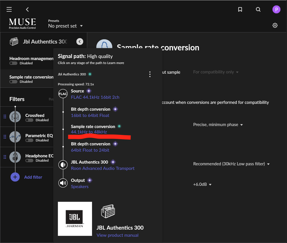

I recently bought an authentics 300, updated the latest firmware and connected to roon, but during playback I see that the audio path is modified, obviously I do not have any filters active
Add images
It’s quite possible that the device always uses a 48k sample rate. That’s not uncommon.
The difference with roon is that it tells you!
Hope another user can confirm.
Pretty much all my JBL only support 48/24 anything else is downsampled. Hires is pointless on devices like this really as your not going to pick up the differences.
