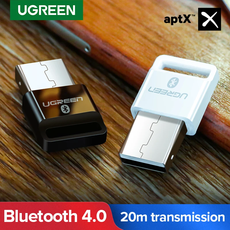

I’ve got good experience with products from Ugreen (they make quality stuff), so maybe this will also work: https://nl.aliexpress.com/item/32982179649.html

thanks, but looks like ugreen is not supported by linux :frowning:

The other one I don’t know but they probably all use the same USB driver in Linux and Mac kernels. Only way to find out is to try one. The Ugreen will probably also work out of the box.

My experience with aliexpress is that “goedkoop is duurkoop” (Dutch for: buy cheap and waste your money). I just buy from respected brands, but sometimes it’s trash… sad that so much trash is produced in the world. I can only say the Reiyin works, but if would buy one now I would try the Ugreen. Can’t help you more that this.
