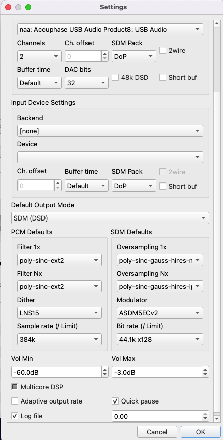

Roon is displaying something non-sensical here in first place. LNS15, PCM and DSD128 in the same thing…
When testing with RPi4, remember to set “SDM Pack” to “None”.
I did test it setting to None in here but no sounds @jussi_laako
But does the playback start in SDM mode? if it does, then native DSD got detected. If the output rate is multiple of 44.1k then you should also get sound. If output rate is multiple of 48k, then it would be normal to not get sound.
Your screenshot doesn’t capture the checkboxes below Multicore DSP.
This at bottom
Tick adaptive output rate and try again
And SDM pack = none , as Jussi suggested
I ticked adaptive gray and full, turns to PCM and low volume. And when I try to play with DoP same as ifi Streamer no sound. The NAA of HQPlayer doesn’t work for Mac with Accuphase DAC-60.
