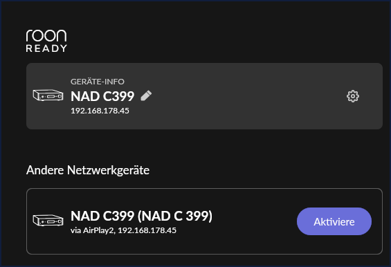

Set up the C399 tonight and updated all firmware. In Roon Audio settings, under Roon Ready, the C399 shows up as “uncertified” and when I click on enable, I get the “unfortunately this manufacture has not yet certified…” message. Yet, on NAD and Roon’s website, it shows that it is. I tried an MDC hard reset and reboot of Roon server MacStudio. Nothing. I can connect through the AirPlay connection but that is sub-optimal. Help!

Same problem here.
NAD C399 connected via LAN , Roon-Rock on NUC, worked until update to current BlueOS version, yesterday night. In adition all presets were lost. Dirac settings still exist.
I can connect through the AirPlay connection but this is not very reliable.
Informed my dealer waiting for an answer.
Hello @Heinz_Schweitzer,
Thank you for contacting Roon Support and for your valuable feedback. I have enabled and reviewed the diagnostic data for your account, and it appears that the device ID has changed since the last update, as we can see that the previous model name does not contain spaces, and now this device, due to additional space in name is not recognized by Roon as Roon Ready.

This was fast :grinning_face: Thank you.
