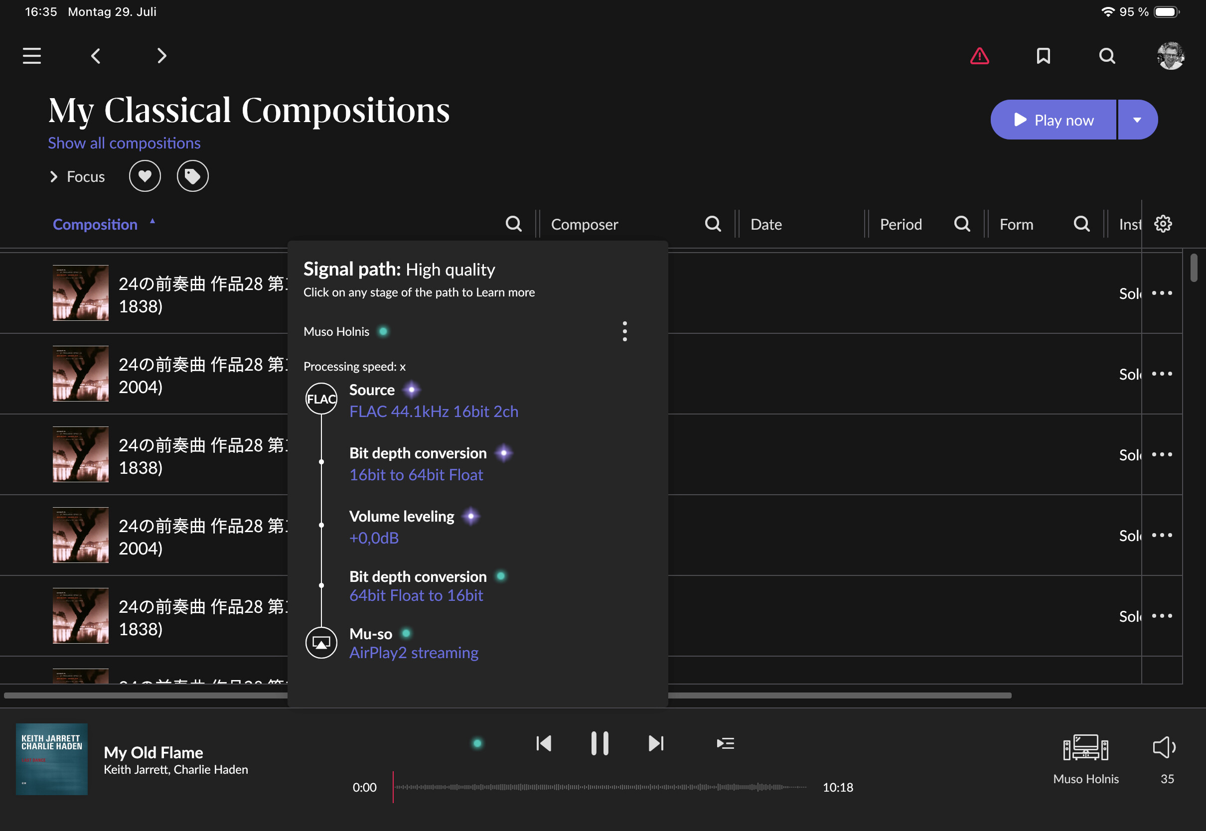

Roon see s the Muso, but Music doesńt start to play.

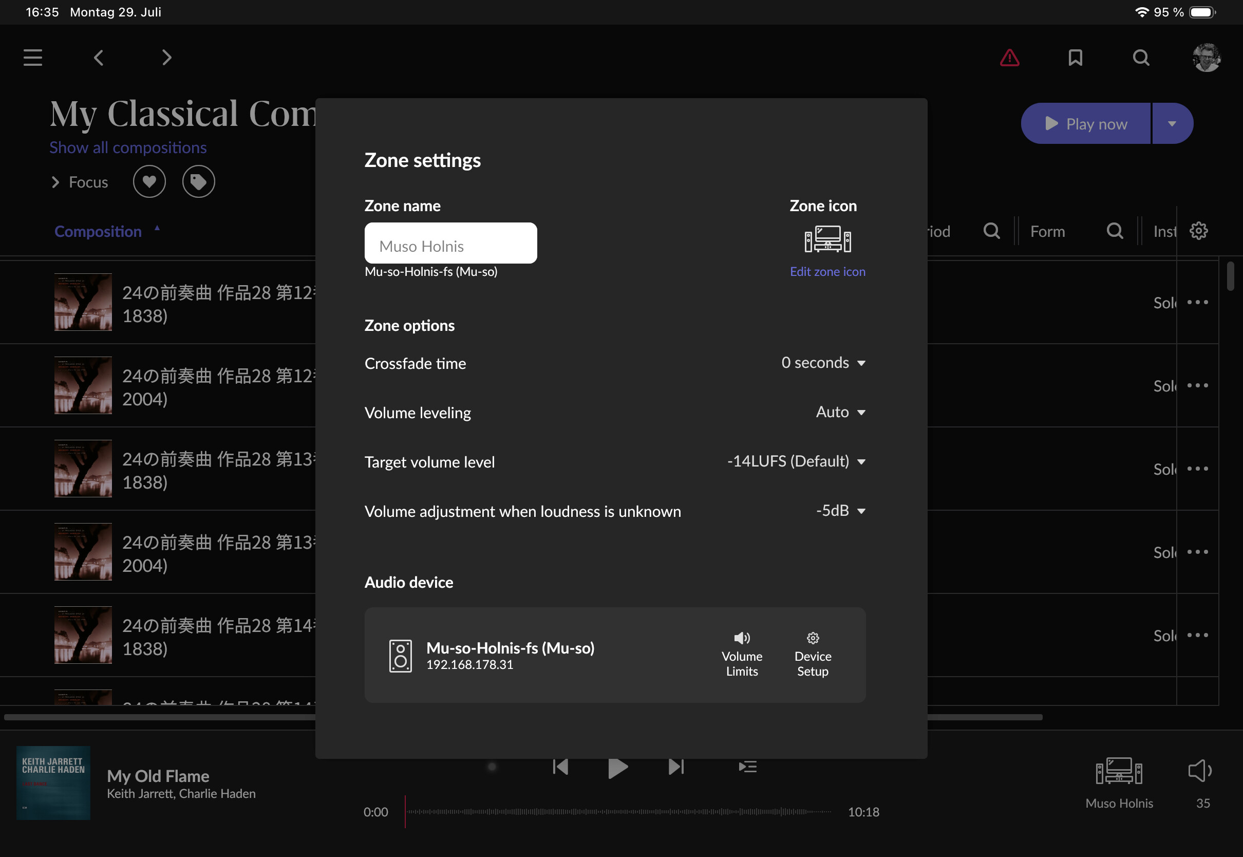

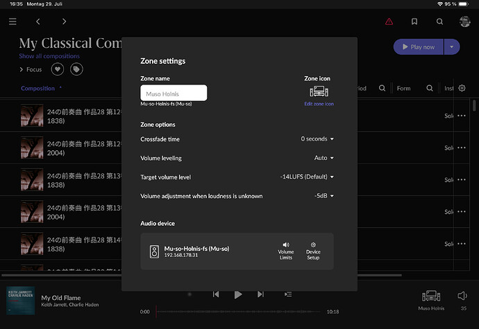

Did you enable compatibility mode in Roon for the Mu-So and add it to the Apple Home app? (You’d need an Apple device for the latter, unfortunately, but this is just a workaround until it is really fixed)
sorry, but where in roon setting can I find „ compatibility mode“?
OK, it works, thanks
