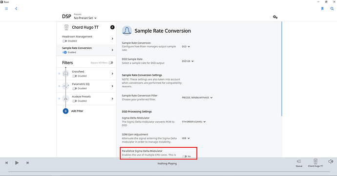

@DDPS is correct here, for native DSD, you would need the required drivers and only a handful of devices support native DSD on Linux. When you are trying to play the DoP content, what processing speed does the Signal Path show, is it under 1.2x? If you try to play DSD256 content with no conversion needed, does that work as expected? There is also an option called Parallelize Sigma-Delta modulation in MUSE (DSP) you can try to enable which may help:
