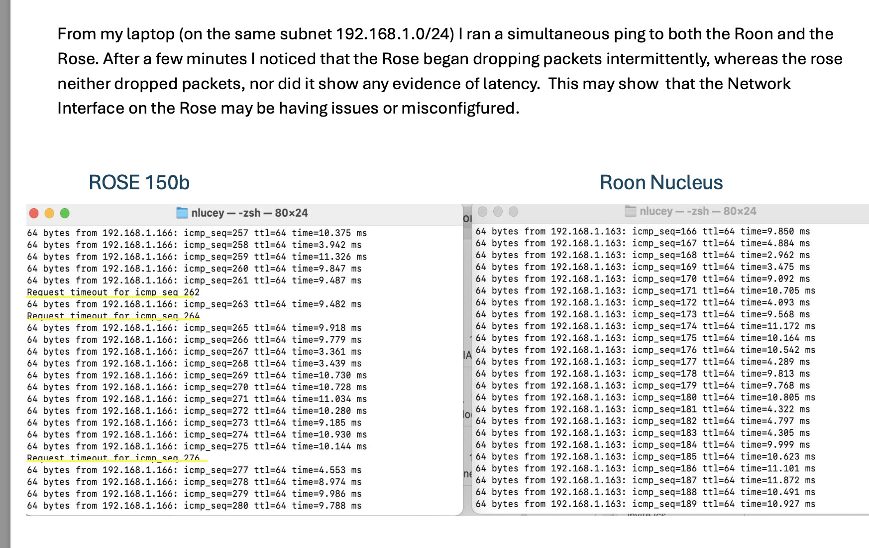

I ran some ping tests as well and saw a few drops from the Rose:
I played for a bit using the verizon router as the switch and the results were ok for that period.
More interestingly I am testing again using my switch - but I am streaming the music directly from Tidal running on the Rose, i have the roon unplugged. I am not seeing the same drops in this scenario either.

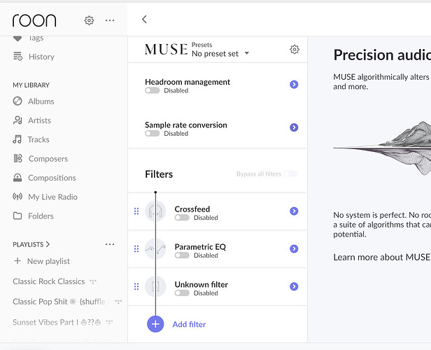

  • Temporarily disable any active DSP or upsampling in Roon. This can help determine if the processing demands are overwhelming the system.

My suspicion is that the Rose has something wrong with its network card or firmware.
The equipment and internet speed I have should easily support this setup.
1 gig internet and 8 port 1 gig switch. And this is the only traffic that its passing.
The Rose is designed to stream music and should not be overloaded by common tidal or Roon streaming- since thats exactly what its designed to do…
Do your findings support that their could be a hardware (or firmware) issue with the Rose?
FYI - I’d been using the Roon app on my iPhone so I never even accessed Muse to set up DSP. For all intents I believe its just at the default

To clarify - with or without the EE the rose was dropping. At one point the Rose was connected directly to my internet router and i was streaming Tidal from the Rose built in dac (Roon completely disconnected). I STILL had drops.
Like i said, the only constants were the following:
No matter what setup I use, if I set the Rose to use a USB input, and run a USB cable between my Roon and my Rose, there’s NEVER an issue.
No matter what setup I use, if I set the Rose to use ethernet input, theres ALWAYS an issue.
Since the factory reset a few hours ago, with the EE in place, i am not getting drops.
Thats where it currently stands.
Rose is pointing at a network issue (altho they havent done any troubleshooting and I have spent hours testing)
Any network device or streaming server i use with the Rose causes drops when the issue is occurring. In every scenario… except when i disable the Rose ethernet port and receive over USB.
I’m annoyed Rose would point to a network issue without performing troubleshooting. I would appreciate data points from you guys showing that the issue is isolated to the Rose
So that I cam send it to them.
