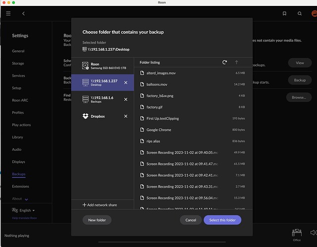

You sure you made it a windows share? it has to smb not AFP.
Screenshot 2023-11-04 at 16.38.30
Works fine for me so your missing a step somewhere.
OK, looking at the screenshot you kindly shared, I realize that I need to add myself to the users (with the + button). I think this is what I was missing. Will try it right away.

The windows bit is needed as I posted. You need to set that under SMB. It doesn’t work for Roon without that it seems.

Shorten your path to just the ip and the shared folder you don’t need the full path and try that.
Thank you all @Robem, @Simon_Arnold3, @ged_hickman1 for your advice! After using the “ipaddres” (thank you @Simon_Arnold3 for the very helpful screen capture), and shortening the path to only the folder (even though this is contrary to Roon’s instructions page), and some experimentation with the username it worked.
