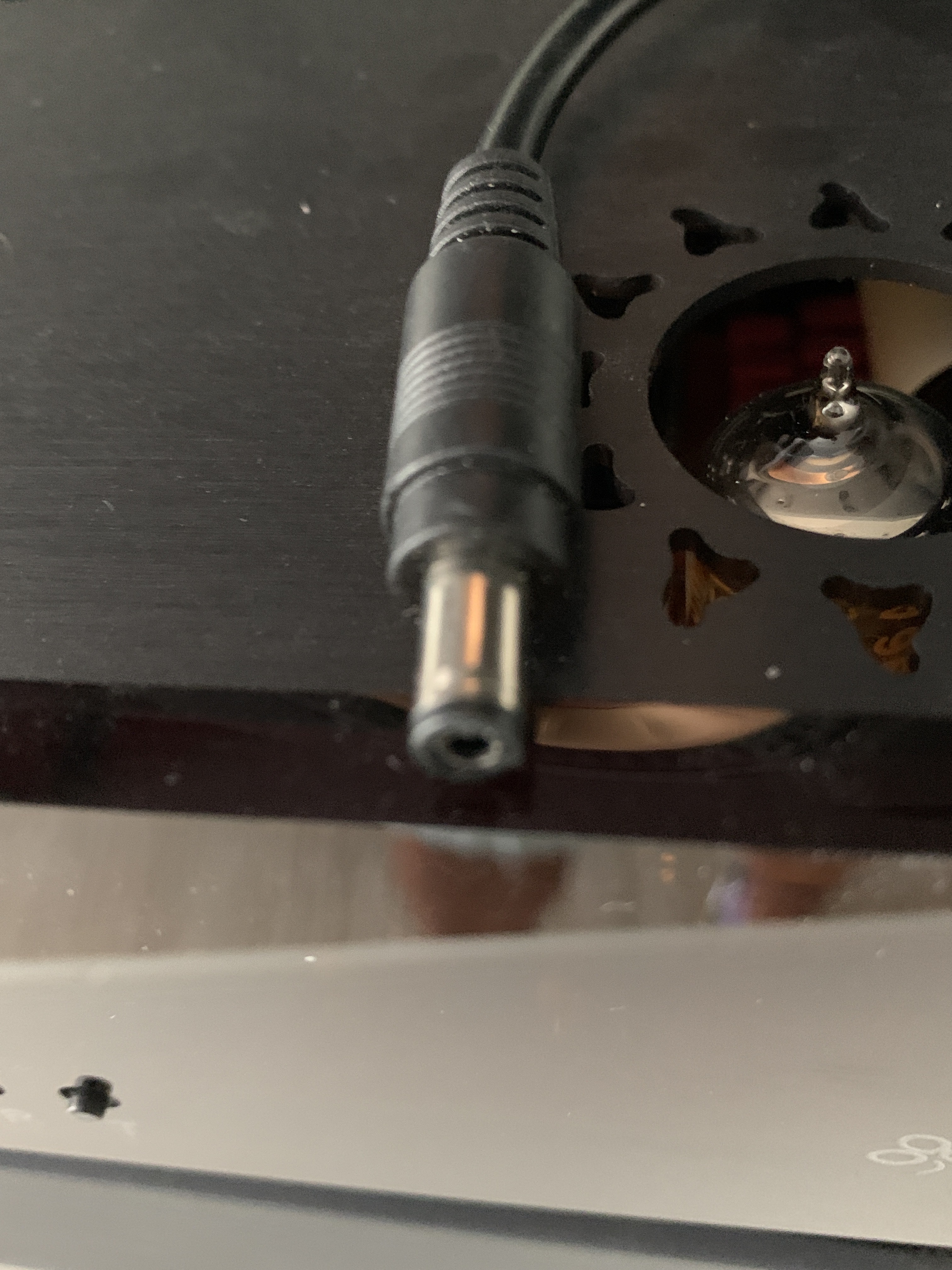

If the DC connection into the Nucleus has a small barrel adapter on the end try removing it and using just the original connection - might not be doable depending on what else you have connected into the Nucleus.

nope… the bit that plugs into the Nucleus - pic of that end of the cable will be helpful
Ok so it doesn’t appear to have an extension / adapter on it that mine did, that I felt was a little to larger in the inner plug for a good fit.

its attached to the power brick so you would need a new power brick with a 5.5 x 2.5mm DC connection @ 19V and 3.6A or better IIRC - but I would wait for @support to chime in here. in case its the Nucleus deemed to be the issue.
